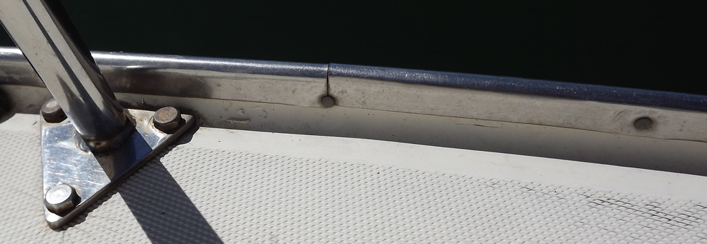

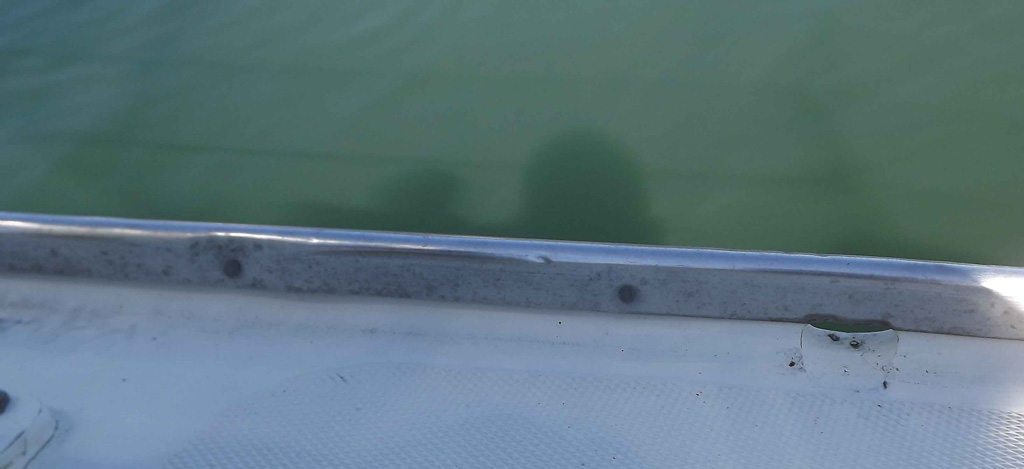

Postby Topi » Fri Apr 18, 2014 5:47 pm
So here is another question relating to the hull / deck join, or toe rail. Is the toe rail lip, in fact made up of two halves - one the hull the other the deck ?
In my case the top of the toe rail does not have that nice SS cap. There are cracks visible in the toe rail laminate/s from above where water must make some ingress over time.
One of those SS caps would be nice, but no doubt it would be hard to come by, anyone seen other things used to help seal that lip ? Aready made moulding would be nice.
Topi
Posts: 86
Joined: Sun Jan 12, 2014 6:40 am
Re: Deck Hull joint integrity ?
Postby Phillip » Fri Apr 18, 2014 8:02 pm
Louis,
You will have to fill all those cracks with resin.
But first you had better check that the join inside is in good condition.
That means it's not delaminating or leaking water. If you find either of these you will need to repair it.
Make sure there is no water in the joints before filling with resin.
You may need to wrap [with a fiberglass strip] the top of the toe rail to effect a seal.
The SS cover was hand made, I'll measure the thickness/width tomorrow for you.
Postby Topi » Tue Apr 22, 2014 5:39 pm
It is fixed with roved over bronze rod.
There is hope for me yet, that sounds like a solution. I thought those SS caps were factory made with a rolling machine.
The glassing under/inside looks fine, no signs of issues there. Perhaps the top of the timber toe rail originaly covered the GRP, but now that the previous owner removed it the problem has began to show itself. Getting some resin in there makes sense, probably just before I put the screws back in that pintch it together.
Just dont like looking at cracks, in anything :)
Topi
Posts: 86
Postby Phillip » Fri Apr 25, 2014 3:49 pm
Topi,
The SS cover strip on the Mark 1's appears to be made out of sheet Stainless Steel.
You will need SS sheet that is 0.9mm thick [a little bit thicker than 1/32". 0.11mm extra to be exact]
Or what ever close thickness they do today, but not heavier.
The lenghts cut are around 6' 0" [1850mm] long. width of a sheet? And 2" [50mm] wide.
A sheet metal shop should be able to pre-bend them for you in the U shape.
Originally these were fixed in place by roved over 5mm SS [or maybe bronze] rod, about every 2- 300mm,
but today it may be easier to fix with nuts & bolts.
Hope that answers your question.
Postby storm petrel » Fri Apr 25, 2014 5:19 pm
Or could you could look for a ready made aluminium extrusion. I am sure simple U- channel would be available.
