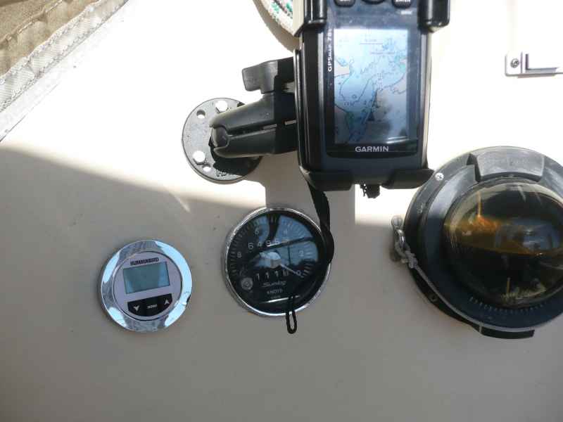

It's good to see how different people set up their boats. Having used larger screen in the past, I've gone back to a Garmin 78 with S.E Australia charts. Most power use on plotters etc relates to screen size. The 78 is mobile, floasts, and has internal battery backup. When removed, there's only the stub of the Ram base left on the boat. At night a small/dim screen doesn't diminish night vision. To reduce power use I also stick to a small digital depth sounder. The Sum log in photo doesn't work.

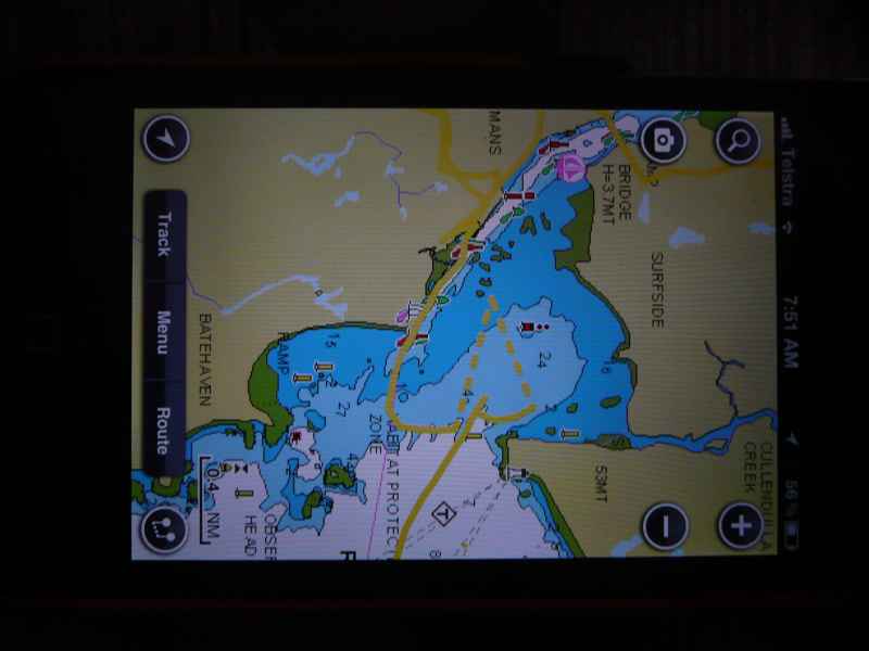

For added info/detail, Navionics for iphone & ipad is great - the same software/data as used by Raymarine & others in their chartplotters. Only a few dollars, and as its loaded onto your phone it doesn't need reception to work.

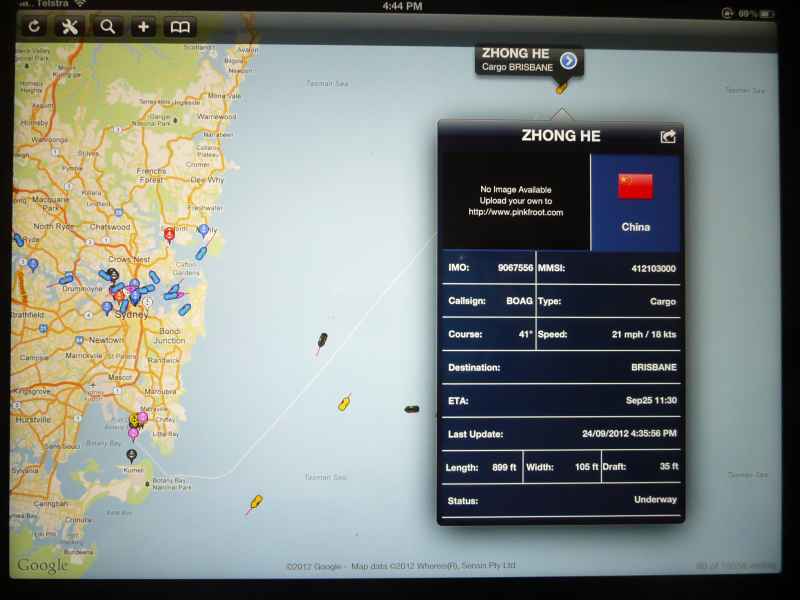

Shipfinder (AIS info) for ipad/iphone provides good reference info but it does need reception to work. On my recent trip Sydney to Batemans Bay it was also clear that moored ships outside Port Kembla did not maintain AIS transmission. Nothing beats constant surveillance when you're a small boat on a big sea!

Is that real time data you are getting on your Ipad AIS or that from the internet?
I ask this because the internet AIS can be over an hour late to prevent pirates using it!!

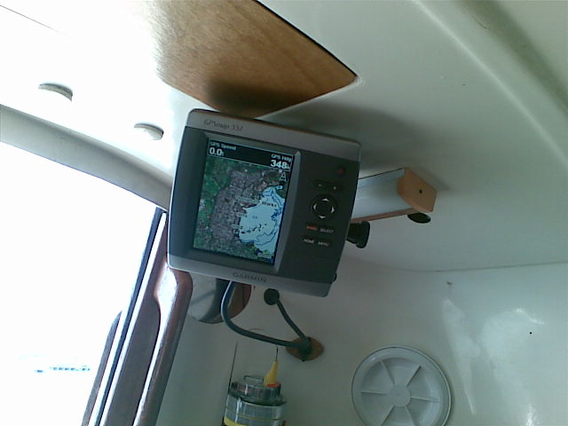

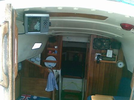

At last I have the photos,
hope this helps, the garmin is linked to the DSC radio and soon will link to a AIS receiver as well.

Thanks Dave. After trying a small lower washboard with the plotter flush mounted (great position but too vulnerable)I have decided to put it on a swing mount (Ram vertical mount) so I can swing it out of the way when it is not required. I suspect it will swing a little closer to the companionway than yours but quite similar position. The new mount is expected to arrive tomorrow. Thanks for your advice.

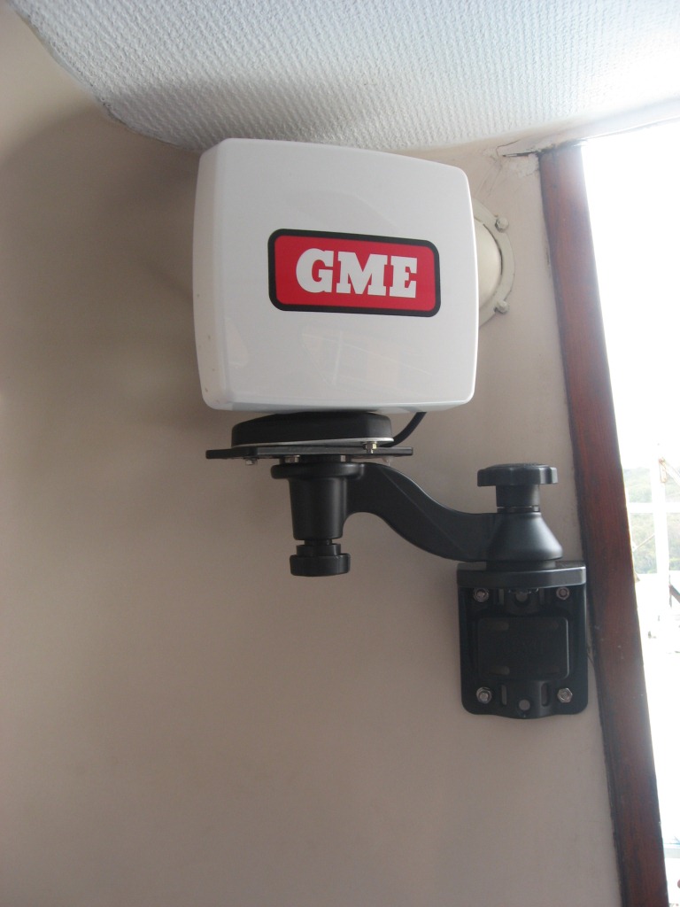

Attached is a shot of Storm Petrel's new chart plotter and its Ram mount. It swings into the companionway and out of harms way very easily.

Mark, I have just purchased a GME chartplotter myself (the price was too good to miss!), Can I have details of the ram you purchased - it looks great fitted.

Ram mounts are a bit ugly, but bloody solid and easy to adjust, swing and fix in place. Made of cast aluminium. I bought it online from Johny Appleseed GPS in Qld. It is a RAM-109V , 6inch arm vertical mount. Then the painful bit: $127 (including GST and overnight express). It arrived in a couple of days. The mounting bracket has a bunch of holes for various Plotters but they did not suit the GME. I simply fashioned a bit of aluminium plate to mount it, but there are probably other ways it could be done. You can see what I have done in the photo above. I did not get an external antenna as it seems to work fine with out one.
