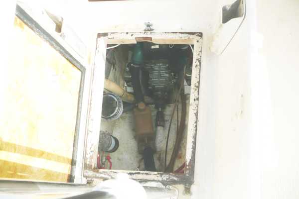

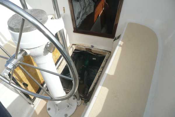

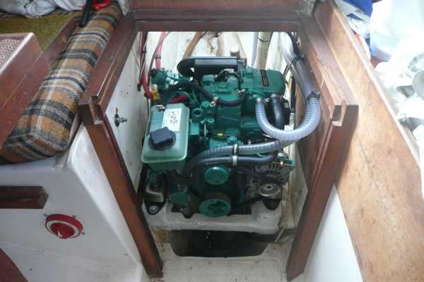

Postby Dolphin » Wed May 02, 2012 1:45 pm
G'Day Rabbit.
Access to the stern gland on most Top Hats, or any boat for that matter is often restricted.
Fortunately, the previous owner had the foresight to cut a hole in the cockpit and put a hatch that gives good access. It was actually used to install the wheel steering.
Here is the Volvo installation that replaced the D12.
Wish I had have kept that diesel.
The access is so good that on rainy days I'll take a good book down there and put my feet up. :lol:
