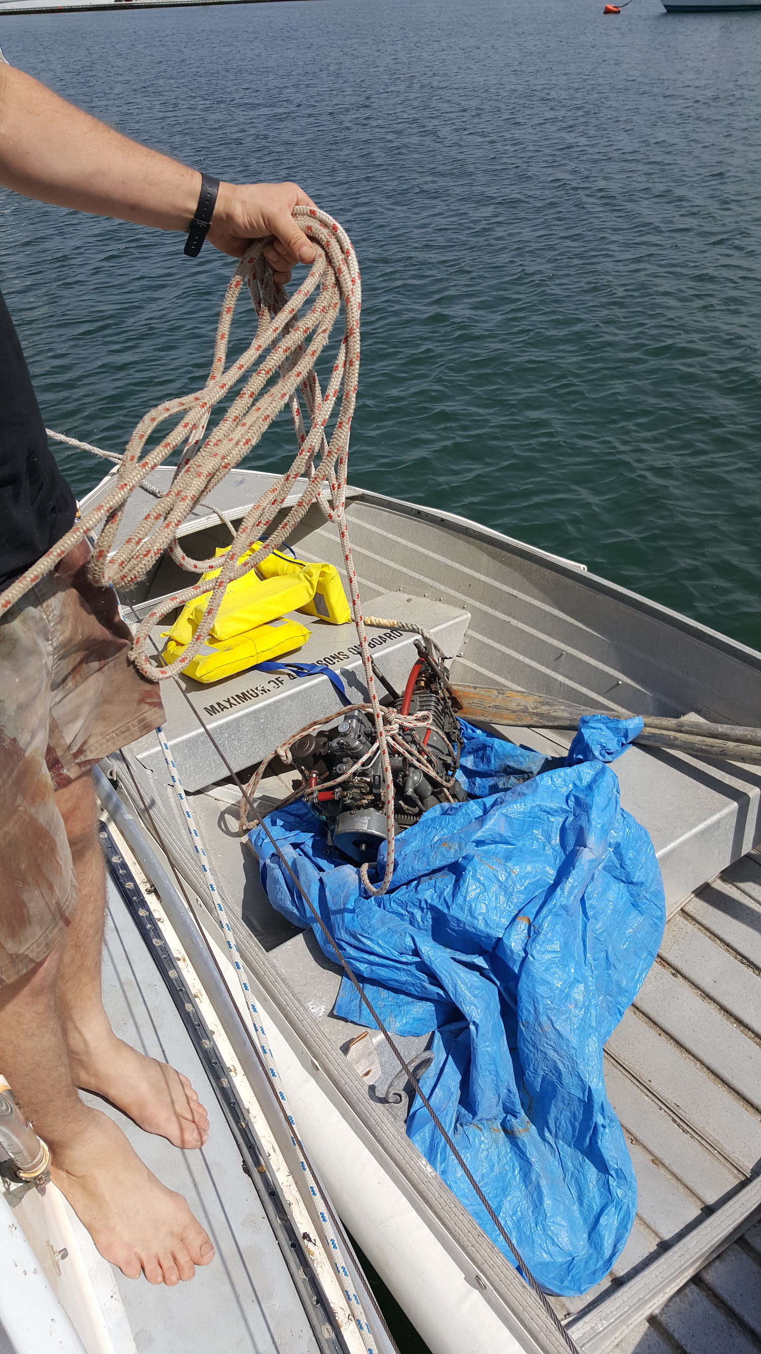

thanks for the input, here's an update on the engine saga
first of all we extracted the engine and stopped traffic with it sticking out of the boot of my brothers timeless hillbilly ford capri

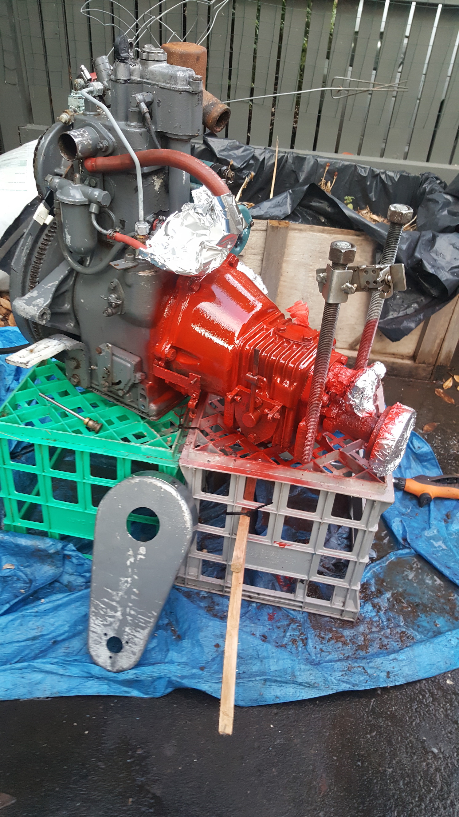

here's the engine, which has always gone like a dream and is now going to be turned into a red rocket

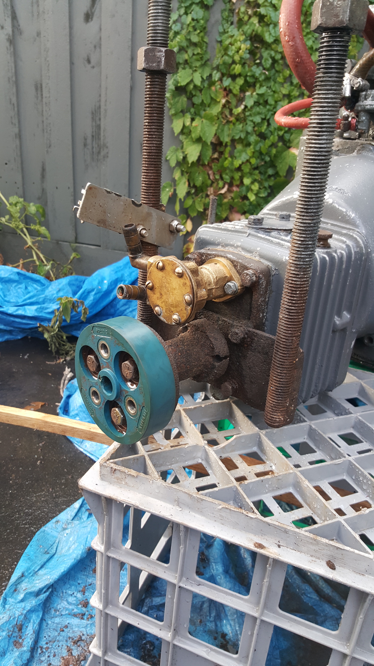

the coupling and everything looks great once it was cleaned up
Engine coupling.jpg (1.33 MiB) Viewed 13185 times
- it was suspended from the rear engine mounts by a bracket suspended over the bilge with the engine basically hanging off the 2 large threaded bolts you can see welded onto the rear of the engine
Red rocket.jpg (1.41 MiB) Viewed 13185 times

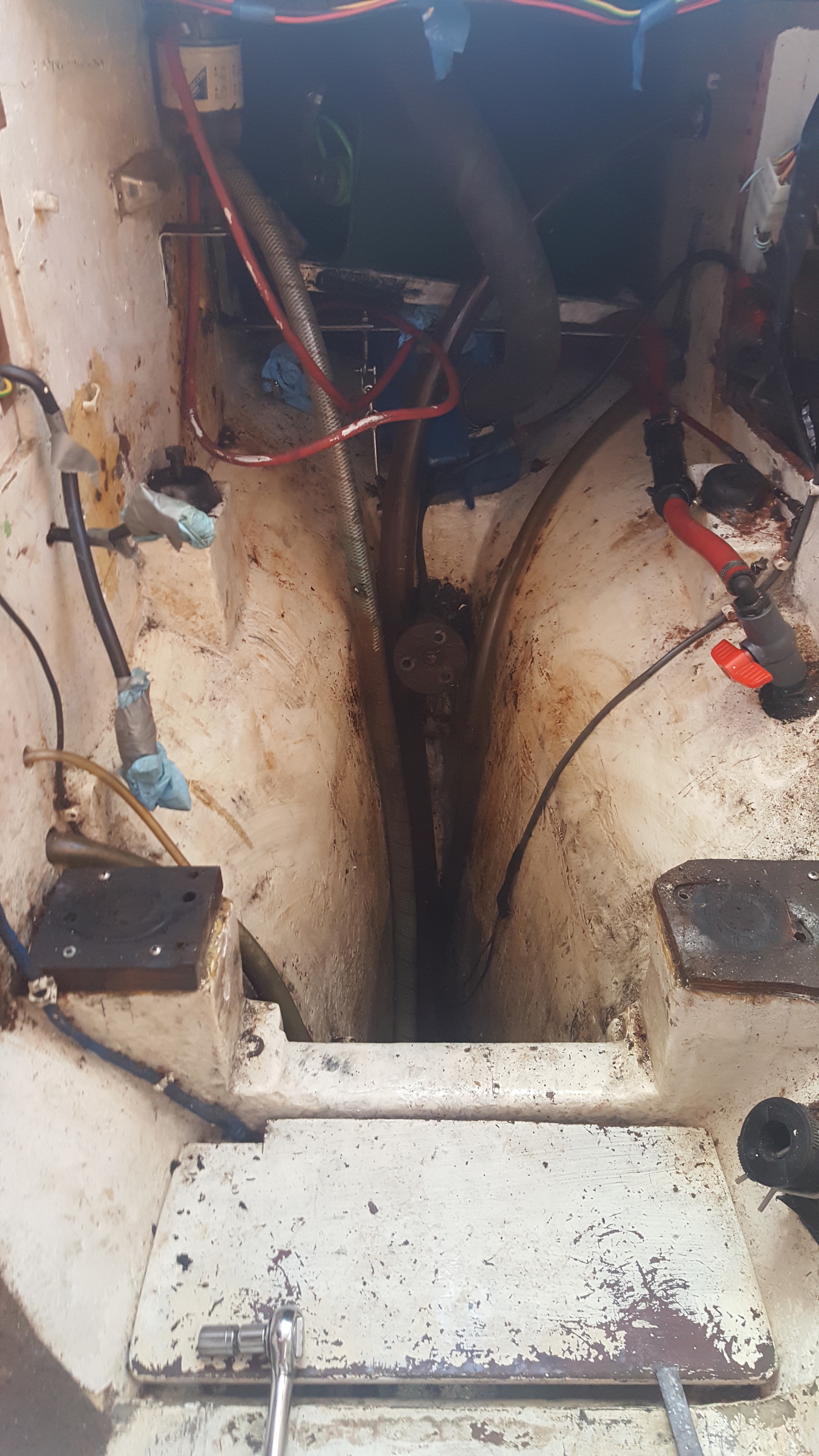

Here's the bilge which is going to get a good clean + service (one of the 3 bilge pumps needs replacing)
dirty bilge.jpg (1.01 MiB) Viewed 13185 times

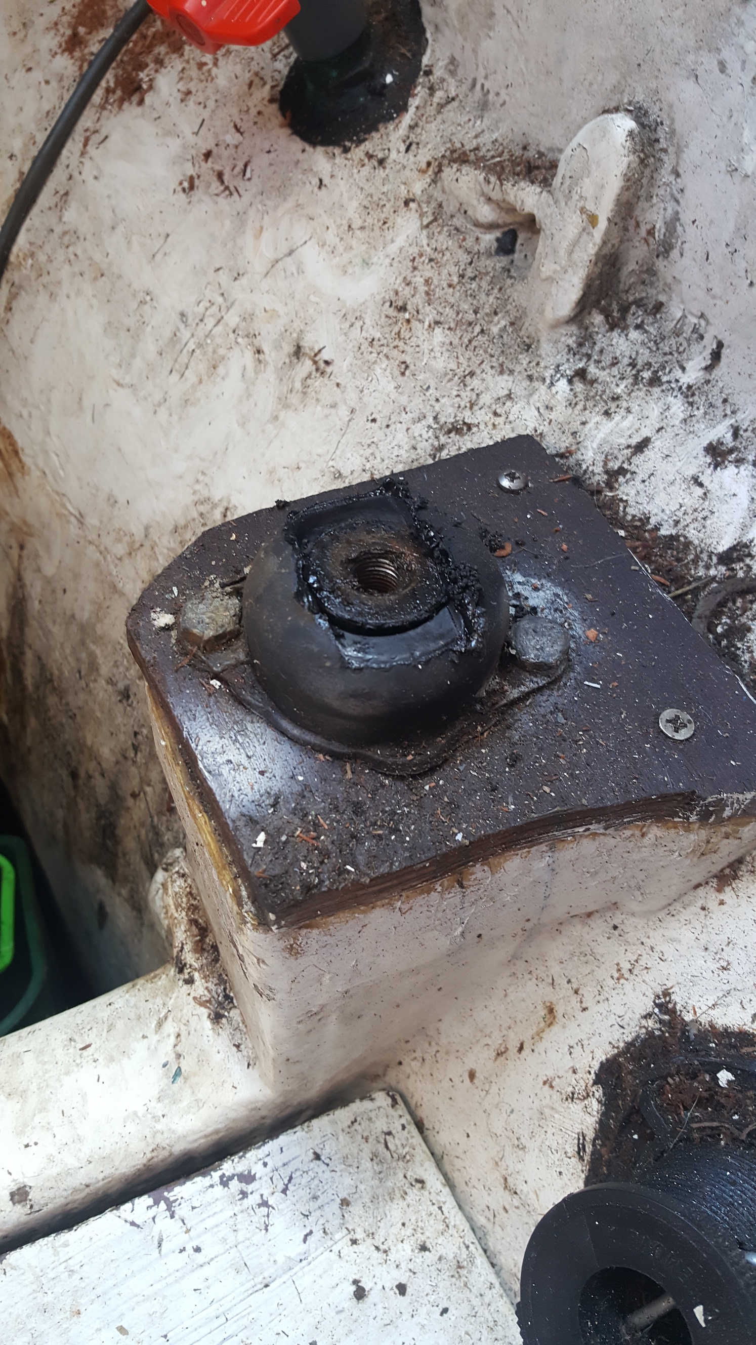

I'm keen for opinions on the engine mounts.. they're not looking like engine mounts i can find online. I don't want to have to modify the engine mount beds because that's gonna be a hassle.
Turns out one of the mounts was broken (rear port side) and the front starboard side had a dodgy bolt where it was fastened to the engine so I'm sure the mounts were the problem

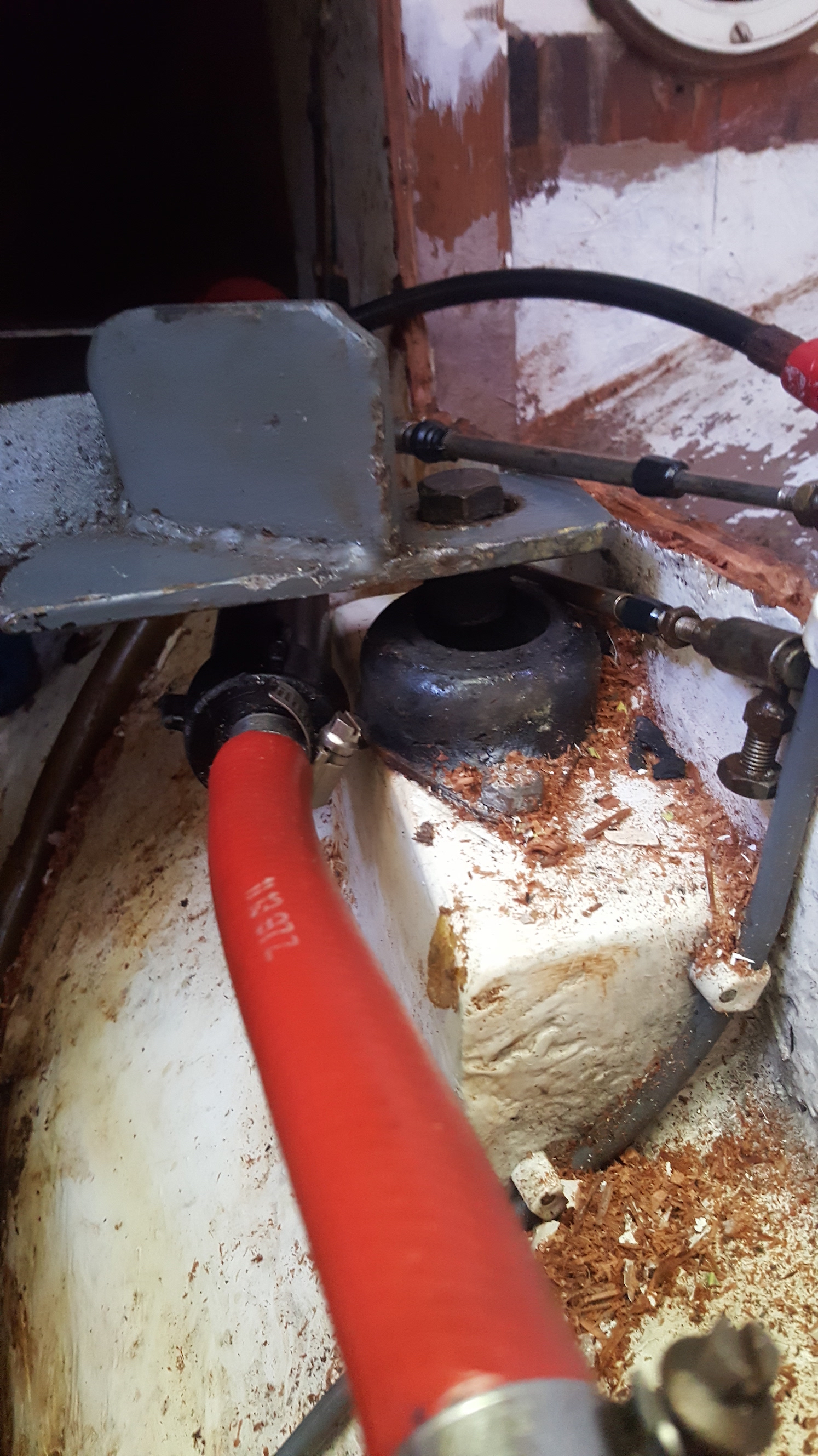

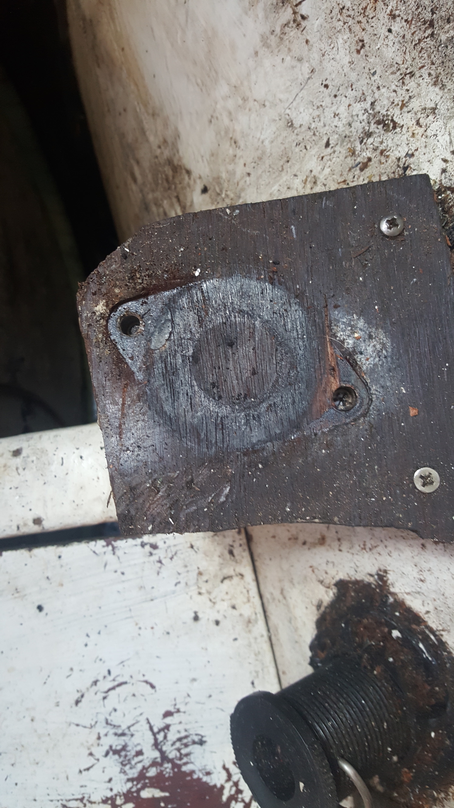

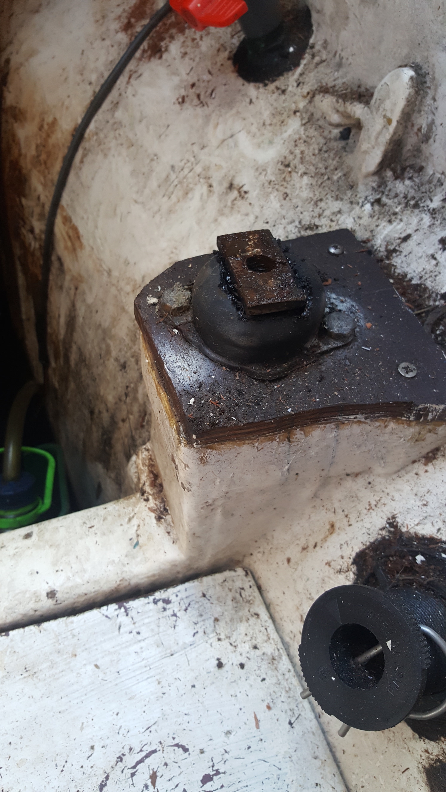

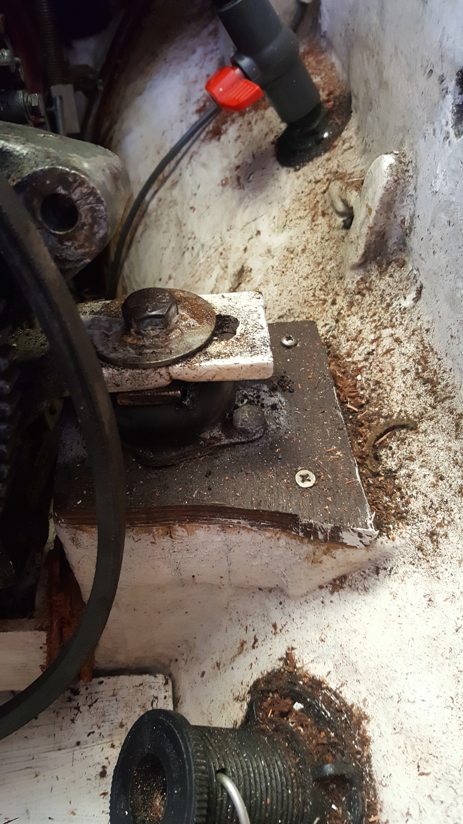

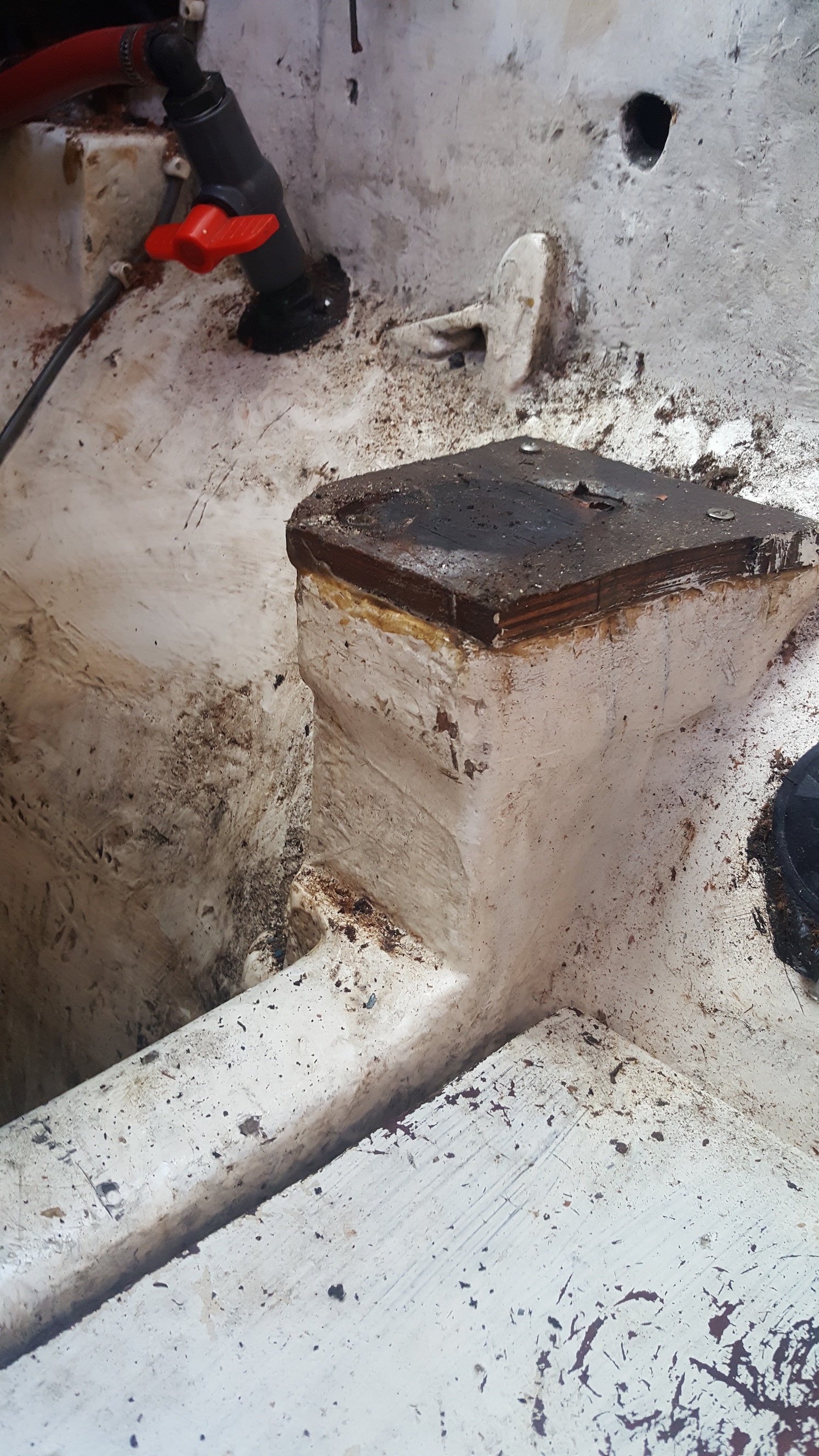

Postby Sailtime » Wed Mar 29, 2017 2:16 pm
Here's the front port mount - 2 x bolts snapped off into the mounting bed when i was removing it
Front port mount before removal.jpg (1.3 MiB) Viewed 13185 times
Front port mount 3.jpg (1023.67 KiB) Viewed 13185 times
Front port mount 2.jpg (1.33 MiB) Viewed 13185 times
Front port mount snapped bolts in mount.jpg (1.13 MiB) Viewed 13185 times
Front port mount.jpg (1.35 MiB) Viewed 13185 times
the engine mounts and everything look pretty DIY which I dig but not sure if it's possible to just use the same mounts? They look nothing like the mounts recommended by the manufacturer but to use those would require a complete modification of the beds..
here's the rear port mount which had snapped
broken rear port mount2.jpg (1.07 MiB) Viewed 13185 times

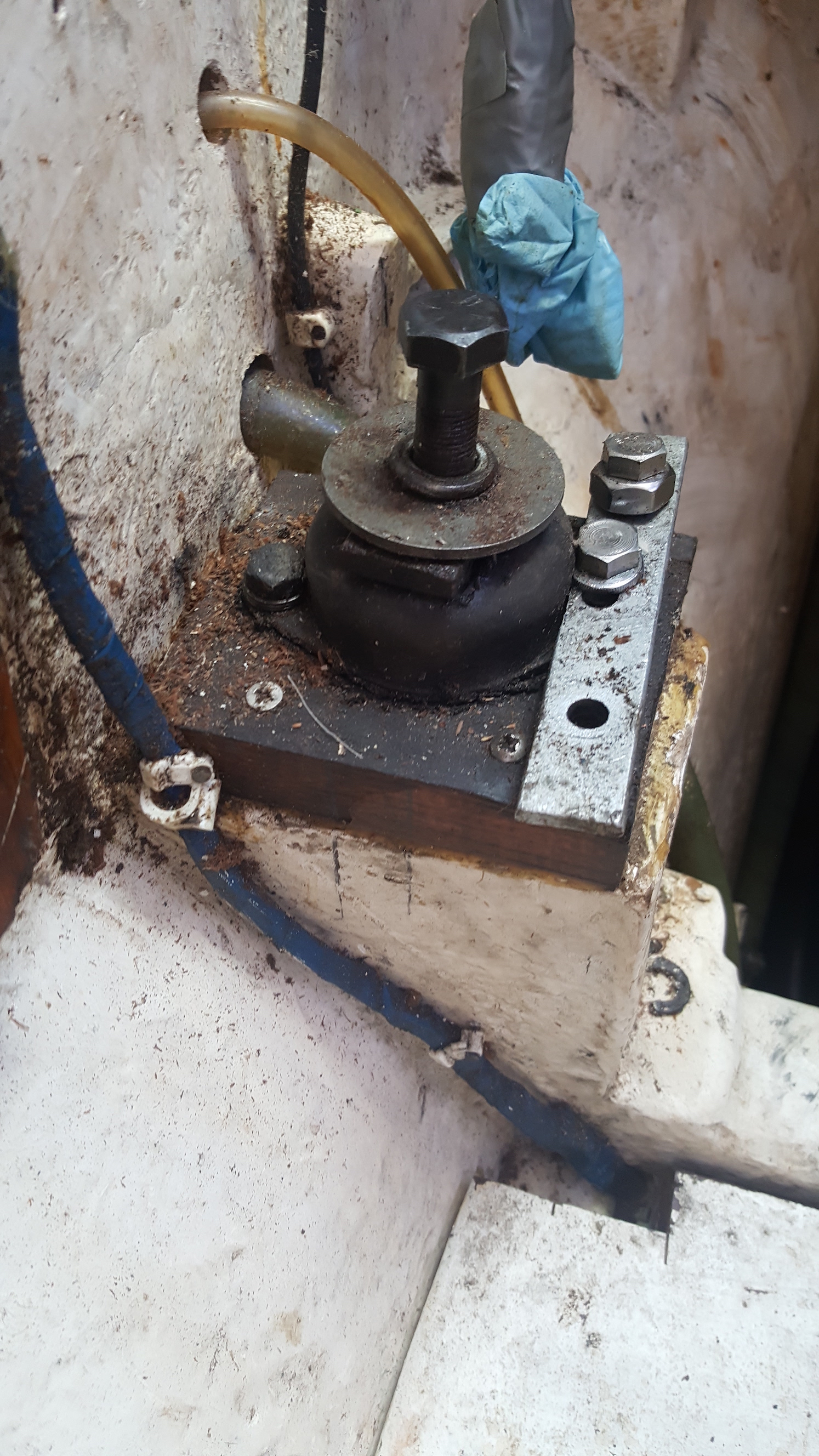

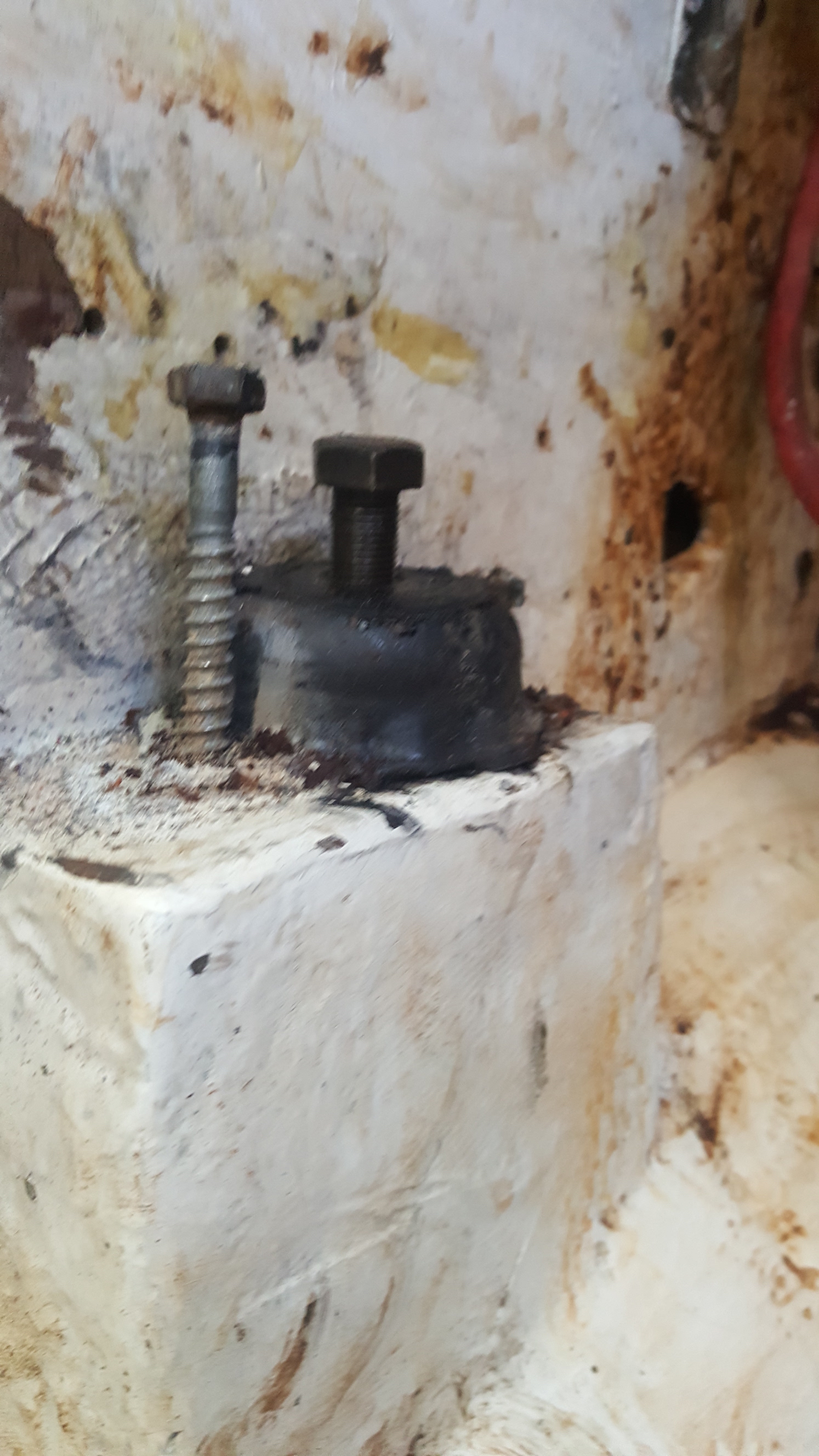

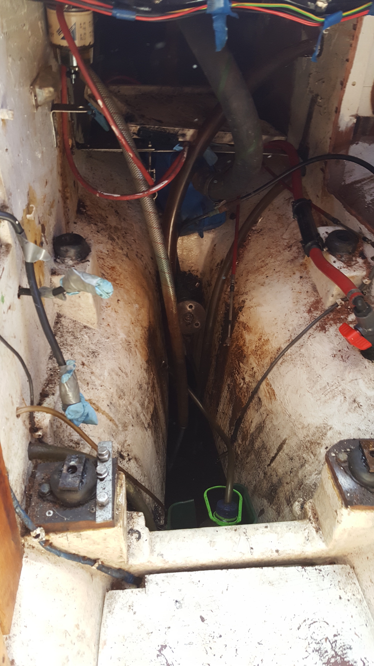

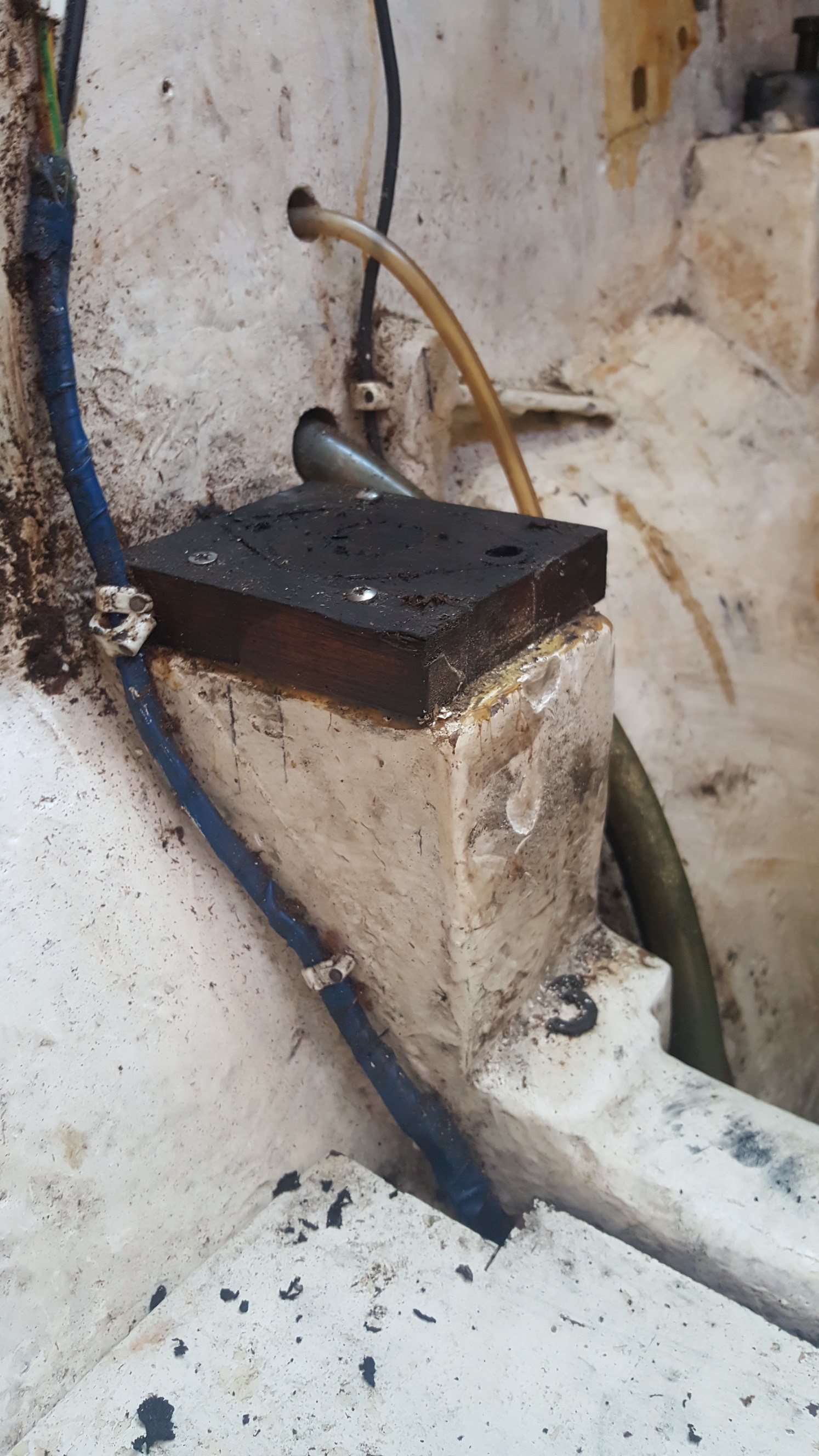

Postby Sailtime » Wed Mar 29, 2017 2:24 pm

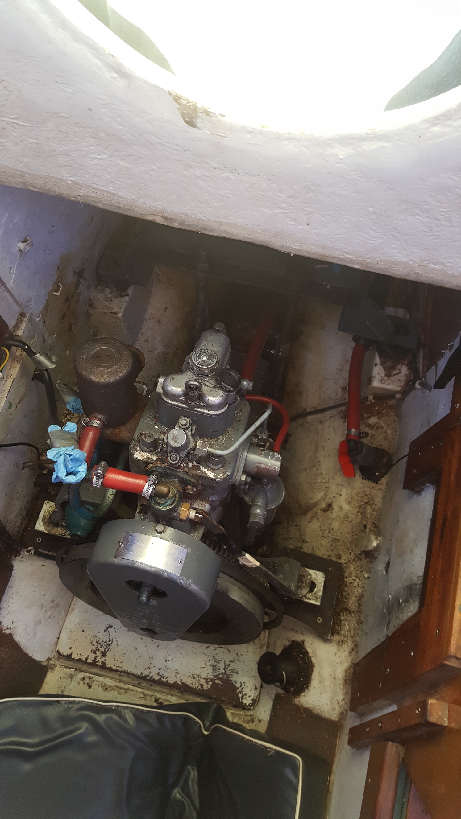

Here you can see the rear of the engine supported by the metal crosspiece which is on the rear mounts
engine in situ.jpg (962.28 KiB) Viewed 13185 times
front starboard mount
front starboard mount before removal.jpg (988.64 KiB) Viewed 13185 times
Front Stbd mount 3.jpg (1.12 MiB) Viewed 13185 times
Front Stbd mount.jpg (1005.93 KiB) Viewed 13185 times
Rear starboard mount
Starboard mount.jpg (777.37 KiB) Viewed 13185 times
All the engine mounts were secured into the engine beds with coach bolts.. is this sufficient?
Does anyone have thoughts on the suitability of these engine beds and are these engine mounts ok or are they dodgy?
I'd prefer not to get the mechanics/engineers involved cause they'll probably want to modify the mounts and beds etc and could be pricey..

Re: engine mounts
Postby Phillip » Thu Mar 30, 2017 8:20 am
Shea,
How do you do a shaft alignment, as there seems to be no adjustment in the front engine mounts and at the rear you only seem to have up and down?
