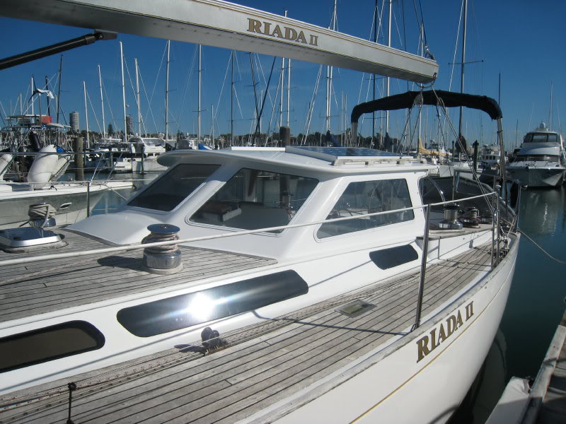

Postby Shaun » Sat Aug 06, 2016 7:55 am
Not exactly like this but along these lines would be nice...
Subtle sloop down to the front, grab rails & solar on top, low so not to obstruct view when standing, opening window on the front of it for ventilation.
All of my halyards(& reefing) is directly above the companion way so design will be important, also don't want to be banging my head on it.
