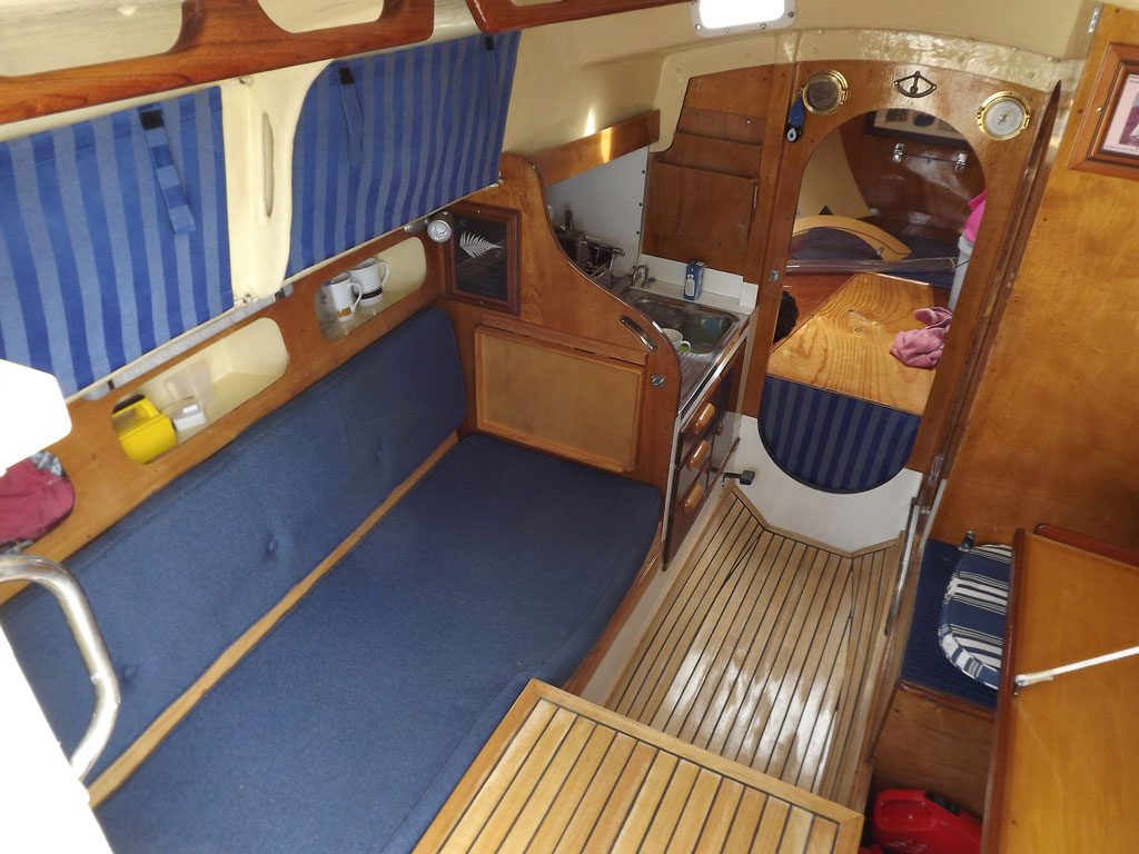

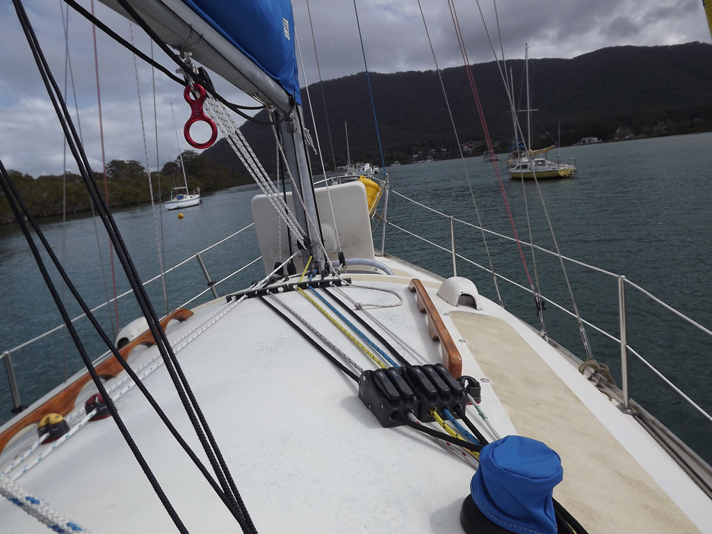

Technically today I have completed the refit of Seaka with having put back onboard all of her gear. :D
Only taken me 11 months! :shock:
So what did I do:
Removed all the old paint inside back to the glass and repainted in two pack paint. [Really this took up most of the time]
Re-varnished all varnished surfaces.
Raised the sea berth 10 cm to give extra storage.
Re-cut cushions to fit alterations to sea berth.
Rebuilt the cabin table [with a chart drawer under].
Put in several extra floors to deep lockers.
Re installed all the fly screens.
Repaired the clear rain screen to the cabin entrance.
Fitted an AIS receiver.
Relocated the am & VHF radios.
Re fixed all wiring.
Fitted navigation lights to the bow and mast [combined with a deck light] for steaming.
Re arranged the switch panel for additions.
Laid a pointed floor to the cabin and engine cover.
Insulated the engine bay.
Removed all the mast winches and wire halyards.
Installed a new winch and 5 clutches so as to work from the cockpit.
Installed all new running rope to halyards and reefing.
Fitted jib down haul leads.
Fitted a simple anti-jibe system.
Replaced all standing wire rigging.
Made a new mast head fitting to accommodate the new rope halyards.
Installed a boom bag.
New bag for the cockpit Bimini.
Installed a new 100 w solar panel and SS frame.
Replaced the heap rope to my second anchor with 14 mm Braid.
Replaced the main forward bollard timber cross piece.
Installed 2 rope bags in cockpit.
Previously [01/13] I had replaced the stern cutlass bearings and realigned the engine.
Anything left to do?
Clean and polish the deck and sides.
Anti foul.
Replace the anode.
Seaka's cabin.
Seaka's new deck layout.
Postby Shaun » Sun Sep 14, 2014 7:55 pm
Well done Phil!
She was the best MKI I'd seen ....before the re-fit!!
Lots of time & hard work, but a first class result.
