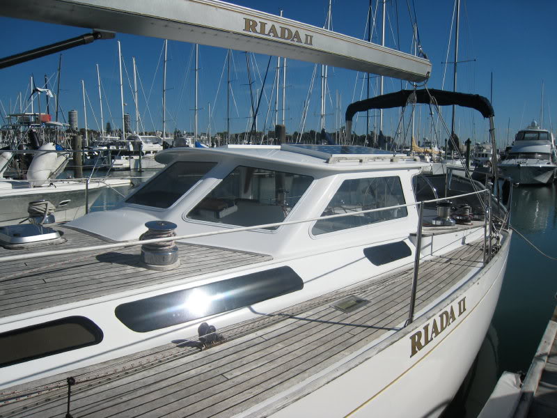

Postby Shaun » Sat Aug 06, 2016 7:55 am
Not exactly like this but along these lines would be nice...
Subtle sloop down to the front, grab rails & solar on top, low so not to obstruct view when standing, opening window on the front of it for ventilation.
All of my halyards(& reefing) is directly above the companion way so design will be important, also don't want to be banging my head on it.

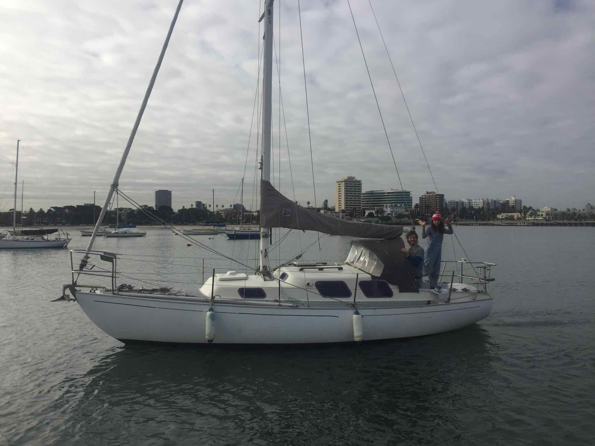

Postby KJD13 » Wed Aug 10, 2016 9:06 pm
I had a dodger on my Mark 111 when I bought her - it is a pretty simple arrangement, with 2 zipped plastic "windscreens" that can be rolled up when you want ventilation.
I would be only too happy to share a photo if someone could advise me how to upload a photo.

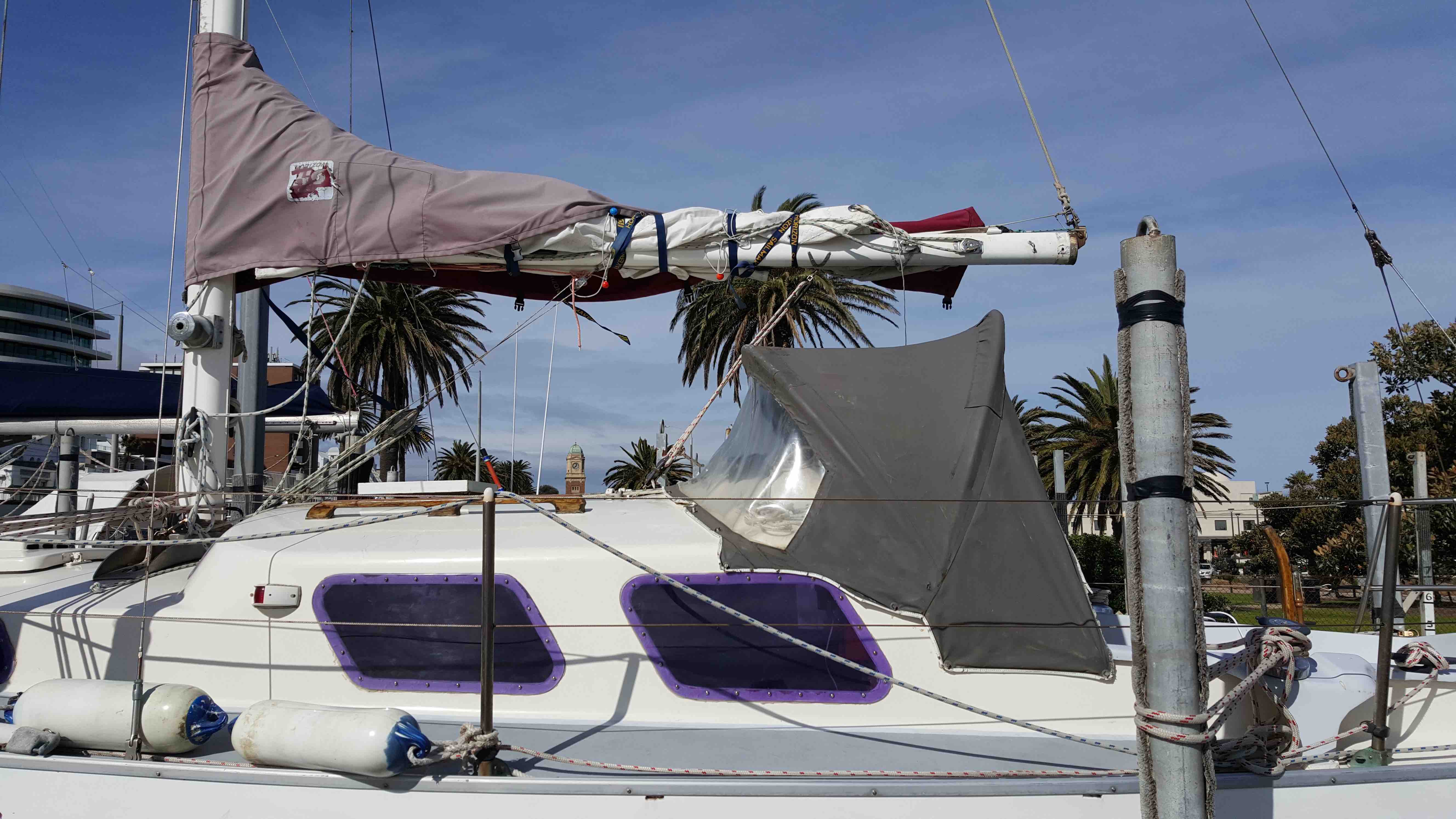

Postby Sailtime » Fri Aug 12, 2016 5:04 pm

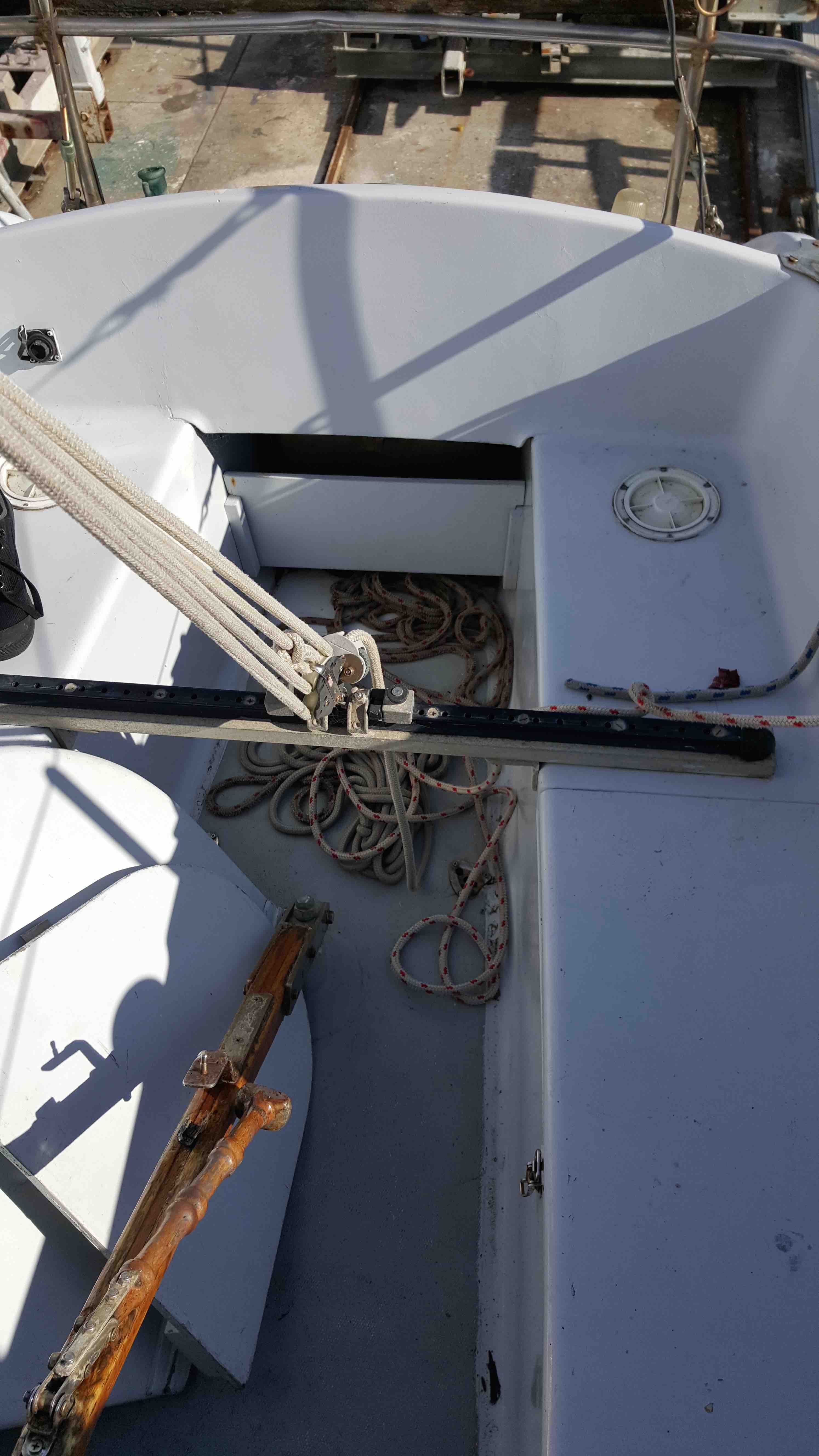

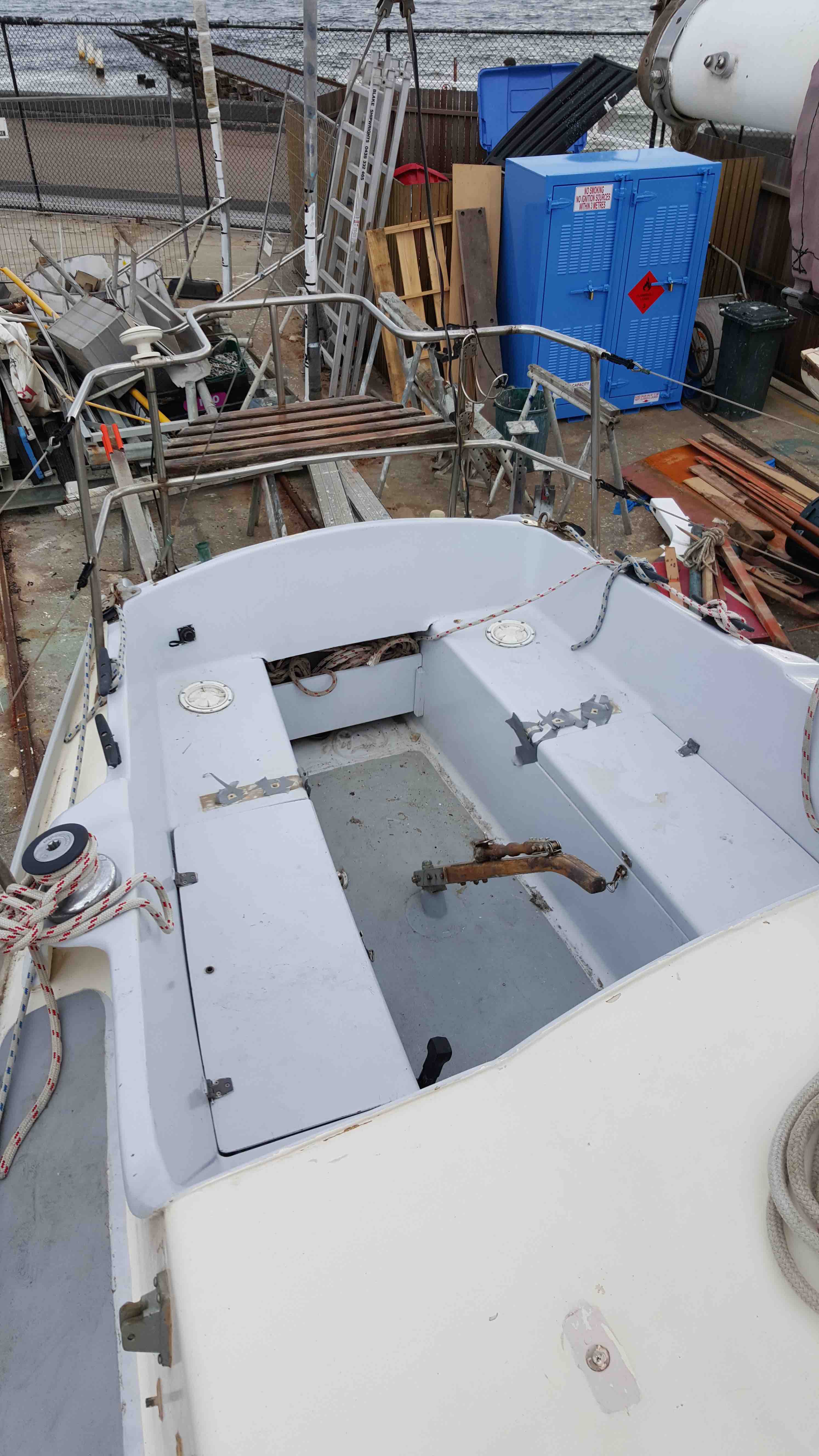

My dodger is great but makes the main sheet position tricky. My cockpit was split by the traveler and the mainsheet so I'm experimenting with moving the main sheet to mid boom and losing the traveler.. in my experience the traveler rarely gets moved from the middle anyway (which everyone disagrees with! but i still see them always in the middle.. ) and i think having a good vang to keep the boom down is good enough for sail shape.. what do people think? I've been reading up on it a bit and no traveler seems to be reasonable..
It's freed up the cockpit but i haven't sailed it yet
anyway here's some photos of the dodger and new mainsheet setup etc
shea
heres the dodger setup, you can see the mainsheet hanging off the end of the boom attaching in the cockpit - i've been jealous of THs with a clear cockpit
heading out.jpg (128.63 KiB) Viewed 8964 times
dodger needs replacing.. rips at a glance
dodger 1.jpg (590.14 KiB) Viewed 8964 times
traveler gone.. so much space! epoxy filling in holes
cockpit space.jpg (580.98 KiB) Viewed 8964 times

Postby Arohanui » Fri Aug 12, 2016 5:18 pm
I think id prefer the main sheet traveller left alone somehow with the dodger working around it. a bit tricky though aye!
Personally i like the option of having the main traveller hard to 1 side.
Interested to see more dodger applicatons!

Postby Miker » Sat Aug 13, 2016 12:09 am
You could install a round bar traveller. This is essentially the same tube as your bow rail, fitted in an arch across the front of the dodger to the top of the coach roof. The lines controlling the car (different to a norma car) it can be led through small blocks and back to remote jaw cleats closer to the helm if need be.
Or, there are some companies who sell traveller kits for boats with dodgers. It's worth a google.....
A traveller is important for some points of sail to keep the sail shape whilst sailing off the wind, and can be used to come even closer to the wind in some circumstances.
