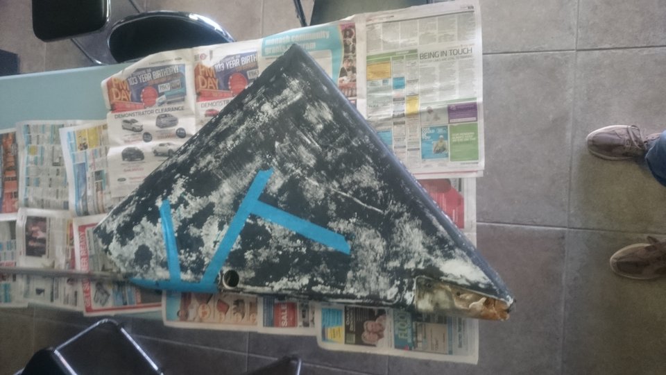

The rudder of my Mark 3 has dripped water each time I have slipped for at least 20 years. This year I decided to investigate.
I removed the rudder and cut an inspection hole. Using a wire through this hole, and through the hole which accepts the pintle, I found that the shaft and its tangs are attached to one side of the rudder, and that the other side is attached to the first side only around its perimeter.
I am uploading two photos. In one I have attached blue tape to the rudder to show the locations of the shaft and its tangs. This shows that the drawing in the Mark 3 gallery is inaccurate, although correct in principle.
Once I knew that one side of the rudder is attached only around its perimeter, I was able to cut a large panel out of this side. The second photo is looking through this panel at the tangs and shaft which are enclosed in thick fibreglass.
It appears that the construction sequence was as follows. The tangs were welded to the shaft and the assembly was laid on one side of the rudder, with a bed of filler under the shaft and tangs. Thick fibreglass was then laid on top of the shaft and tangs to attach them to the side. Finally the second side was placed on top and attached around its perimeter by fibreglass.
With this arrangement, even if the void between the two sides is full of water, the water cannot reach the stainless. Although water in the void cannot reach the shaft and tangs, in my rudder water had penetrated from the top, washing out the filler alongside the shaft. I was able to insert a narrow rod about 200mm into this cavity. It did not appear to have affected the strength of the assembly.
I cut away the fibreglass to expose the stainless in a few places, including where the upper tang is welded to the shaft. The stainless was in perfect condition at each location.
The only corrosion I found on the shaft/tang assembly was on the shaft above where it enters the rudder. There is pitting corrosion. I have no explanation for this. I cover this area with antifouling paint but I am not aware of this paint causing corrosion.
The six pieces of stainless threaded rod which hold the shoe to the hull, and which hold the gudgeon to the rudder, were severely corroded. Their nuts were not corroded. I suspect that the threaded rod was grade 304 rather than 316.
Junkman, I hope you have found this reassuring. If I was you I would go sailing and put off work on your rudder for a year or ten. Maybe you should check the bolts or threaded rod as this is easy to do without removing the rudder.

Postby junkman » Fri Dec 13, 2019 8:13 am
Hi Steve, thanks for your informative and re-assuring reply. Very interesting to see inside your rudder. Blue Moon is a shallow draft version (the keel is 10" shallower) so the rudder is smaller, but the structure should be the same. The first owner of BM fitted a side shaft for his diesel and therefore cut a bit off the top as well! He filled the gap at the top with timber and glassed it but Shaun mentioned he had to reglass it as it was not done too well. Looks ok now and there is no sign if cracking anywhere. I also found a small amount of crevice corrosion just where the shaft entered the rudder at the top. A collar of hard putty had been placed around the shaft but water had permeated it. I cleaned it up and resealed it with glass tape and epoxy. I'll replace the bolts next time and see what it looks like. I feel much happier about going sailing now. Thanks again.
