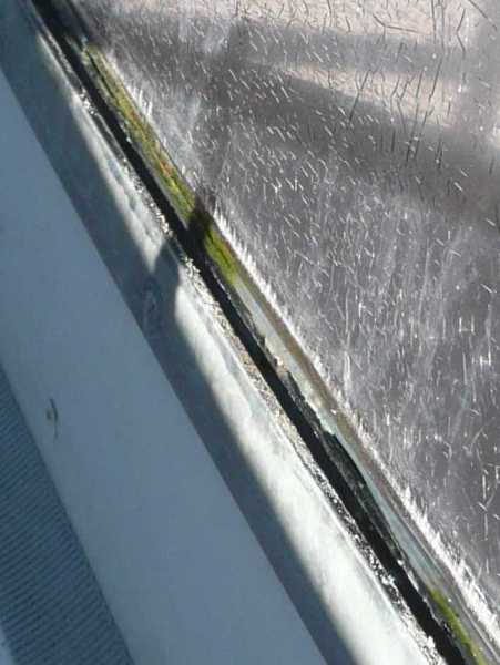

Well there is no going back now. I was a bit surprised how bad the damage was.
Anyway, I'll press on.

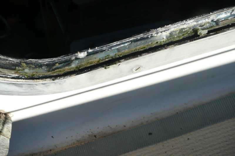

Remove the rubber, It isn't a seal.
Water had got in between the silastic and the frame.

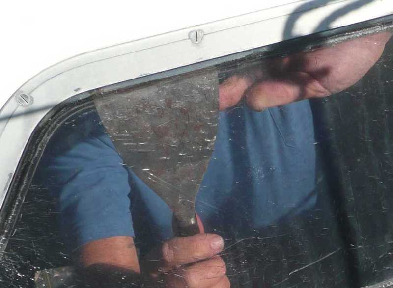

The next thing was to break the seal. I did this by getting a thin scraper between the "Glass" and frame.

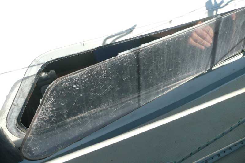

Gently push the acrylic out, you'll be surprised how easy it comes out!.

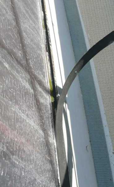

You just don't know what is growing in there ! :o

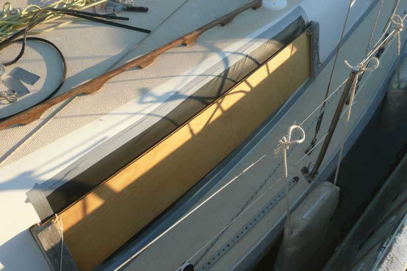

I put a temporary patch over the hole using the storm board and a bit of builders plastic.
We're expecting bad weather in a few days.
