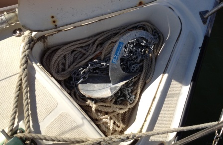

Postby Tales » Wed Feb 29, 2012 9:19 am
I have an Oceane (the new version is a 5kg Spade see http://www.bluewatersupplies.com/oc.htm)
Fits in the MkIII locker nicely with 8m of 8MM chain and 50m 12mm nylon.
Oceane in MkIII.jpg (68.48 KiB) Viewed 11801 times

Thanks Tom, at just 5kg, how does that anchor hold? Is it enough for most situations?
Re: The small anchor well
Postby Tales » Thu Mar 01, 2012 3:00 pm
I have been using it for 8 years now and it works really well. Always sets first time and resets with wind change automatically.
It's not the weight that counts but the design (which causes it to penetrate and keeps it down) and the area (which does the holding).
The Spade, from which the Oceane was derived, received the best score in the recent test in Cruising Helmsman.
I have not used it in kelp or shale and suspect a fishermans would be better in those conditions but otherwise it has been a beauty.
The length of nylon helps enormously because stretches and takes out the shock (as would plenty of chain if you use it).
We have been very happy overnight in over 30 knots.
Another time we had nearly 20 with a Mottle 33 (4ton plus) tied up to our stern! Took a lot to retrieve as it was buried really deep.
Having confidence in your anchor is a great thing and takes much of the stress out of mooring at the end of a trip especially when you are tired.
