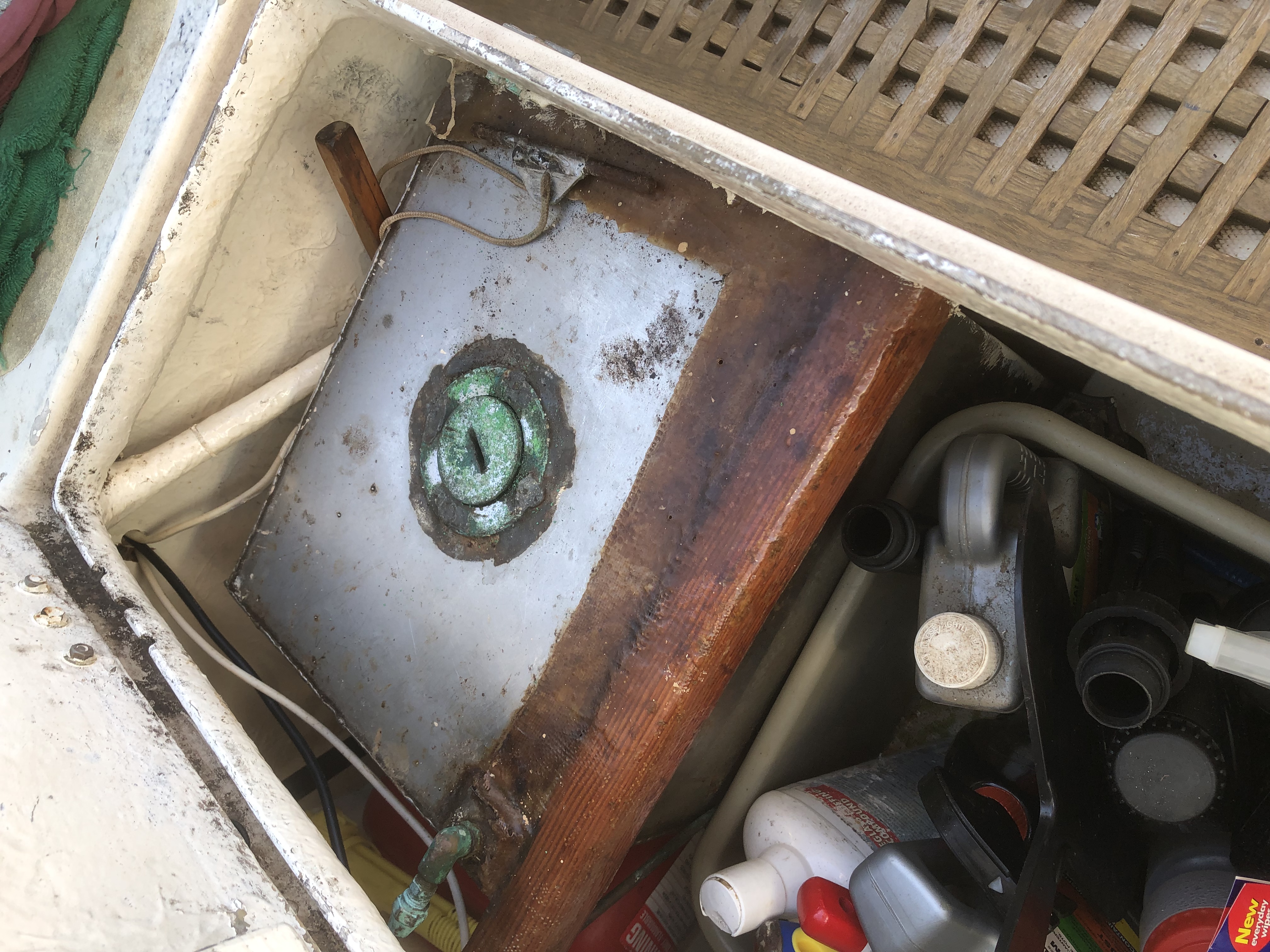

Quite keen to see examples of diesel fuel tank installations if anyone has a photo?

Seaka’s fuel tank.
Here you go sailtime. It’s a mark 1, port cockpit locker. 30 litres.

OHS (and E) would put weight on having fuel tank outside cabin. When the boat was designed inboard diesels were not rare and
the designer would have taken into account the weight of the tank and fuel and safe filling and spillage issues. You may find insurance problems if there is an incident and you have shifted fuel tank position. Largely it's a matter of 'if it ain't broke don't 'fix' it. My Mk2(or 3 still not sure which as first surveyed but for insurance, 1984 ) has fuel tank as shown in the picture here on forum. I can email you a picture if you want.
