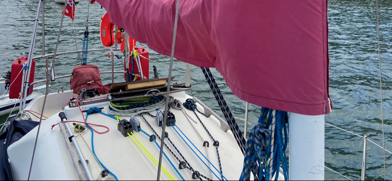

Just wanted to get a few opinions and start a discussion. I'd love to have a little dodger (not massive) similar to Felicite's dodger or even a little smaller. I am thinking about relocating the mainsheet attachment from mid-boom to the end of the boom and onto two attachments on the cockpit combing near the pushpit so that it's an A-shape main sheet arrangement.
What are your opinions to end boom sheeting on a Top Hat?
I've got so many lines on the coach house that it's not funny anymore. (Main, Jib and Spinn Halyard, topping lift for the pole, topping lift for the mast, vang and the lines for three reefs. 3x clew 2x tack, first reef goes on the horn) All up there are some 12 lines. It kind of suits me that the boat was set up that way but I am a little unsure how to manage the lines with a little dodger.

How about a photo of your cabin top so we can see what you have. :D

Postby Macintechno » Tue Jul 20, 2021 2:45 pm
There’s no cabin top anymore, Phillip, there are only lines….
Currently just wondering about end boom sheeting system vs. mid boom.

Postby steve » Wed Jul 21, 2021 2:50 pm
Hi Daniel,
It looks like you have a nice setup on the cabin top.
I think you would regret changing to end of boom sheeting. End of boom sheeting might have been good in the old days when booms reached to the transom, but the Top Hat boom reaches only just past the jib winches so the sheet would be sweeping the middle of the cockpit every time you tack or gybe.

Postby Phillip » Wed Jul 21, 2021 5:12 pm
Have to agree with Steve.
Illingworth designed the rigging and I think he would have had more experience than all of us put together.
Stay with the normal arrangement Daniel.
