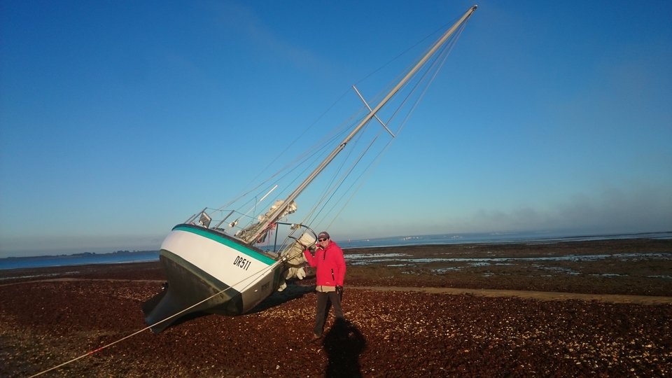

The attached photo may explain why I want to improve my set up.

I see you do not dive, but that's a bit of a drastic way to inspect your bottom :lol: :lol: :lol:

We went aground at the top of a king tide. We were flying the kite and by the time we got that down we were too firmly aground to get off again. The next high tide was lower so we had to wait 24 hours to get afloat again. We had only gone out for a day sail but fortunately had our lunch and some biscuits aboard.
