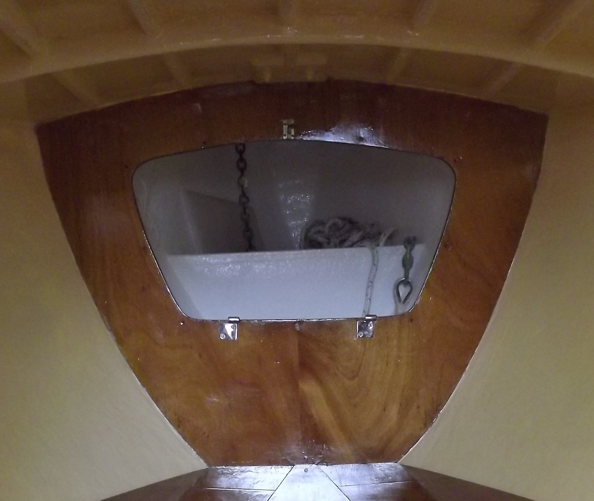

Then maybe you could reconstruct your chain locker like a Mark 1.
I find that very little water gets into the chain locker and I also have a drain tube attached into the rear compartment, where I keep an extra 60m of 12mm Double braid attached to the chain, that I can drain from time to time. I do rarely have to check the chain part while cruising when the chain is all out and use a sponge for any water. Note the plastic cutting board to prevent wear on the hull.
This is the deck view of SEAKA.
The door to the locker which is hinged along the bottom side is not in place.
Chain locker SEAKA.jpg (417.41 KiB) Viewed 5135 times

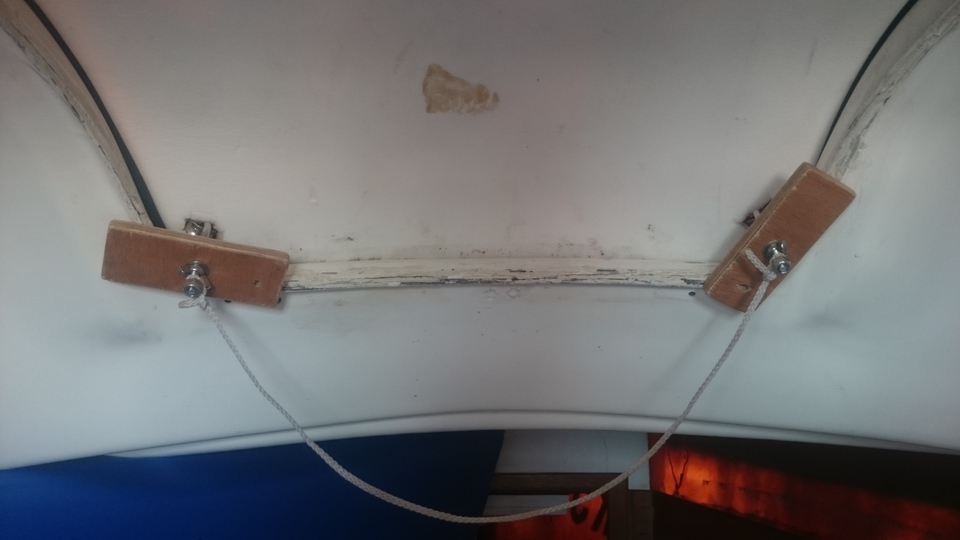

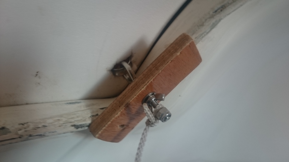

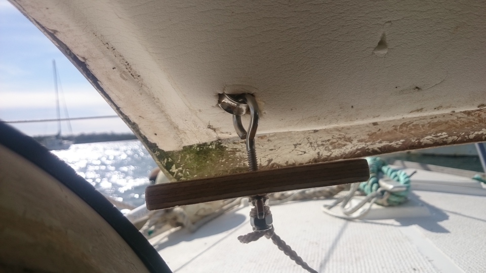

Postby steve » Wed Apr 29, 2020 11:04 am
forehatch 1.jpg (129.71 KiB) Viewed 5107 times
Hi Michael,
The photos show an alternative way of fastening the hatch. It's easy to install and the parts are available from Bunnings. You need a fastening at each corner to make sure the hatch is sealed waterproof. Each fastening comprises a saddle bolted to the lid, a ring bolt, plywood. butterfly nut, and a nylock nut to prevent the butterfly nut falling off. The string in the photo is to help close the hatch single-handed by drawing the two fastenings together as they pass into the cabin.
You should probably check with your safety officer if he will accept this arrangement before installing it, as it is not as quick to use as the over-centre latches Shaun suggested.
An even simpler system is to have a rope attached to the lid and going down to a cleat in the cabin. I used this method for some time but, even with a rope in each corner, I could not get enough tension on the rope to compress the seal and guarantee it being waterproof. With the wing nuts in the photos you can get plenty of tension.
