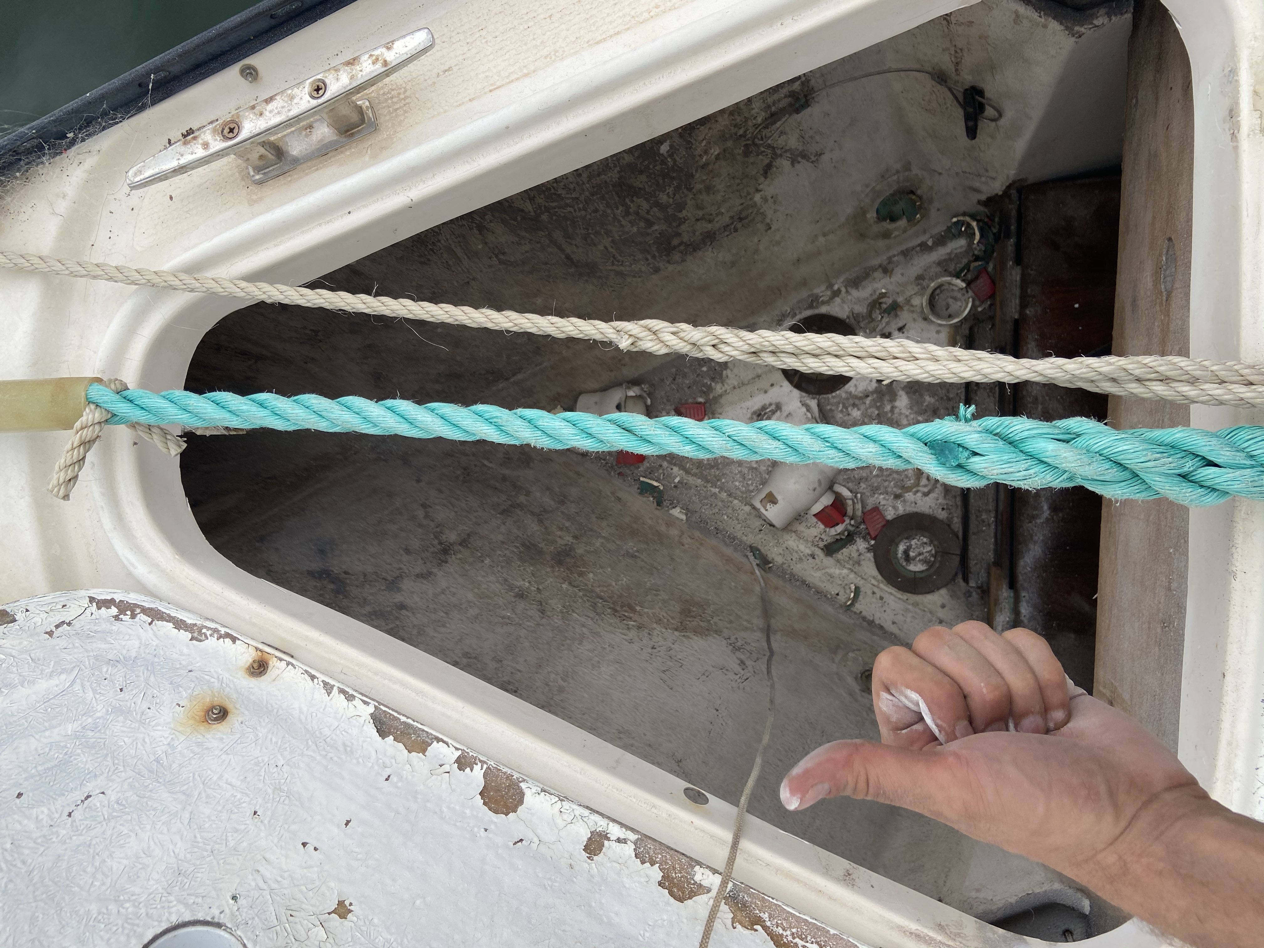

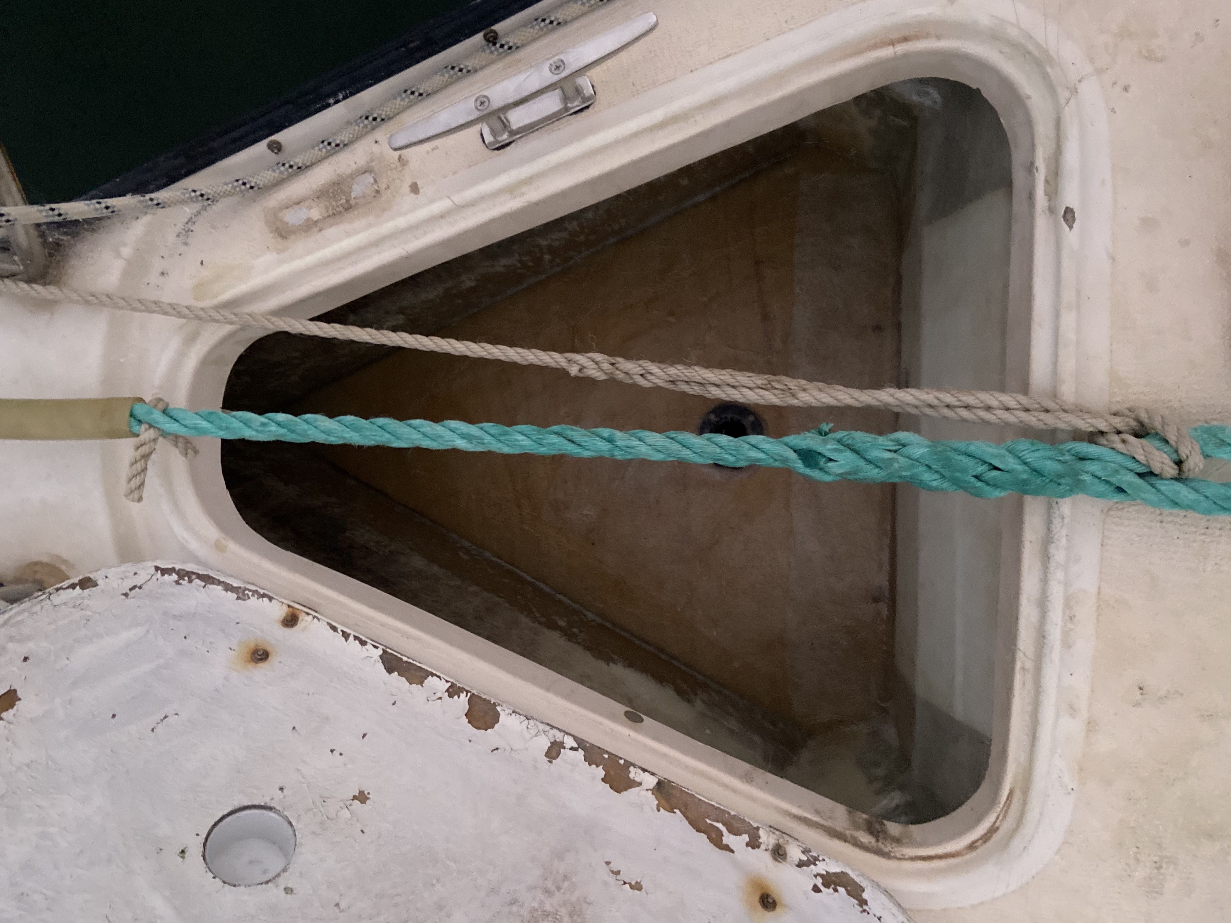

Hi all,
I hope you’re all well. During this crazy time I’m using some of the time to tinker around on my boat.
The current project is ground tackle...!
I’ve purchased a bucket of 8mm CMB chain (34m) and 100m of 12mm nylon three strand rope and also made up a 5m snubber. I’ve spliced the rope to the chain and attached a swivel element on the end of the chain. Another couple of links of chain and then the anchor with a shackle (existing 9-10kg CQR which I am looking to replace later down the track as it’s quite old and I’d like to have it a bit bigger.)
I’ve got my hand on a quick anchor winch which I’d like to use.
I’ve seen Troppos solution and while I like it I’d like to do things a bit differently. I’d like to have a massive anchor locker that can hold all rope, chain and anchor comfortably.
I’m thinking of removing the anchor locker all together and close the hatch on the inside with some solid plywood and the glasses over on the side of the locker. I’d also raise the bottom a bit to match the height of the thruhulls on either side.
I believe I can access all relevant screws and bolts for the pulpit (which I need to take out) by reaching into the hatch of the locker. Just wanted to check with you guys if you see any reason why I shouldn’t do it.

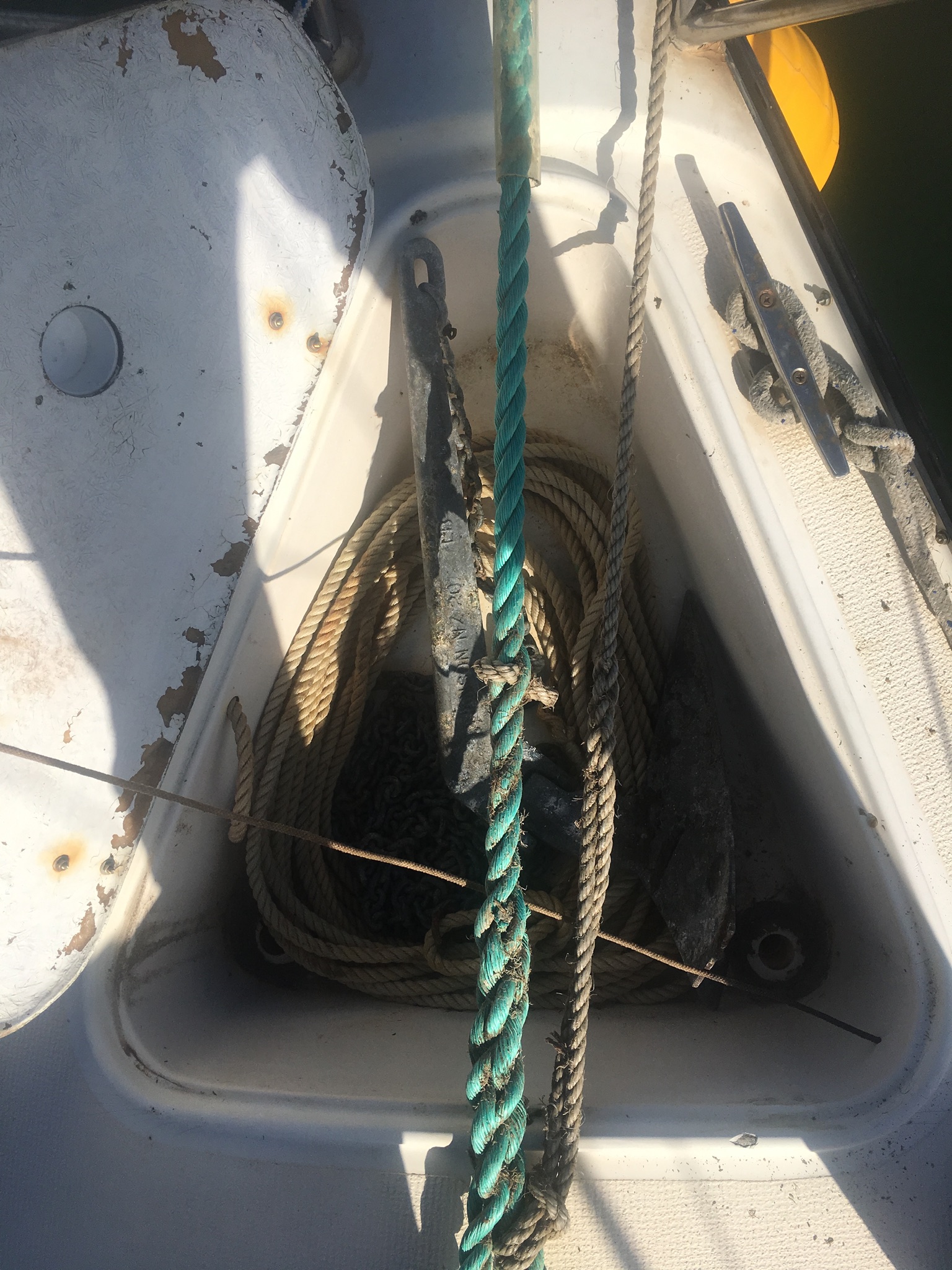

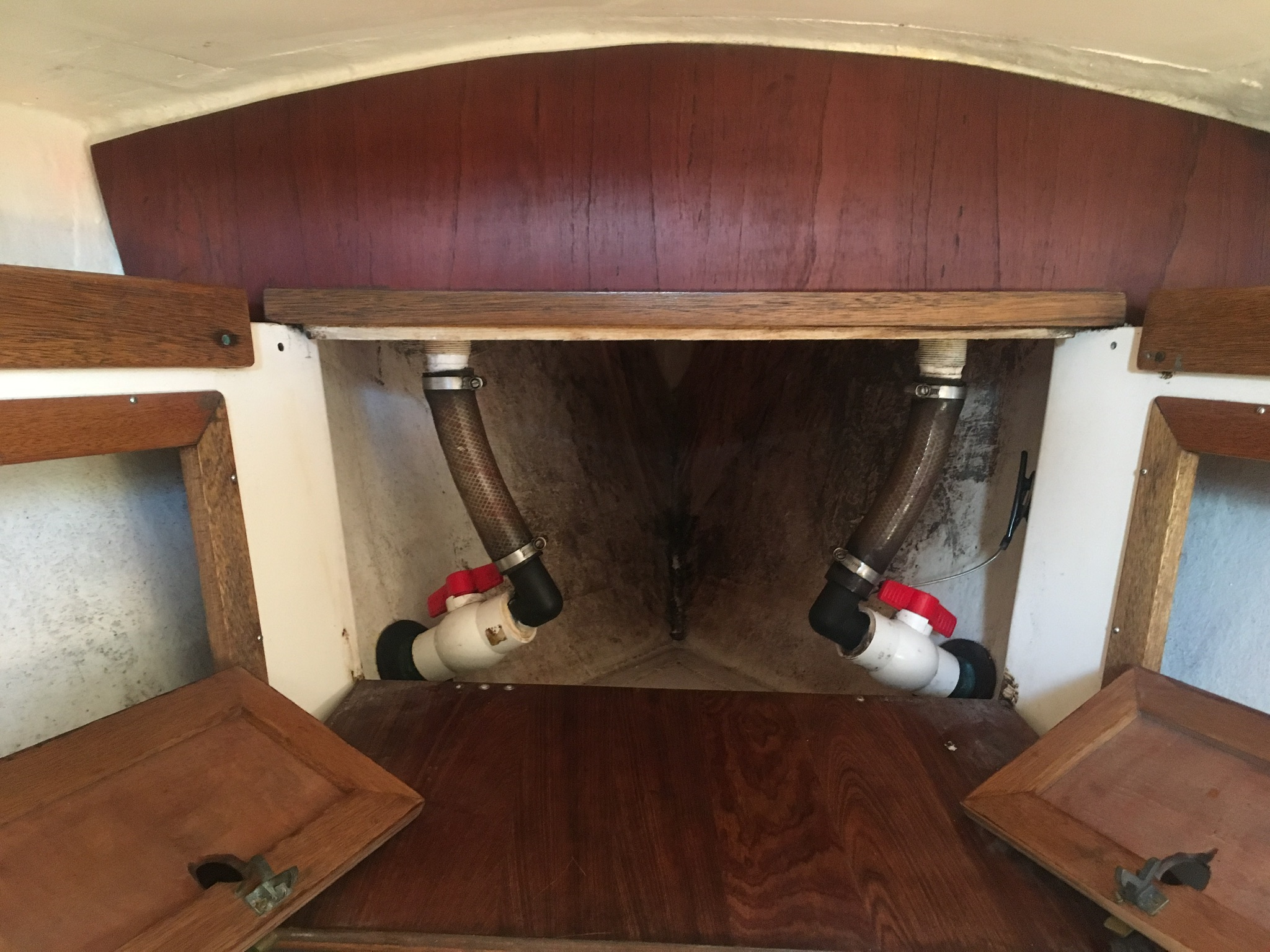

Here a picture of the hatch down on the inside and a picture of the current dirty anchor locker

I was down at the boat today and it’d be a really massive anchor locker. Some 65cm deep.
That’s exactly the plan. To get the fenders and stuff out of the way. For me it’s kind of useless space in the front as I’m not keen on dragging anchor stuff from the front through the ‘bedroom’.
Further there’s been some leakage from the pulpit into the section under the anchor well and that’s seeping in the v berth.
I’ll re-bed the pulpit to seal it up but it wouldn’t even matter it it still leaks.
I’m planning to raise the bottom by 5cm with some foam and then shape it in a way that water has to go to one of the two outlets. Then I’d glass all over it and make it nice and solid with a few layers.

There were options to make the locker similar to MK1 which does not have a drain at all but a closed deck and no hatch.
I wanted to have the locker accessible from the top and wanted more space.

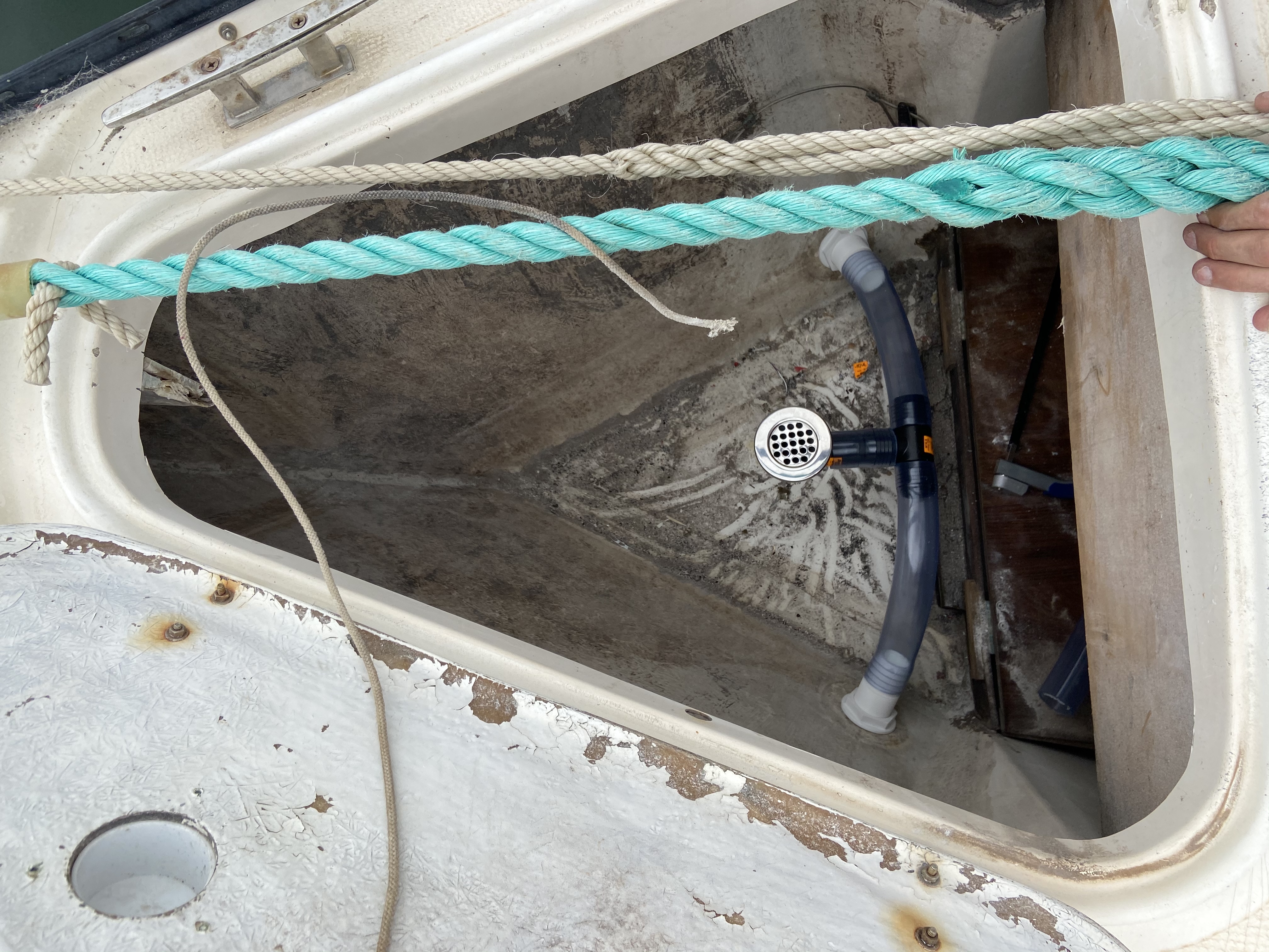

For the ease of process I decided to keep the two oversized thru hulls and combine them with a T joiner to one drain in the locker.
I’ve replace the old thru hulls with new ones (cheap plastic ones siliconed in as I’ll get her out of the water and want to replace all thru hulls with new proper stuff in a couple of months)

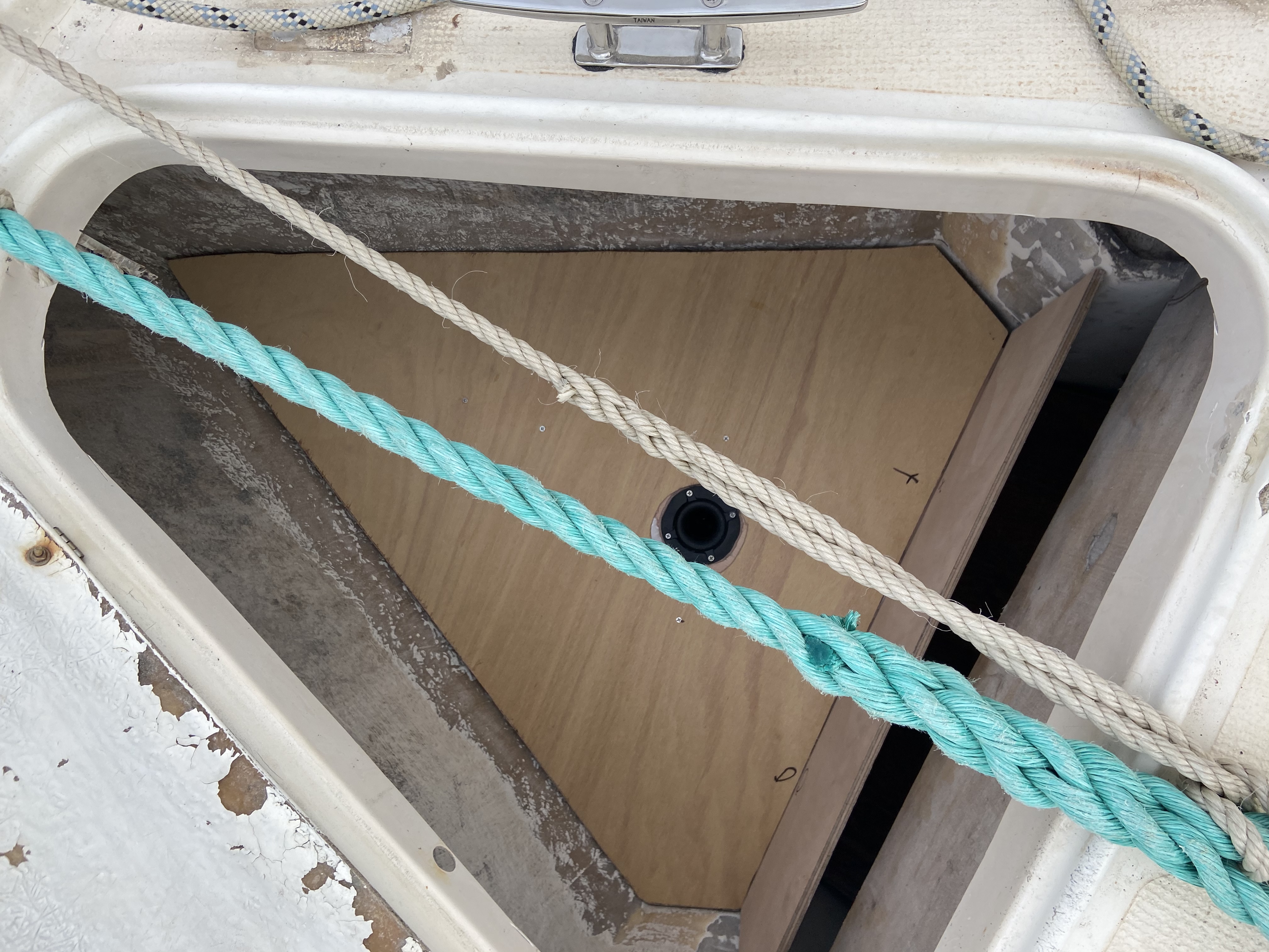

I’ve cut the old locker out, built a plywood platform with cockpit drain recessed in the bottom.
Will soon shape the bottom so it’s sloping to the middle.

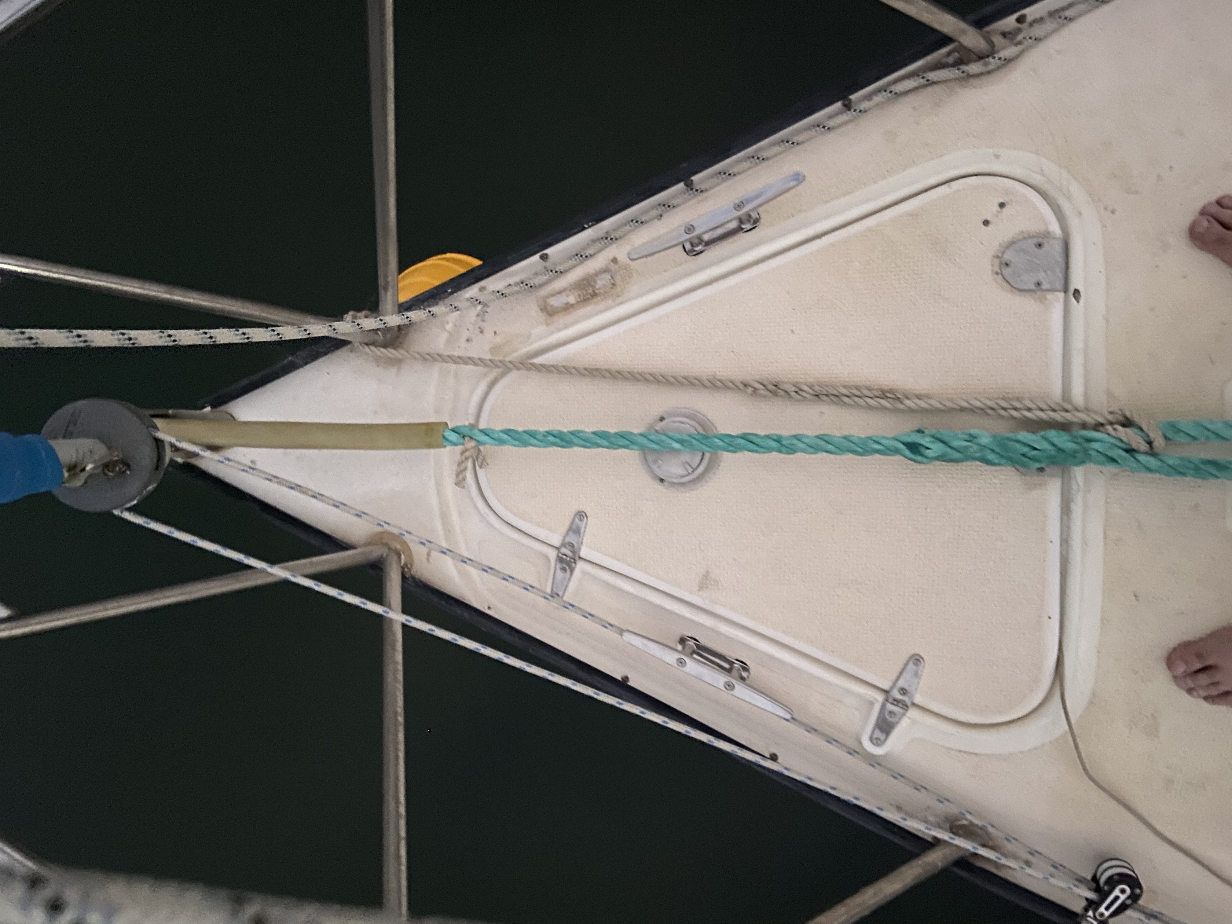

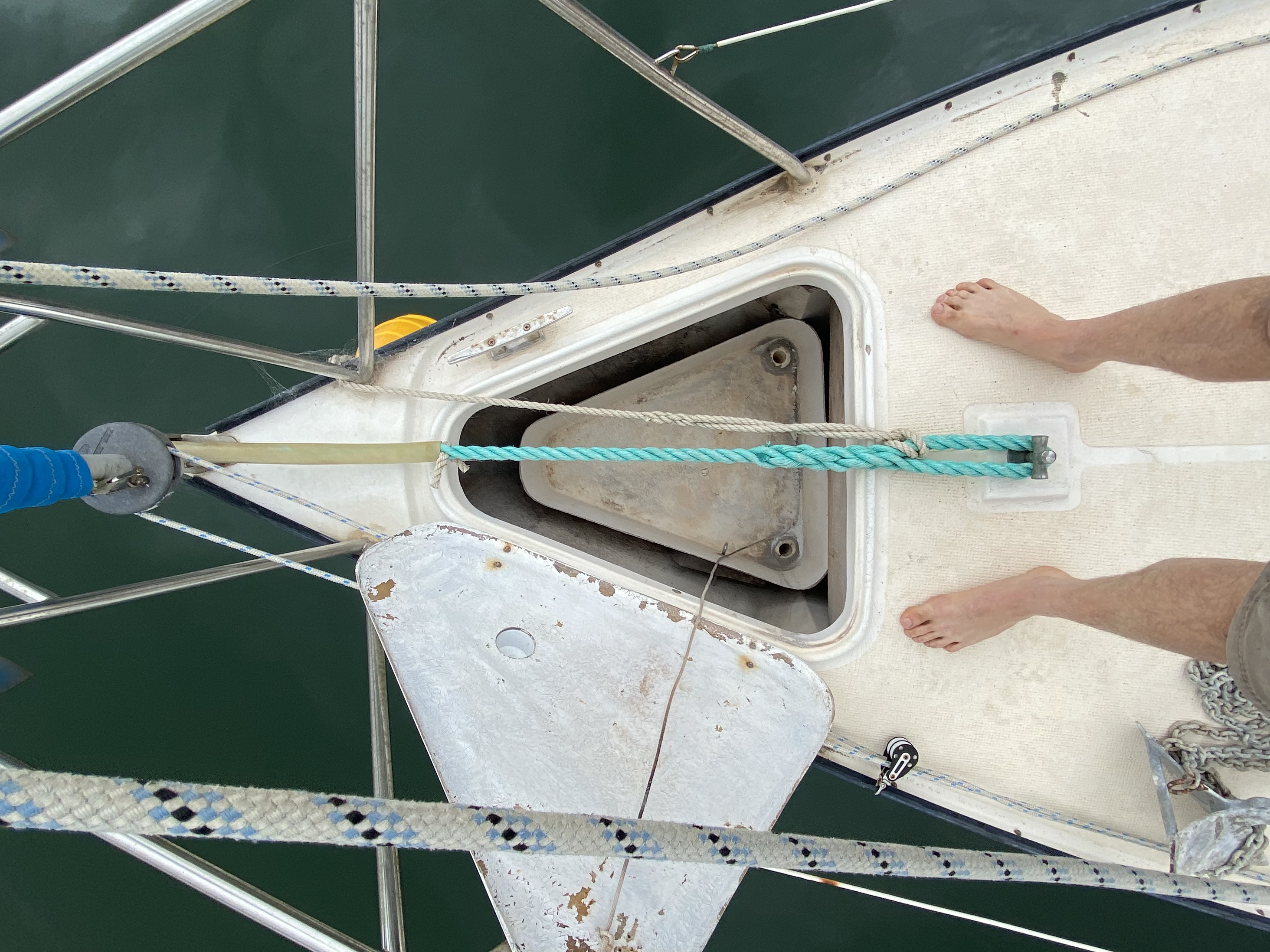

I ran out of time today so the windlass is not yet installed but I added two cleats on either side of the hatch for a double mooring line so I can leave the anchor out permanently.
Here some pictures of today’s progress. More to come when in have more time on the boat.

Next update:
The mooring is modified to take double cleats.
Pictures attached :-)
