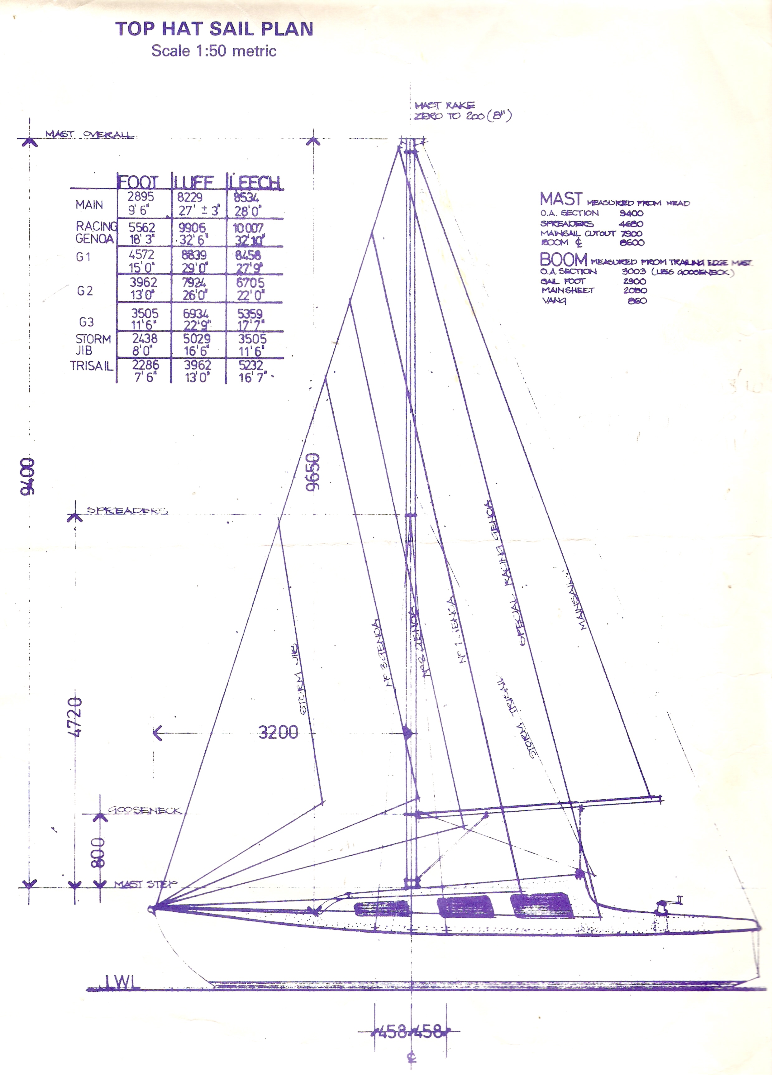

Sean, I know of only two sail plans, one for a Mk0 and Mk2 Here is the Mk2 one.
Sail Plan Mk 2

Thanks, Philip,
Looks like that's the one I have, which I think I got here a long time ago.
I've discovered I have an old #2 which I can recut for the furler.

Phillip wrote:Sean, I know of only two sail plans, one for a Mk0 and Mk2 Here is the Mk2 one.
Thank you, Phillip, we started unrolling a few of the five sails we have, this drawing makes it very clear what they all are!
