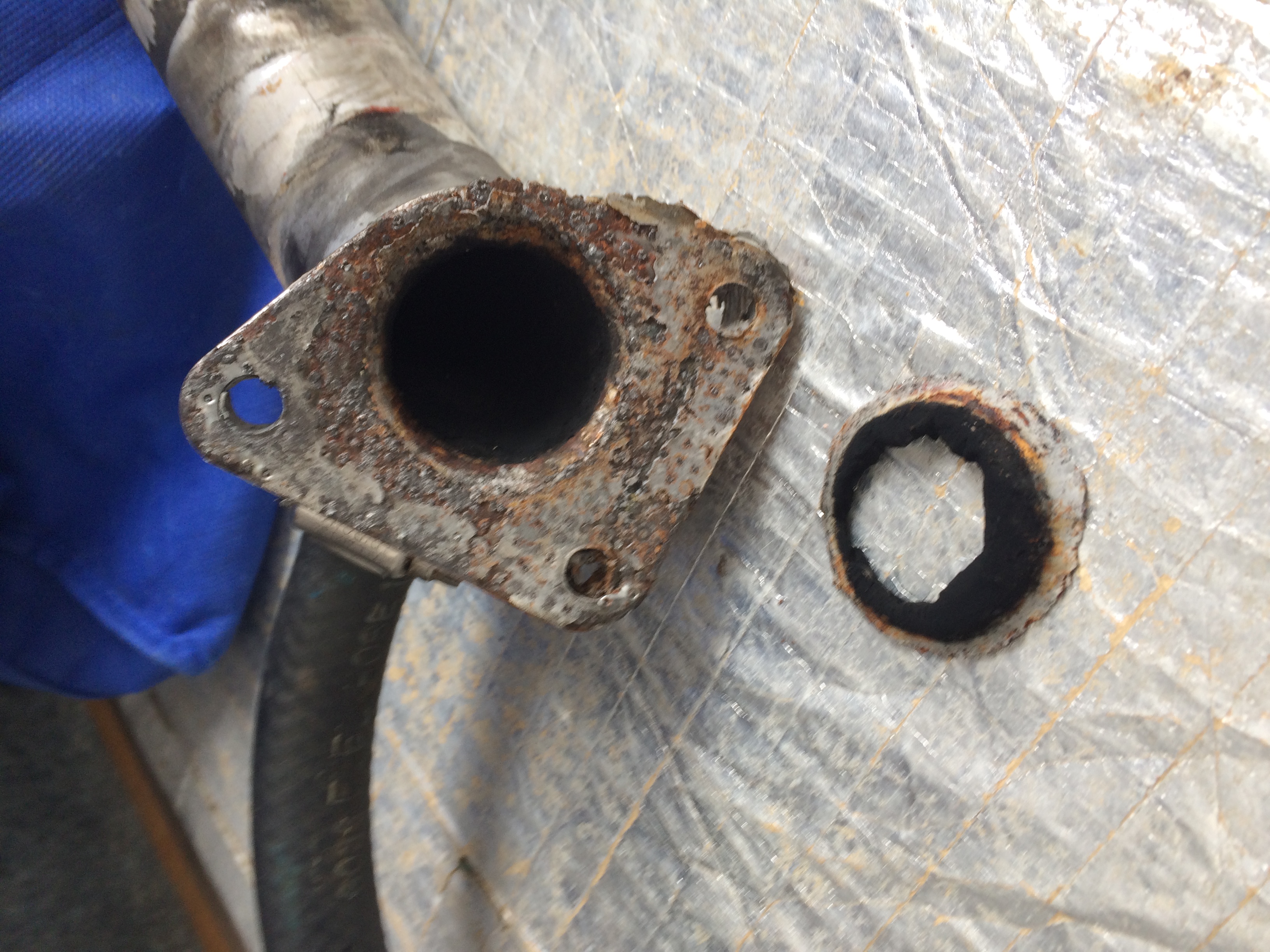

Fault finding. Lots of good info on various yachting forums. Checked that seacock open, water flowing into the strainer. All okay. Yanmar maintenance manual suggested the impeller, thermostat and mixing elbow could be the problem. So started with the impeller - okay. Thermostat - removed; inspected and looked okay. Mixing elbow - removed and took to Minards Yanmar Newcastle where a very helpful mechanic inspected and recommended I replace it due to pitting.

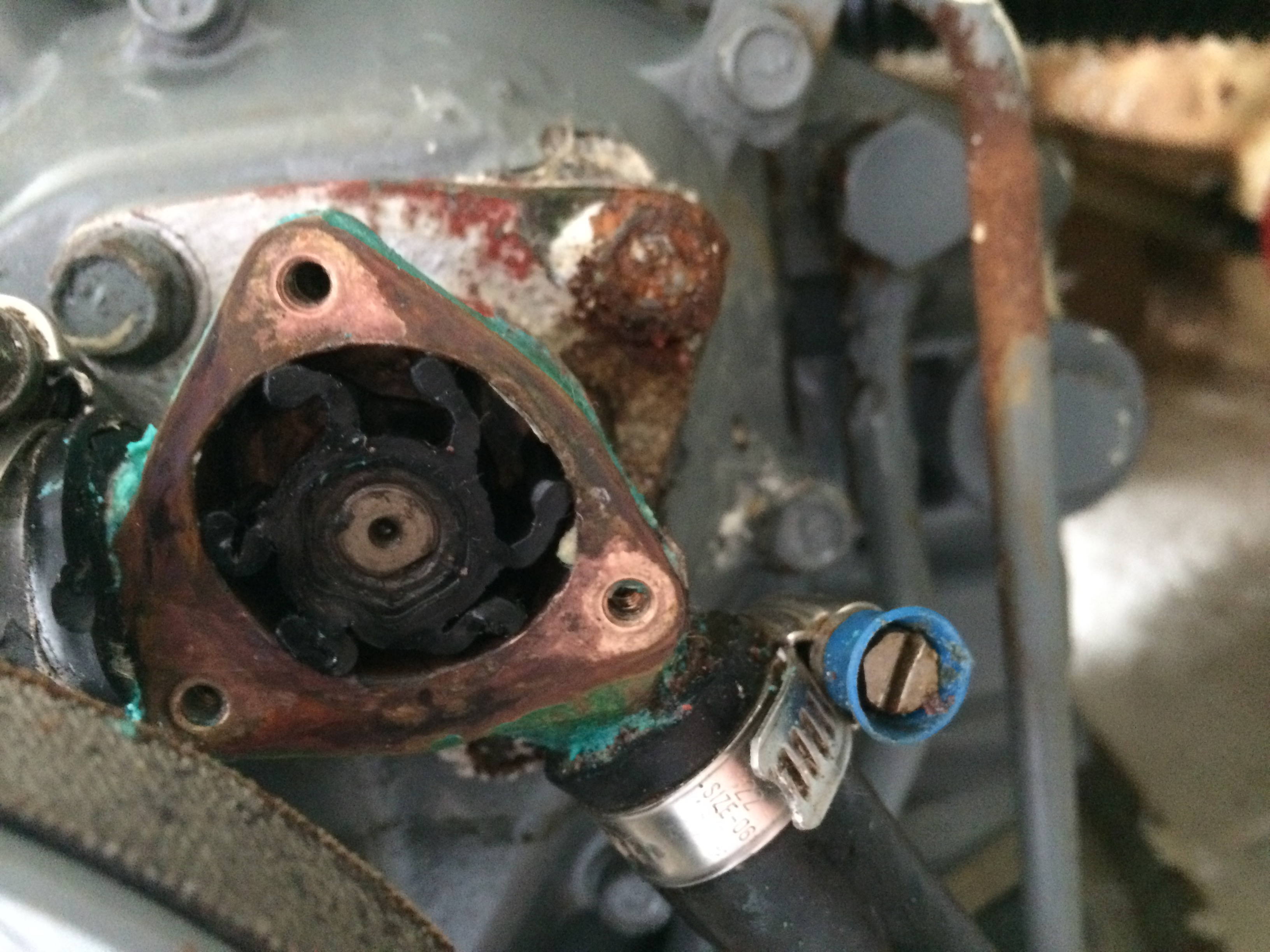

Removed and replaced the parts - the anode was almost non existent. YouTube was definitely my friend with videos on mixing elbow, impeller and anode. By chance, I removed a small rubber hose from the water pump to the engine block inlet. On inspection, I found a salt build up in both ends that would have significantly reduced the water flow and I believe was the prime cause of the overheat problem. Once cleaned and reassembled, did a test run and found excessive water leaking from weep holes of water pump body. Further research indicated that worn seals in the pump were the likely culprit. Back to Minards and picked up a set of seals (2 of) and bearings (2 of). Reasonably easy process to remove and replace with help of video. Refitted and another test run. All good.

Mixing elbow with carbon buildup
Impeller
