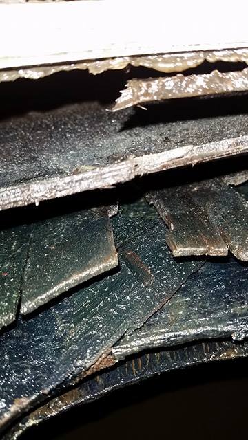

After recently purchasing Galini which appears to be in good condition minus a few cosmetical things, i decided to take a look at the water tank which was decommisioned a few owners ago, and was stuck when i inspected the boat. When i managed to get it open with the careful use of a hammer, i located a thick pile of rotting wood hanging from the top of the tank, along with what looks like a bit of fungus/mold and a bad smell. It appears that there could have originally been plywood under the fiberglass cabin floor, but it has fully delaminated and is only hanging on.
Does anyone have experience with this sort of problem, or know if there is any structural concern? It appears the wood is simply a liner for the water tank, but i could be wrong.

Ben,
Yes the floors are all plywood and as such after all this time some are likely to start collapsing.
Suggest if you want to restore the water tank you strip out all the ply and replace it. {The new one will last for 40 odd years :shock: }
Suggest you use the West System [plenty of links online] to protect the new plywood.
You will have to replace the fibreglass floor as you you need to remove it to replace the plywood.
Nothing in the water tank itself is structural [except the fibreglass hull of course].
You will probably have to replace the water tank rear bulkhead as well.
I would from what I can see in your photo.

Thank you Phillip, i will likely replace the plywood early next year after completion of this years trip as there is no rush if not structural, but would be nice to get that space back as opposed to a water bladder.
Is it just the floor and rear bulkhead which is plywood, or would i also be looking at some pieces for the side and bottom of the tank?

Should be just the floor and bulkhead.
Don't forget to use the West system to impregnate the timber to preserve it.
