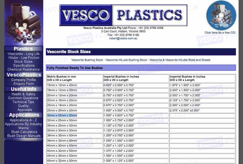

Postby Sailtime » Fri Nov 17, 2017 8:26 pm
Hi Micheal - I was having a look as well.. these from Vesco plastics seem the right size?

Postby Iluka82 » Fri Nov 17, 2017 10:48 pm
Just had a look at the invoice for the bushes I bought and the size was imperial 1.25x1x2 inches (ODxIDxL) I had to cut the OD down to about 30mm. The ID was perfect for my MK1 rudder post.
