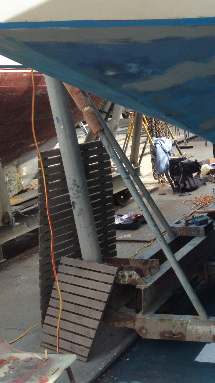

Iluka has a wooden deck insert that gives about 100mm hight to the floor. I've found this is enough to keep the cockpit dry in most (not all) cases. The deck comes apart in 2 peices to make it easy to remove.
Nick

Cheers Nick. Yeah that'd do the trick. Custom build or bought? Any pics/specs?

Postby Iluka82 » Sun Oct 16, 2016 9:32 pm
They were custom built by the previous owner. I found a photo of the inserts when they were out of the boat to be painted. There are 2 pieces that meet where the tiller goes through the floor.
Cockpit floor inserts
