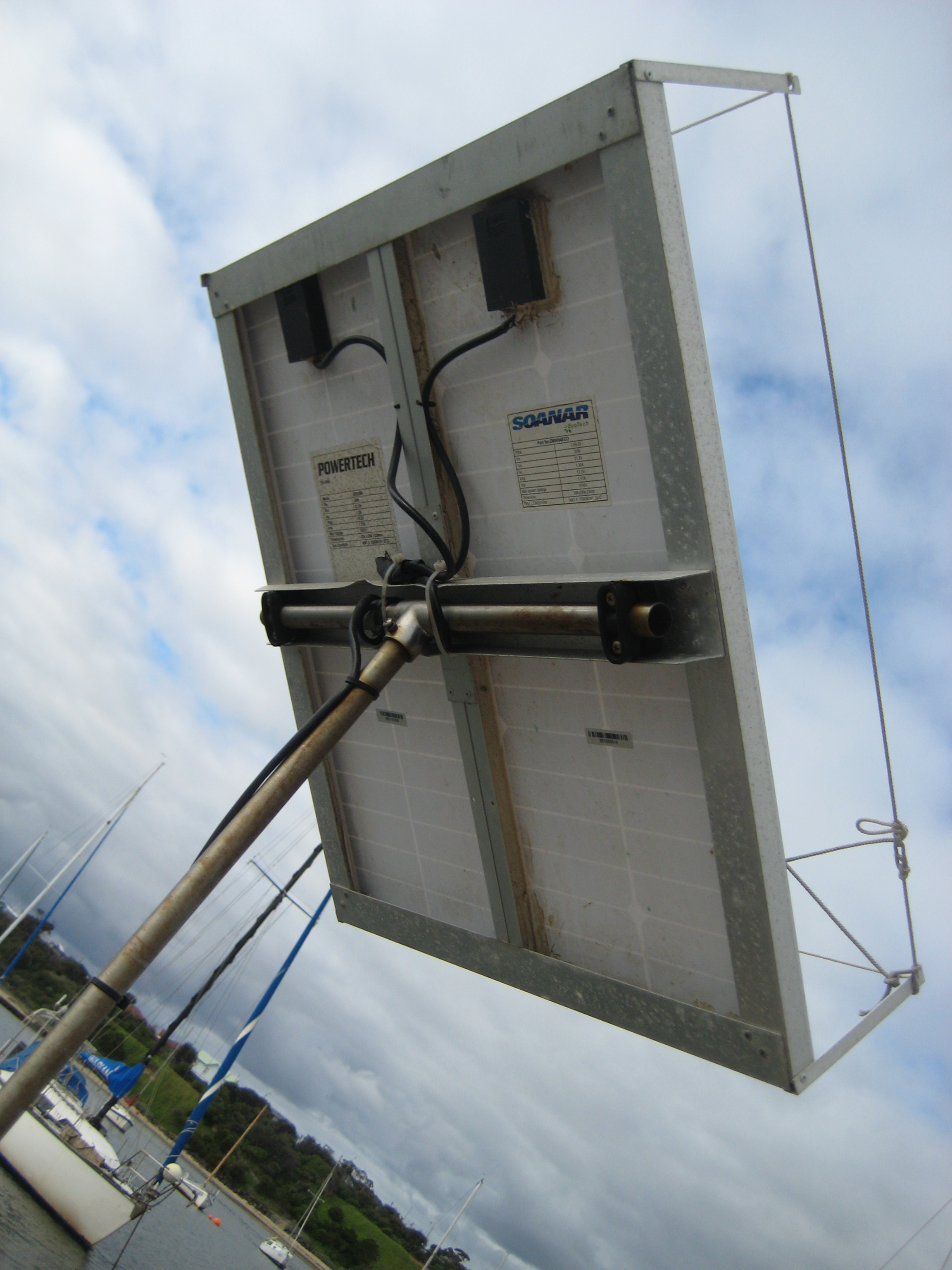

I have 3 x 20W panels on a Tee-shaped pole which I had welded up out of 38mm SS tube, fixed to the pushpit. Also a 5W panel for the starter battery. It works well for longer cruises, including using a tillerpilot. But I don't have a fridge.
My panels are a few years old, but you could probably get an 80W panel these days that wouldn't be much bigger or heavier than mine.
Cheers, Graeme

Postby lockie » Sat Sep 03, 2016 6:58 pm
I made up a frame out of pop-riveted aluminium angle, and fixed it to the top of the tee-frame using rail mounts from Whitworths. Easy, cost peanuts.

Postby lockie » Sat Sep 10, 2016 5:03 pm
Here you go. This is Shakti's old setup with 2 x 20W panels on a 25mm tee-pole. She now has 3 x 20W plus the 5W panel on a 32mm welded tee-pole. Plus a 4G antenna for mobile/internet coverage. The pole is attached to the pushpit with a U-bolt and sits on a butchered SS fitting which provides a mounting foot. It is easy to rotate and tilt for max power.
Cheers, Graeme
