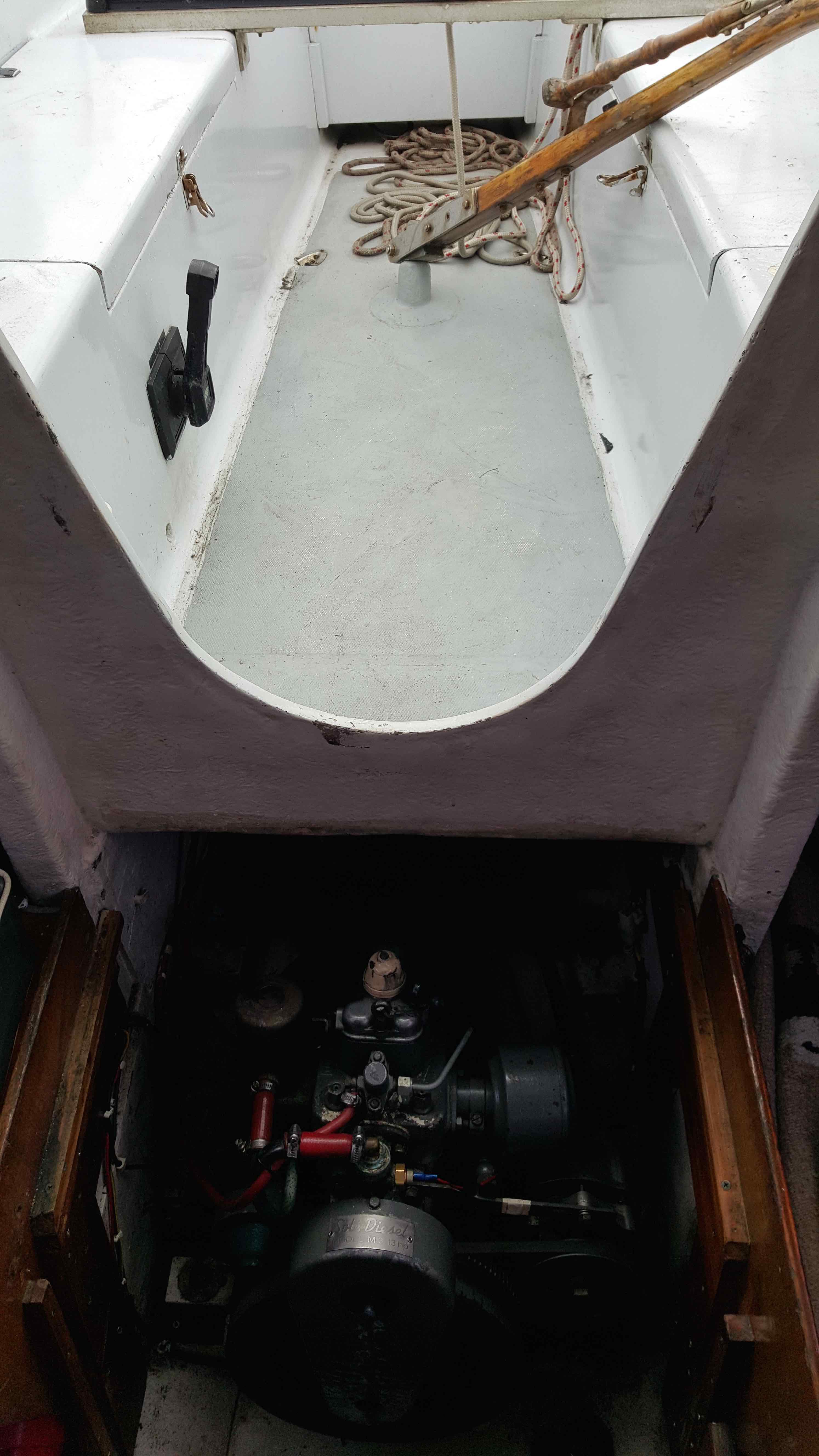

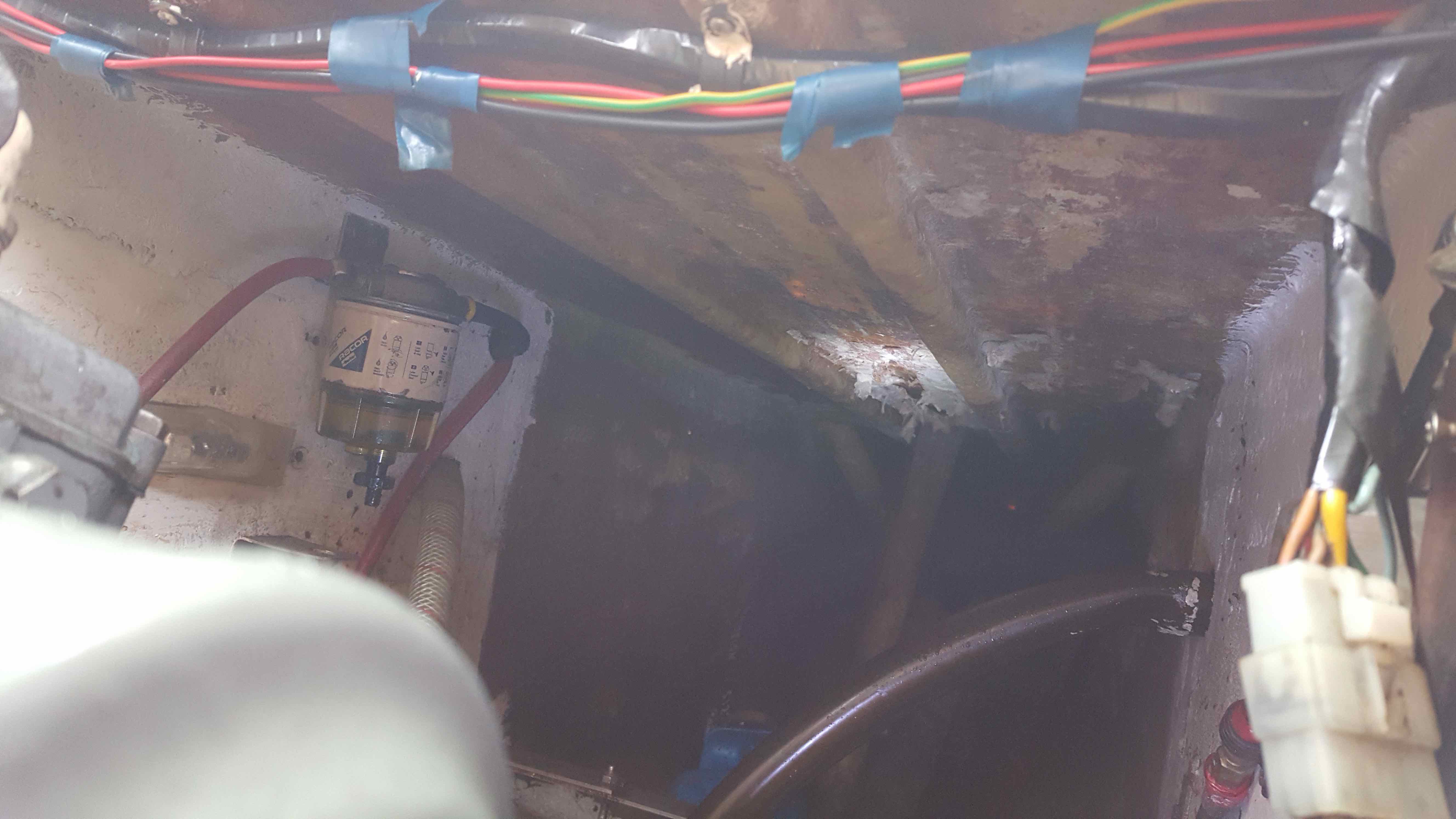

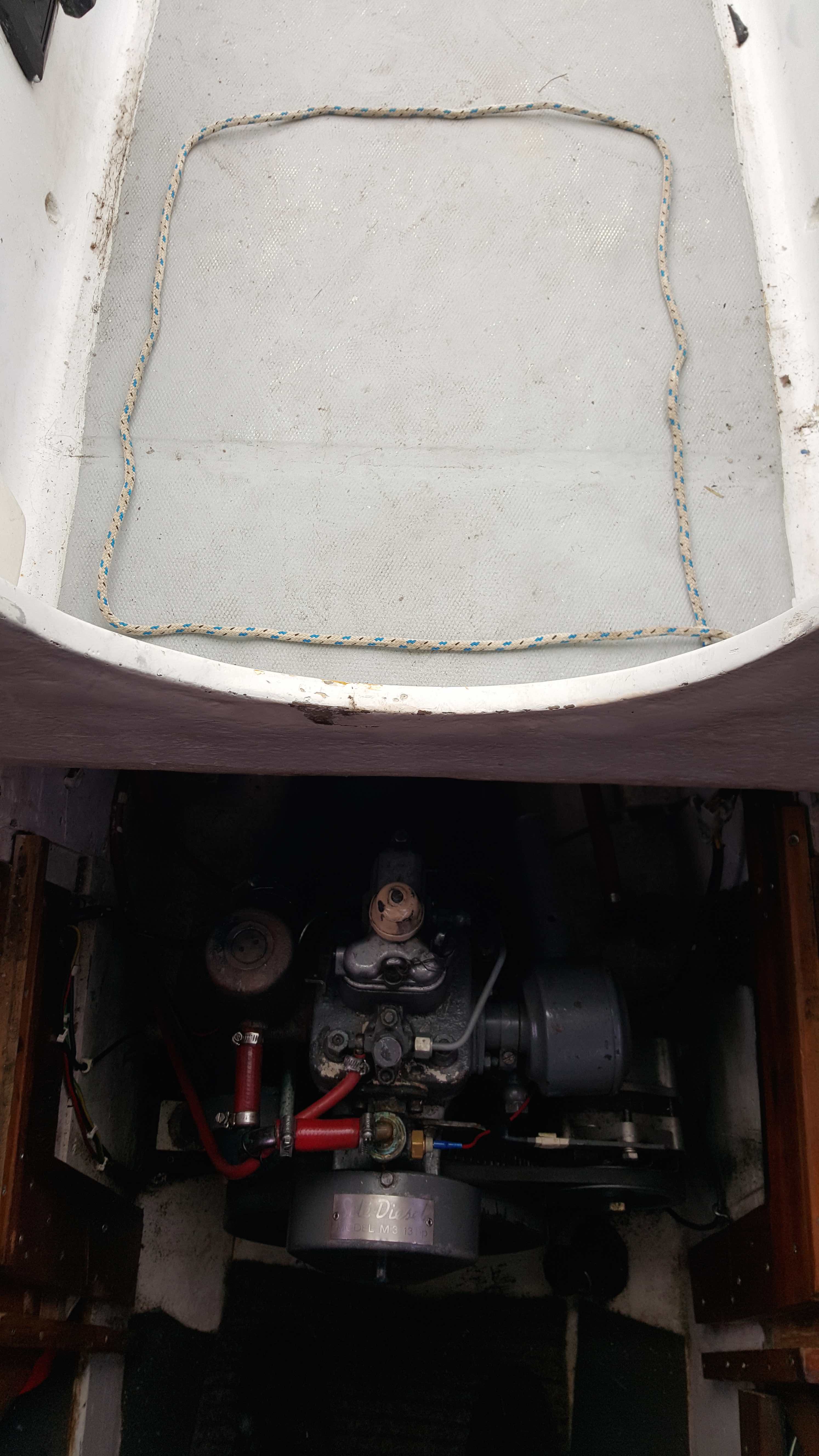

my engine is shoe horned into the back of the boat.. to access the water pump or shaft means squeezing full out over the engine
I've seen someone else with a cockpit hatch. would anyone recommend against doing it?
how would you do it?
heres some photos of the situation.. i'm thinking only a 35cm hatch would be required..

I have a round Nairn inspection opening https://www.whitworths.com.au/main_item ... olutePage= positioned to the aft end of that roped rectangle area you marked out.
Its 200mm wide, right above the stern gland, its not really very practical & is only useful for one-handed tasks, there would be better solutions i'm sure, like a larger rectangle cut-out like you showed. But the round inspection opening would certainly be easier to install.

My motor is in the same position Shea, but the water pump is on the front.
Consider how many times you may access the pump before cutting any holes.
I also think the area you show is too big. Better to just have a rectangular [bow stern long side] opening in the centre.
Reasoning for this is that around 5 knots you will get water into the cockpit via the lower cockpit drain.
It also means you will only cut one support to the deck of the cockpit. You can see the three of them in your photo.
Consider what you put in as you may stub your toes on it.

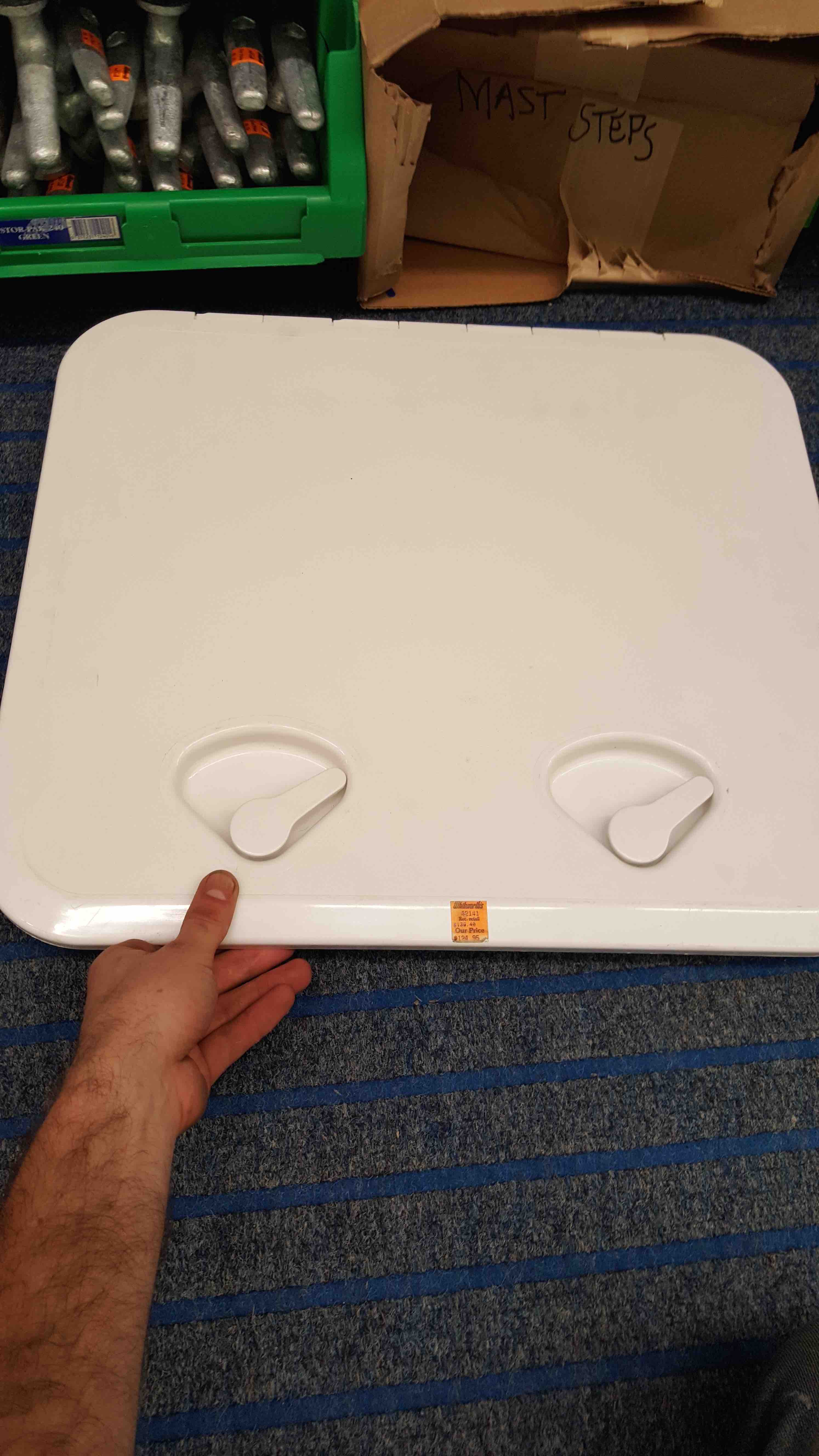

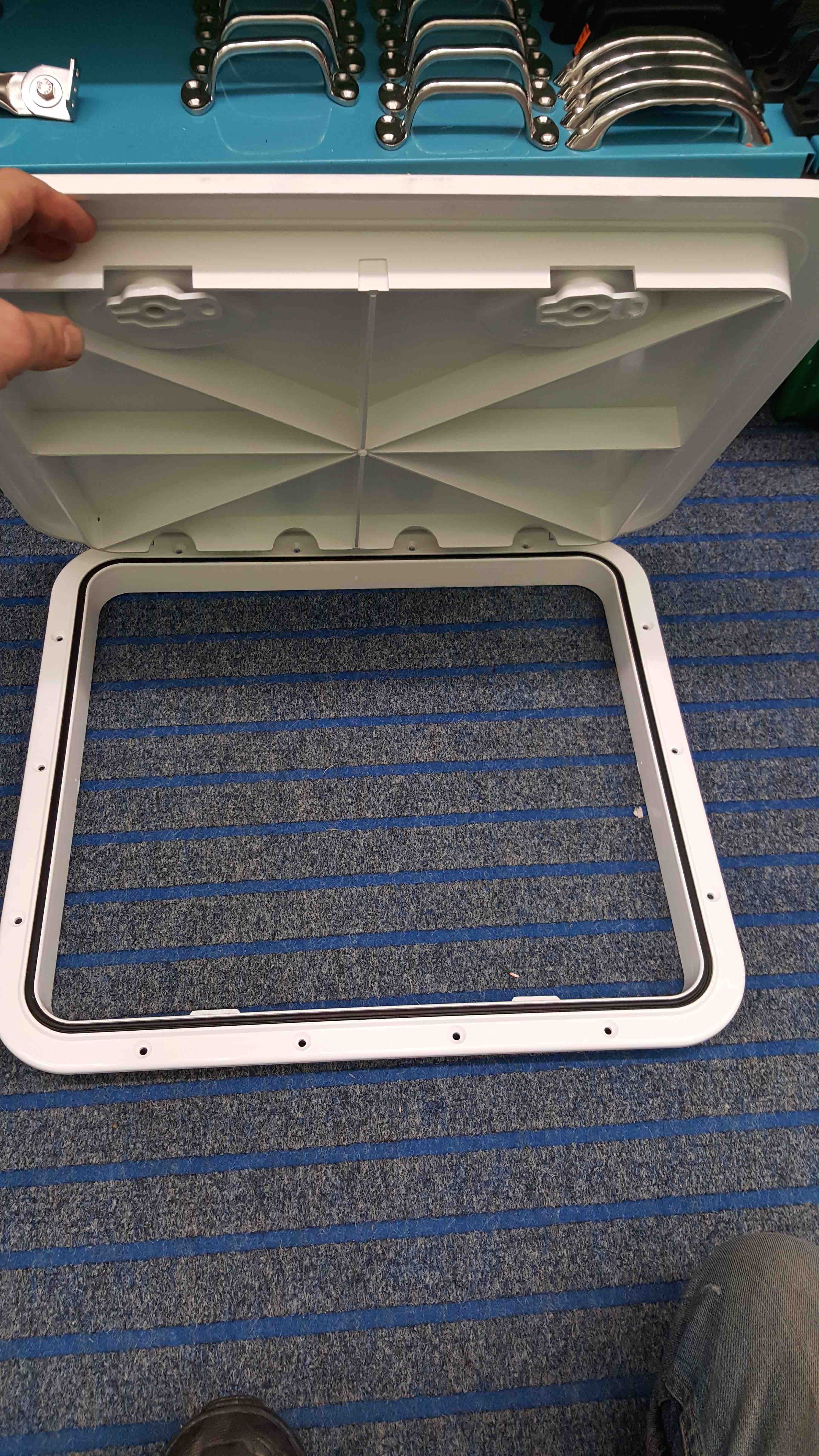

found this today at whitworths.. it's about 40x40cm.. pricey though.. 120 bucks..
i'm jealous of your access but nervous i'd create more problems if i cut into the floor so i'm giving the idea away.. a friendly bystander was talking me into it today on the dock.. sounded easy at the time..

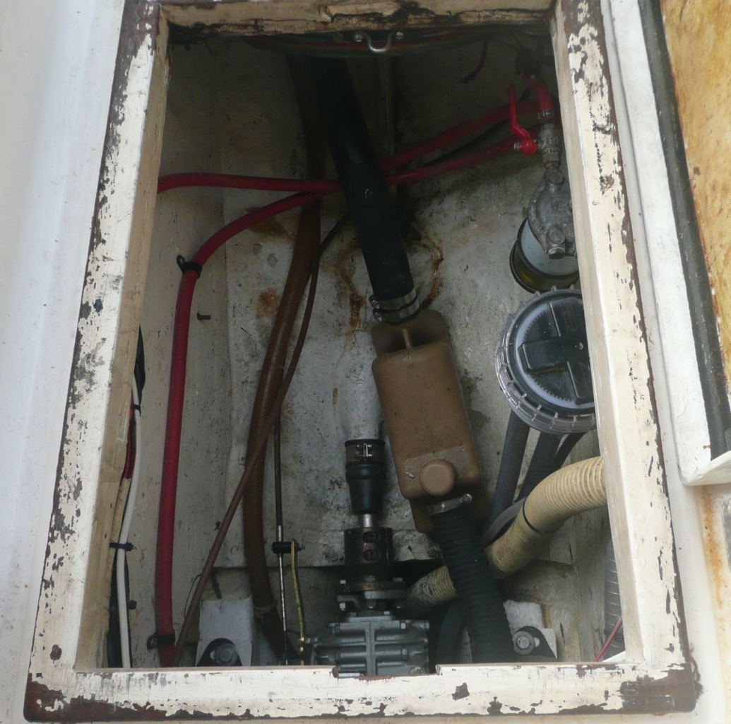

Postby Dolphin » Thu Jul 21, 2016 9:18 am
gallery/image.php?album_id=10&image_id=125
Gday Shea,
Hopefully here is a link to the photo in the gallery showing the access hatch in the cockpit sole. It was installed by the previous owner when he got the wheel steering installed. Diesel mechanics like working on it as it gives great access to the stern gland etc.
A removeable bulkhead next to the quarterberth seems like a better option, and a more common one.
