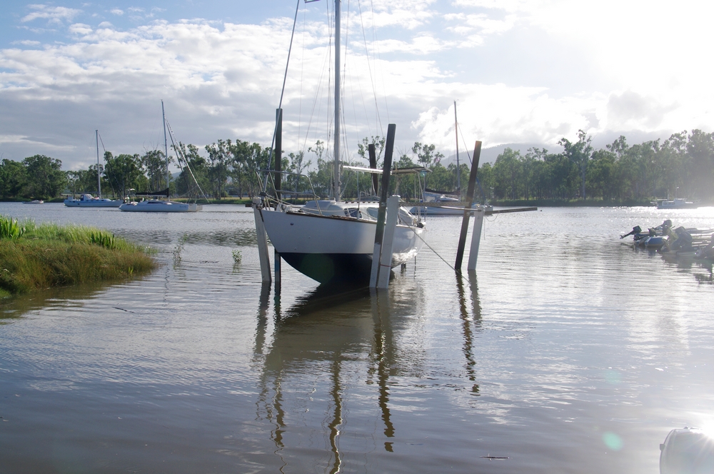

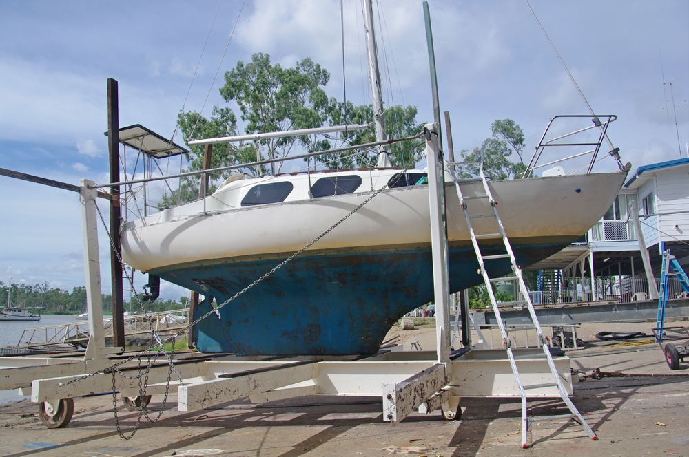

Windchaser was on the slip for 12 days not counting the morning she went back in. Managed to get some of my to-do list completed.

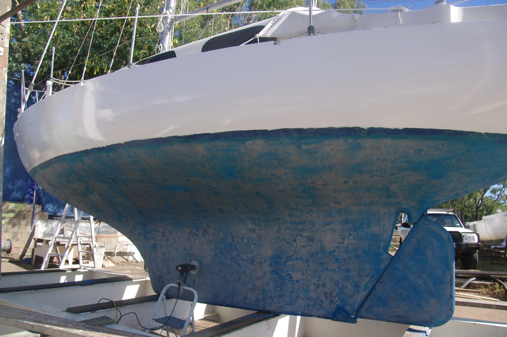

Most of the this side has been sanded with the initial 80 grit.
slip 01.jpg (584.61 KiB) Viewed 5847 times

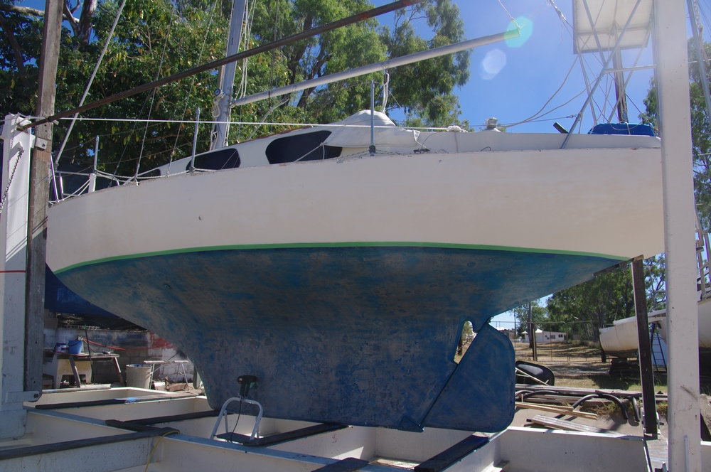

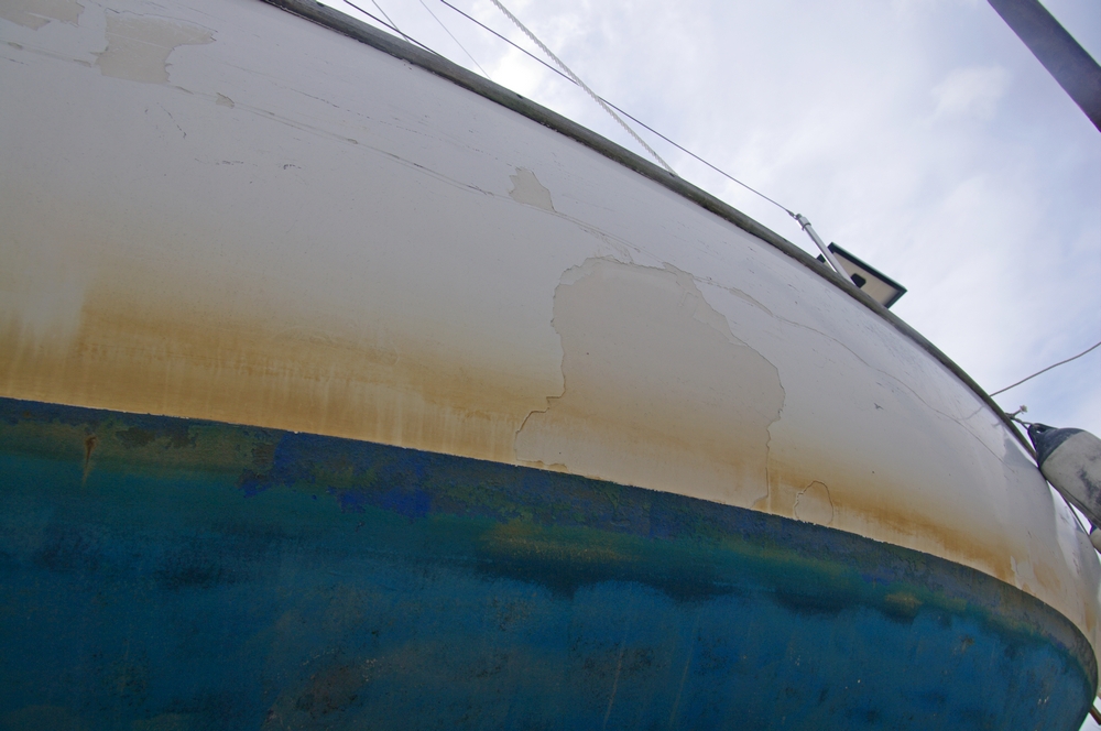

Sanded and painted the topsides. Old paint coming off.
slip 02.jpg (442.92 KiB) Viewed 5847 times
Took a week to sand as I wanted to remove the remains of the old coat which was falling off. Used 40 grit, 80 grit, 120 grit.

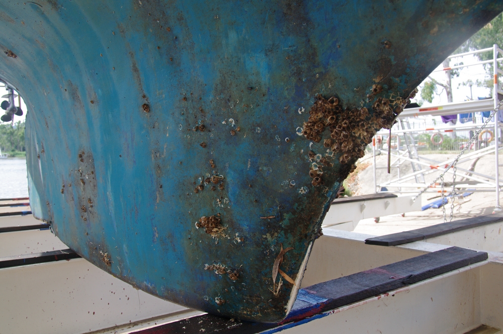

Antifouled. Initial pressure wash was followed by a round with the chisel to remove some barnacles. Only one year since antifouled so should not have been barnacles. However, I spent weeks on anchor down river and had problems with Windchaser sailing on anchor and tangling the anchor rope around the keel. The rope would come up with antifoul on it so I knew it was rubbing off the protection. So, no surprise there were some barnacles.

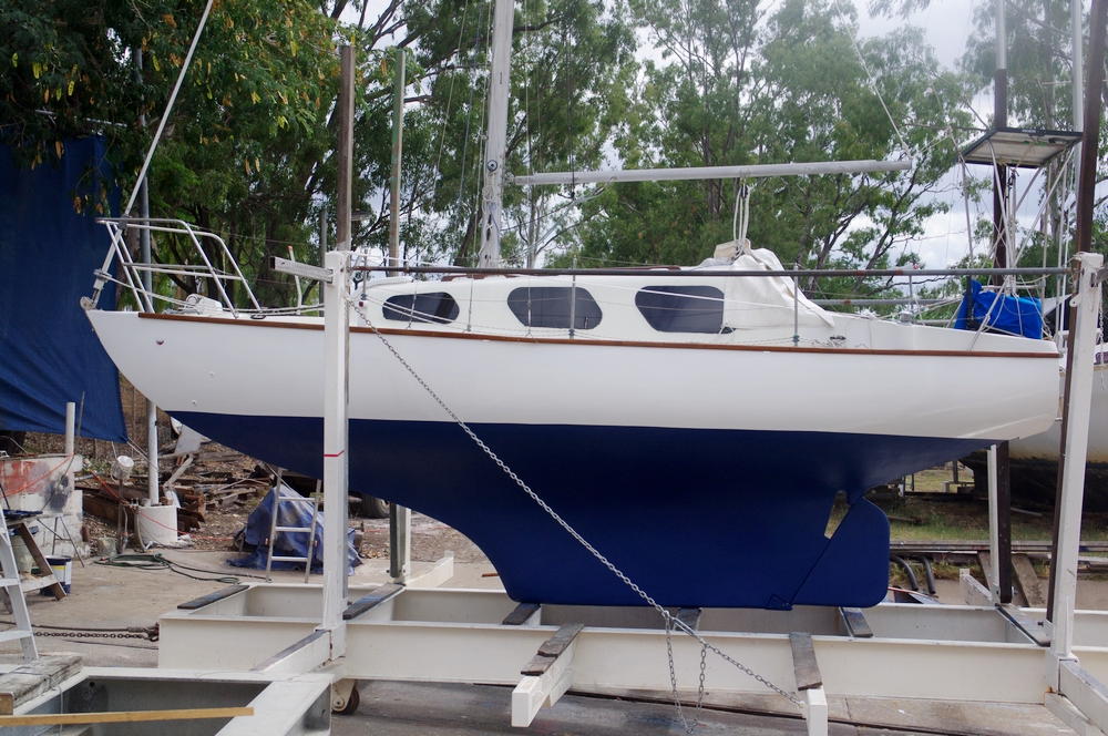

Used International paints Coppercoat which is going off the market. The paint place had one lonely tin sitting there and they offered it to me at less than half price. Used Altec 5 last year and other years used International Awlcraft. Did two coats from the 4 litres. The first coat used a little more than 1/2 the tin so I added a bit of mineral turps (tested first to make sure it would work as a thinner) and it did the second coat no problems. Antifoul companies have their own thinners, however, I have never had any problems using a little mineral turps in previous years with Awlcraft. Any thinners with antifoul should be used very sparingly, not like one chap I know who keeps adding it so the paint is thin and easy to apply. I find a little thinner gives me a more consistent thickness of coverage instead of thick and thin sections which take ages to try and roll to a consistent finish. In this case, the thinner allowed me to do the second coat without excessive rolling.

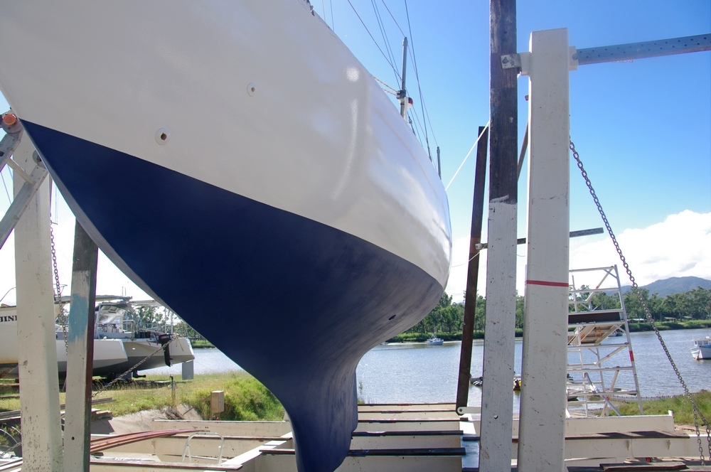

Overall, the topsides paint job looks fantastic and I know the antifoul will do a good job.
