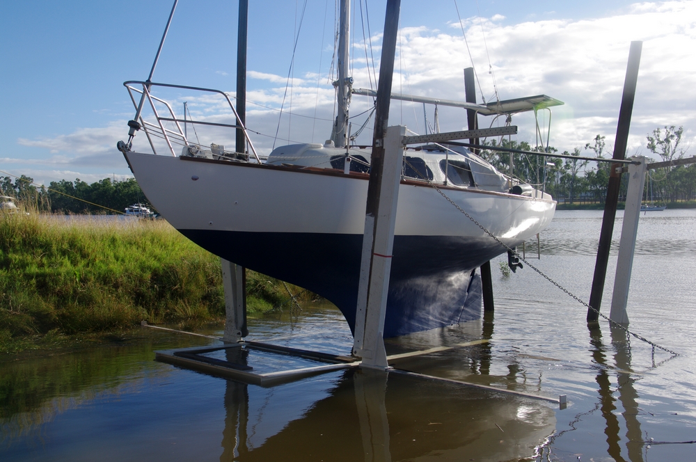

Windchaser went back in this morning. Didn't think there would be enough tide height but Les the slip expert thought there might be. He was right.
The trolley actually stopped rolling several times. Les just got the crowbar out and we used it to lever the trolley and it started rolling again. Thankfully when it stopped out in the water, Les pulled the trolley up a metre and let it roll down again. Several times of this and the trolley kept going.

Overall, I am happy with what I managed to achieve. The hairline crack under the keel is repaired and I am very pleased with how it turned out. Would have like to get more jobs done but then, there is always next time on the slip.
