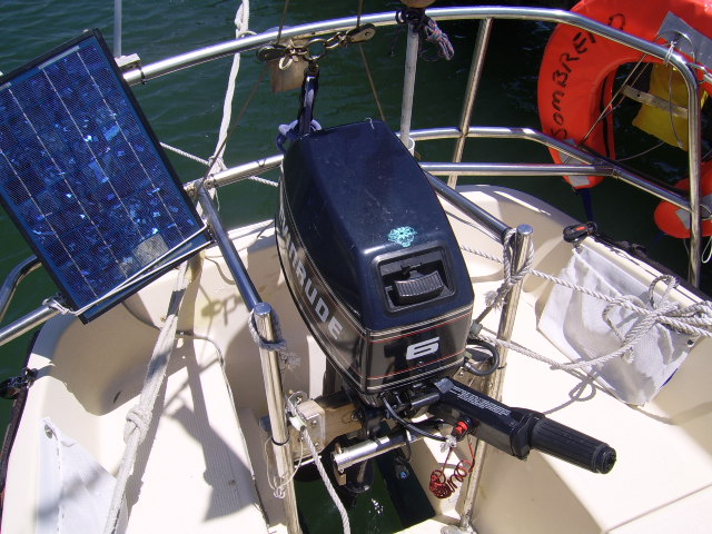

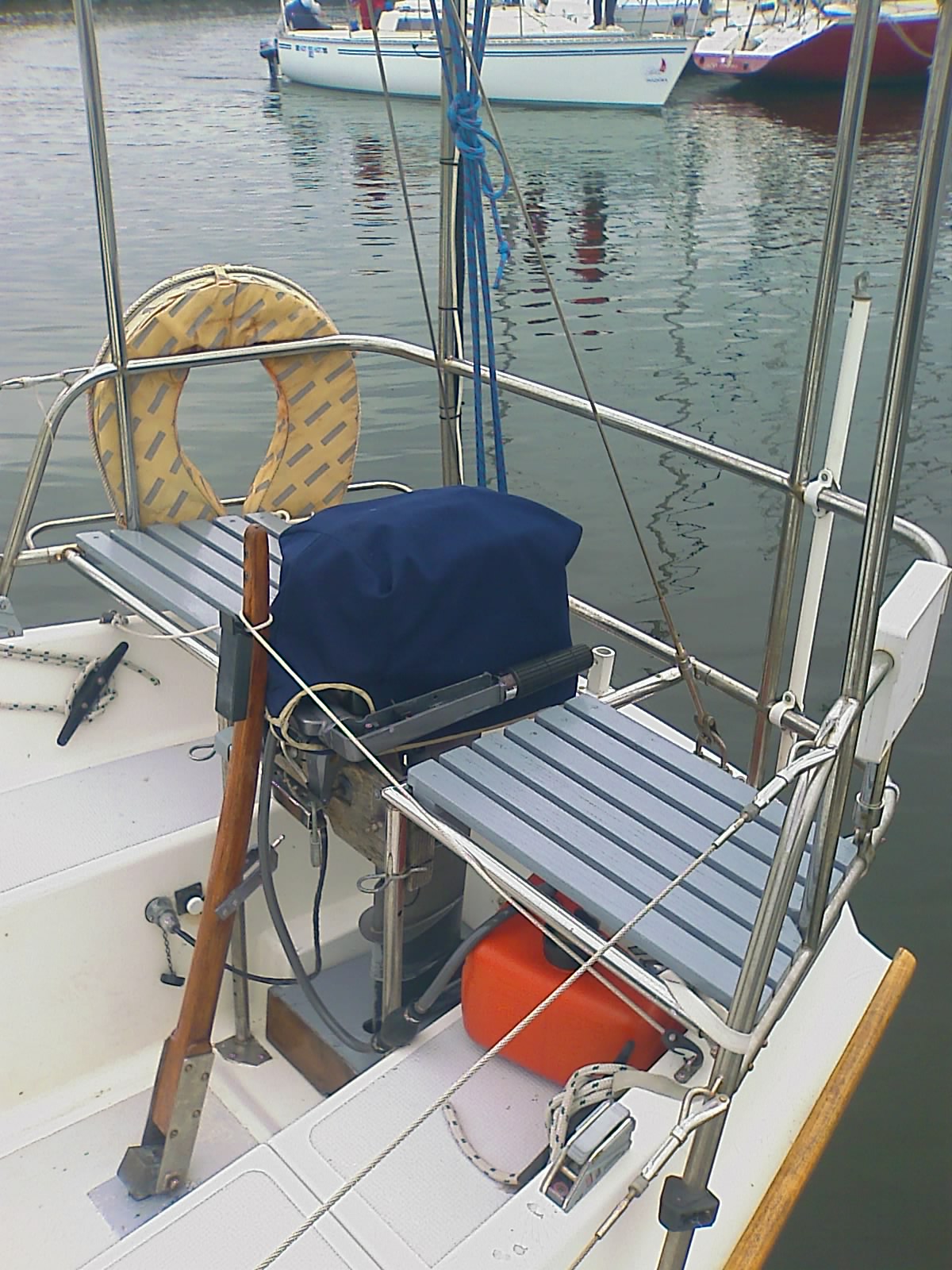

Bonnie Lass and Sombrero both have motor lifting slides which work very well.
Bonnie Lass.jpg (357.16 KiB) Viewed 10479 times
