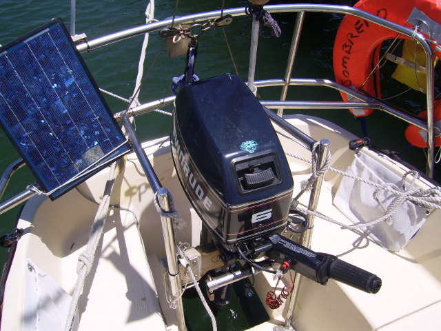

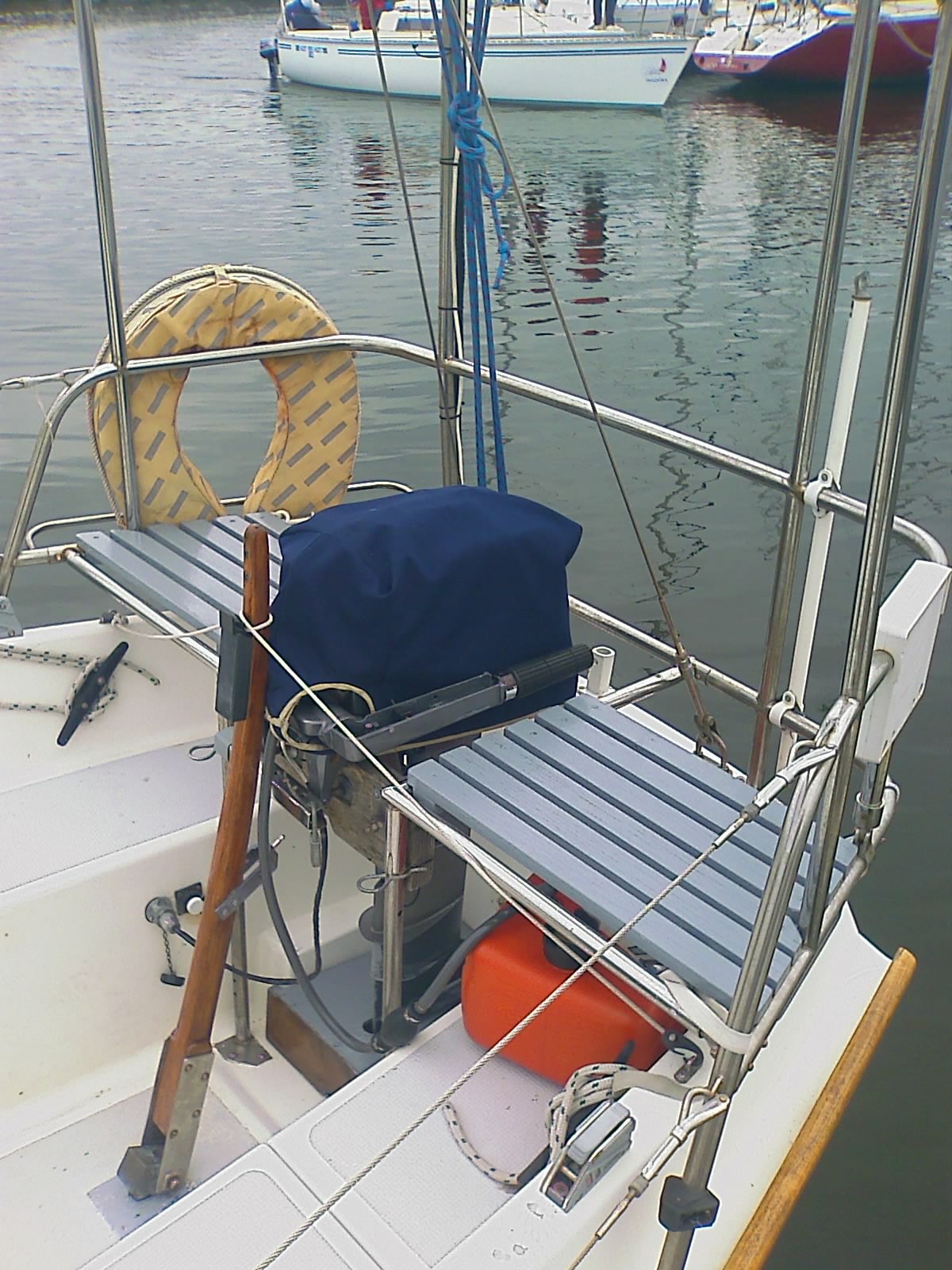

Postby Tales » Mon Apr 11, 2016 10:22 pm
Hi Rob,
Bonnie Lass and Sombrero both have motor lifting slides which work very well.
