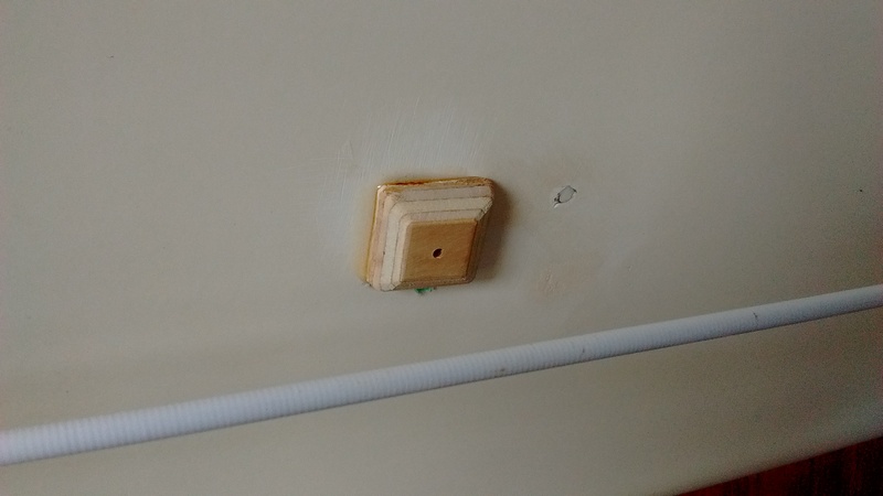

The area around my windows has various holes probably from several sets of past curtain holders. I didn't trust the lining to just sink a screw into it so I epoxy glued shaped pieces of ply. Used stainless steel screws to hold the stretchy wire in place (that white covered stuff). Used a glued bit of ply and cup hook in the middle of the run of wire to give more support.

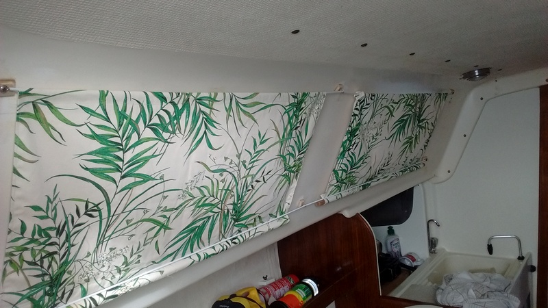

Sewed up some old backed curtain fabric. Did a quick trip out to Windchaser to do a test fit. Apart from one dowel that goes in the hem at the bottom not sliding all the way through from my crooked sewing, I am very happy with them.
A mistake I made was to not allow enough overlap. I used too much material when I hemmed the top then I changed from thin dowel to thicker and found I did not have enough drop in the material. Had to sew on strips so I could get the thicker dowel hemmed.
Now I have reasonably neat curtains that roll up like blinds. When I put them up I could feel immediately how much heat they were keeping out. Still some minor things to do to finish them off but overall I am really happy about them.
