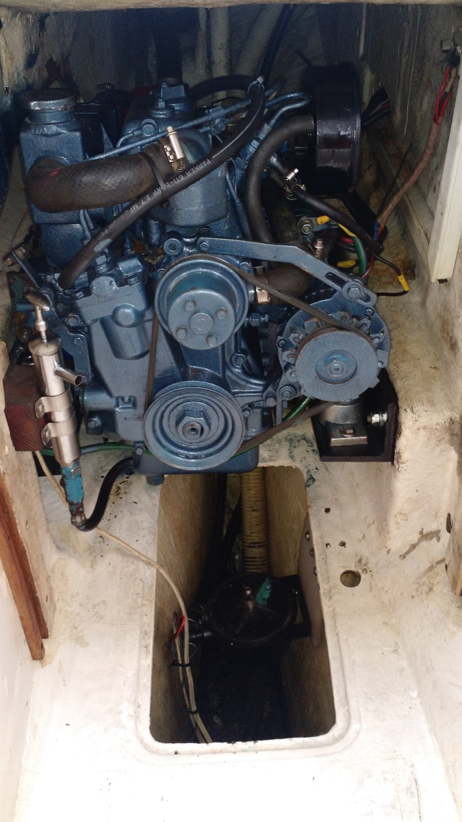

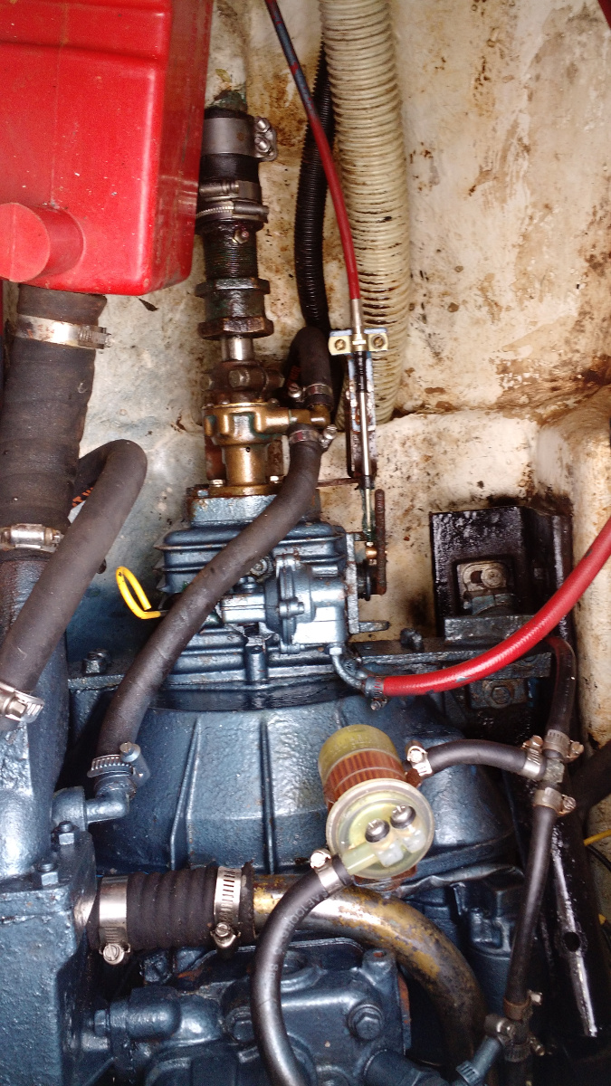

Well I have accepted Galini back from the engineers after the work was finished on repairing her engine - my wallet is much lighter but she is in good mechanical condition. The photos are attached.

- Slipping: she is overdue for slipping and the engineer told me she will probably need her skeg nut realigned after the issues with the engine. She should probably also be soda blasted

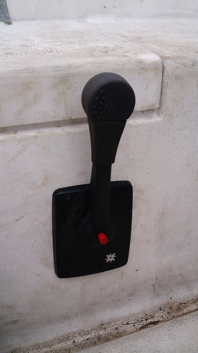

- Deck: The deck is in need of some TLC. As you can see from the photo of the throttle leaver, the deck is in a pretty poor state and needs some work.
I'm sure I will learn lots as we progress forward....Galini was always intended to be a learning experience for me, originally at sea, but I will learn many things from her before we part company I have no doubt.
Anyway, I'd love peoples opinions on the best way to clean the deck. What you can see in the throttle picture is indicative of the whole cockpit - the fwd deck is a little better but still needs work. The mechanic suggested she had probably been painted, and that I should attack her with JIF. Would the assembled masses agree? Do I clean her with JIF then repaint her?

Your motor is looking good!

With deck cleaning, when I went to paint bits and pieces (done all the cockpit), I first went over with an orbital sander with about 100 grit. That got the big flat smooth areas out of the way. Then hand sanded with 100 grit on a hard foam rubber pad which flexed a bit for curves. Just the sandpaper no block for the corners. I find wet and dry worked wet was best. Did the repairs where there were chips or cracks. Sanded the repairs and used two pack paints on a small roller.
For preparing the non-slip surfaces in the cockpit and elsewhere, the orange abrasive-string wheel is what I found useful:
If left in one spot I found it would chew too much away but if moved back and forth and change the angle 90 degrees, it would clean up the non-slip bumps quite well although it does make them a tad flatter. But then, when new paint goes on it tends to fill the hollows a bit more than the crests so it gets flatter still. Despite that, with my surfaces it was still non slip once repainted.
Thanks for the advice Troppo. Did you just paint the deck or is there a gloss/epoxy/something to put over the paint to protect it and keep it clean(ish)? And I suppose another question I should ask, what paint did you use?

I used two pack Aquacote as that is what I was using inside the cabin and had it on hand. http://boatcraft.com.au/Shop/index.php?main_page=index&cPath=5_38.
Aquacote is water based epoxy, seems thinner than another two pack paint I once used so a few coats is good. Dries quickly, have to be careful not to use it on hot dry days. As with other two pack paints, over two weeks the paint hardens up considerable.
I used Aquacote inside the cabin as low fumes, I found it easy to mix and apply. Easy to mix a small amount to do repairs. I don't know how it compares with other paints as far as stain resistance goes, noticed it has got stains in various places inside the cabin.
There's an undercoat/primer same sort of thing which is a bit thicker. Good for giving a solid light colour for a base for the top coats as then need less top coat to given an even colour. Don't have to use the undercoat/primer, Aquacote top coat goes straight over prepared fibreglass and epoxy repairs. I just used it straight onto the prepared non-slip surfaces as it defeats the purpose of non-slip to put high-build primer over the grippy surface. Fills up the indentations.
Nothing goes on top of the Aquacote. The finish is not a full gloss. Some people use various polishing stuff to rub it up to a full gloss. I never have.
