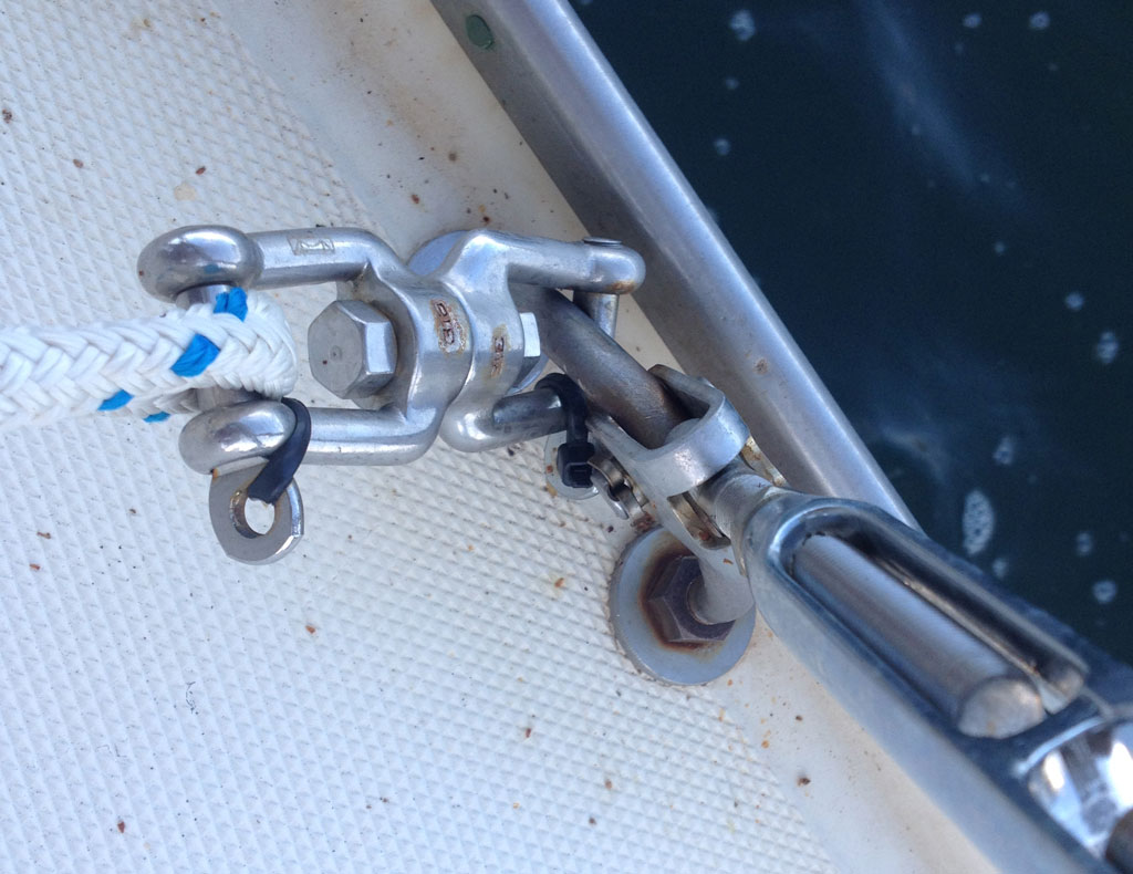

Swivel attachment at the Port rear lower shroud fixing.

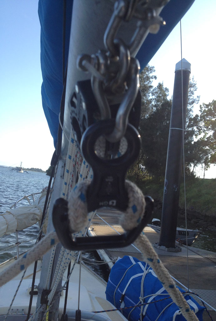

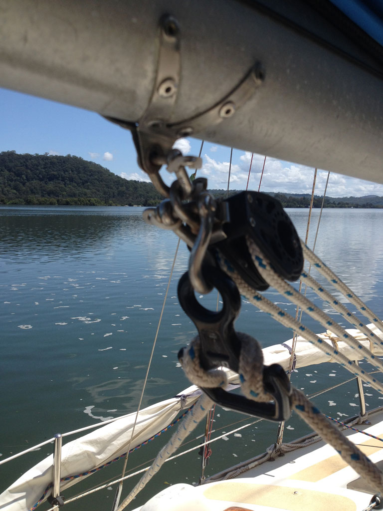

Figure 8 at the Boom. Shackled to the Vang loop.

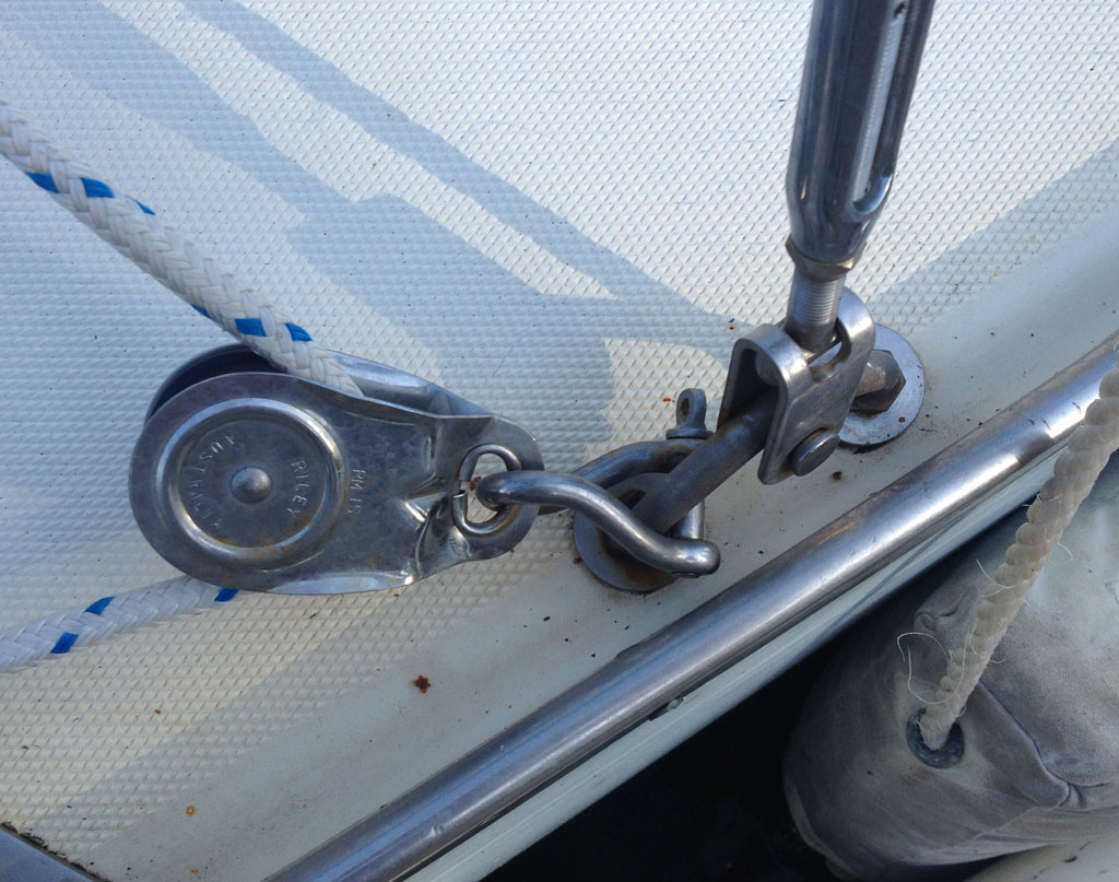

Pulley Block attachment at the Starboard rear lower shroud fixing.

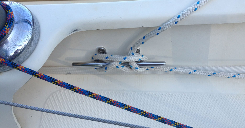

Cleat position.

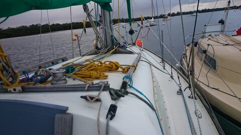

I have no experience with the gybe control devices you asked about, but I use a gybe preventer arrangement which may be of interest. On each side I run a line from the boom (at the vang attachment point) to the shroud chainplate U bolt and then to a cleat on the cabin roof. In the attached photo the line is hidden behind the handrail on the cabin top and comes to the black Spinlock PXR cleat in the foreground. The lines are permanently rigged so can quickly be locked and released.
In the event of a gybe, the arrangement allows the boom to move to above the lifelines but not sweep the cockpit. It is useful when sailing downwind, both as a safety device but also allowing you to get the boat back on the original tack, after a lapse of concentration, without the mainsail gybing. The gybe control devices will not do this as they allow the mainsail to gybe, albeit under control.
