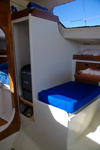

The Waeco 23 litre fridge is very thin and by trimming back the edges of the hanging cupboard, I can just slip it in. My Top Hat layout has the cupboard to hang stuff in instead of the slightly bigger cupboard which the other model has with a toilet. A removable lip in front stops it sliding out. It would not stop the fridge falling out in a roll over but I could put in more restraints higher up if I do some trips out past the coastal fringes.
Originally, I planned to put in a slide to make access easier and make better use of the space but have not got that far yet. The temp readout is actually at the back of the unit so that is a bit awkward. At the back left side of the cupboard, I have cut a hole right where the fan draws in air so it can suck in fresh air easily. Hole is under the top of the v-berth so not visible in v-berth.
Wiring comes up from the battery under the cockpit section and along the PORT side of the boat, then underneath the v-berth just in front of v-berth entrance and back to the fridge. Wiring needs to be thick enough to carry the current with little loss. I initially had some intermittent problems with my fridge, it was sometimes kicking in but not running for long before the compressor was stopping. Eventually realised that it was a problem with the voltage dropping too much. While my wiring from fridge to switchbox was fine, I found some of the old system was just up to running a fridge but would cause a problem when fridge was running and I turned on the water pump or whatever. One wire I found in the switch box was way too thin, the other was the wires from the battery to the switch box needed upgrading.
Fridge uses about 13 amp hours a day (tropical winter) to 20 amp hours (warmer weather).

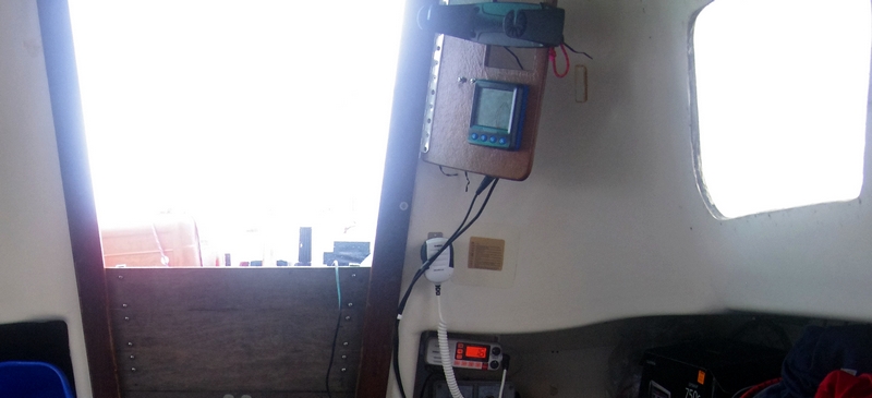

You can see the old system, a swinging board with cutouts. At that time, I used a C-clamp to hold the board in the forward position so I could see it in the cockpit. Don't know what the previous owner used. The top hole held the sounder which I removed. The bracket zipp tied over the top is for the Garmin gps/sounder I bought so I could find my way from the Gold Coast to Rockhampton. Haha, see the radio on? That was before I found the aerial was only shoved in the back, sometimes I got a signal through so at the time of the picture, I still thought it was working and was relying on it for safety. I did wonder why there was not much talk on it.

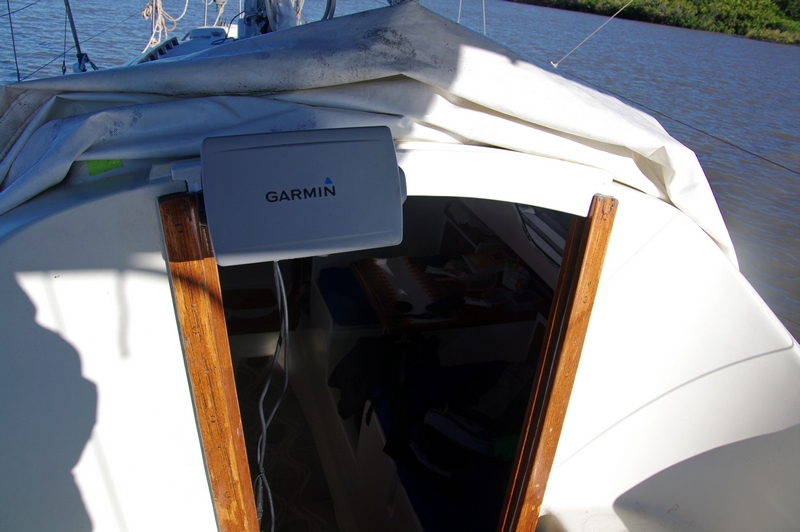

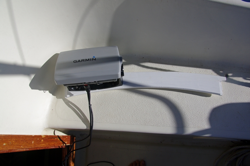

The bracket I ended up deciding to make slides into the top of the washboard slots. Took out the old board on hinge completely.
gps mount 1.jpg (312.46 KiB) Viewed 4149 times
With the previous system, board on a hinge, I found it tricky going into and out of the cabin as it took up a fair bit of room. The board I now use does hang down a little but I have not found it difficult to get past.
gps mount 2.jpg (305.44 KiB) Viewed 4149 times
If Windchaser was knocked down at sea, it is possible the board could jump out, which would be an extra disaster to add to being knocked down. I think it would be better with a latch or pin to secure it. I could easily put in something so I could quickly lash it down on both sides with a few wraps of thin cord.
When anchored, I often leave the board in as I can pull the tarp right over the GPS to protect it from sun. When moored, I take the GPS home and leave the board in the boat. Sometimes at anchor, I take the GPS into the cabin and run it as I am working out passage for the next day or checking on position and depth during the night and don't want to keep going up into the cold cockpit from my warm cabin.
