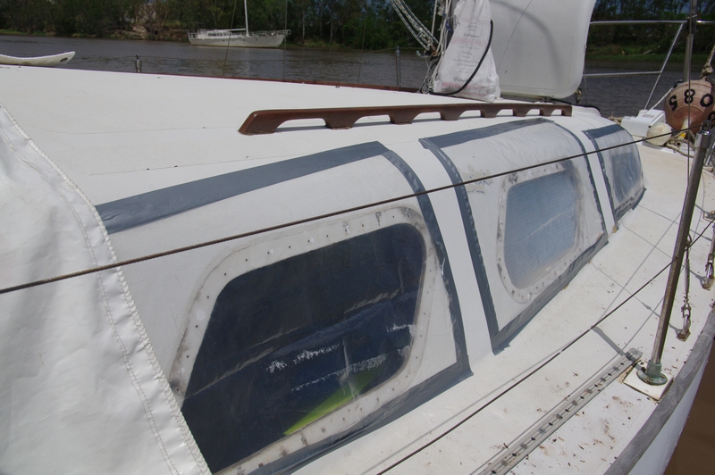

I'm replacing Windchaser's windows. They have been a bit like me, a bit crazed. This summer, I put reflective foil on the inside of the windows as so much heat was coming through with the sun, I wanted to keep it out. However, both the biggest windows developed cracks right down the middle and required masking tape as a temp sealant. I am thinking that with expansion in the sun, they couldn't hold together any longer. Also, I knew the windows were not sealing and with rain leaked in various and mysterious places.

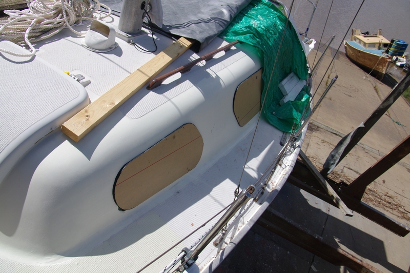

Before coming up on the slip, I removed the windows on one side and took them to the plastic place to inquire about replacements. There was only clear or smokey to choose from in acrylic (perspex) so went for smokey. Was quite cheap, $160 and only took a couple of days. I had covered the windows openings on Windchaser using duct tape and plastic sheet. Had a shower of rain so I was pleased I had done so. Then I realised I had water in the bilge and it could only have come via those windows, so I don't think the duct tape was much good. Plus, it left sticky stuff on the boat which happily came off easily with metho.

Plastic and duct tape, water still got in but kept the swallows out.

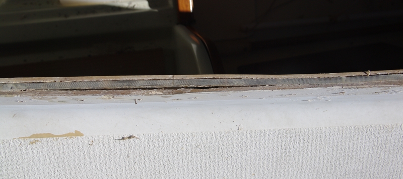

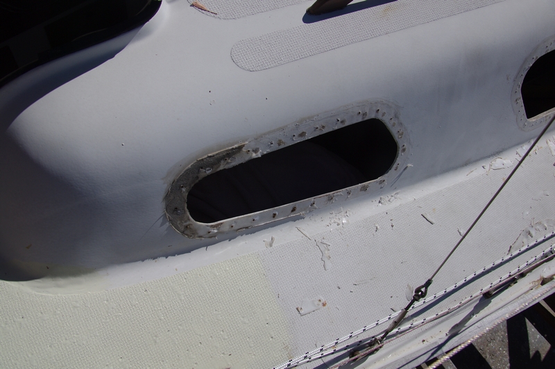

Started repairing the window surrounds. In several places, the layers which showed in the window-cutout were coming apart. Water seeping past the window seals would have been going down these cracks and mysteriously appearing in other places lower down.
Crack between layers in window cut-out
window 4.jpg (244.23 KiB) Viewed 9847 times

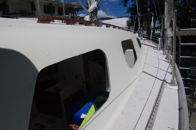

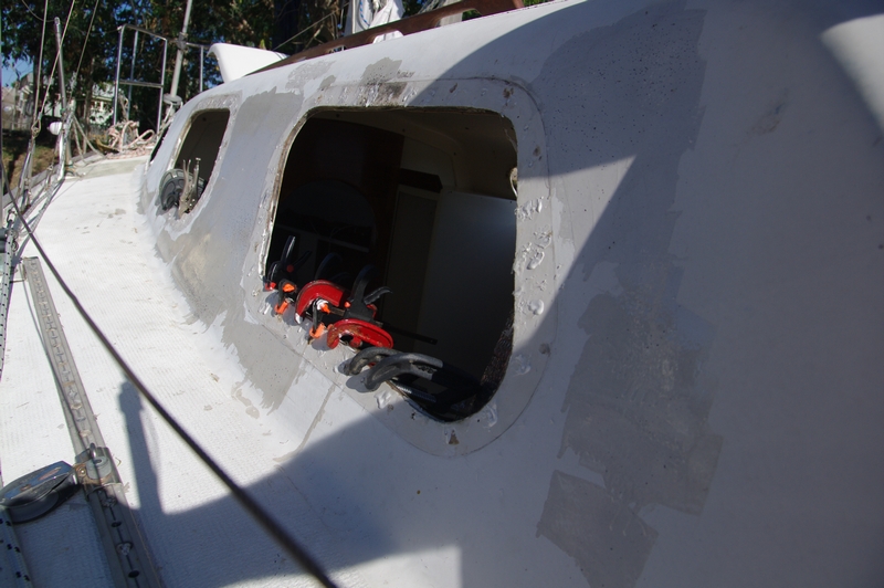

I was surprised when I eventually discovered that the middle layer in the window-cutout is old perspex. Somehow, the original windows were set in-between the inner lining and outer shell, held in place with some small screws on the inside. When the windows needed replacing, they were simply cut out leaving the edges still between the layers. The screws inside were simply painted over.
Epoxied the layers together. Filled the screw holes with epoxy and filler powder. Some of the surrounds of the windows were pitted. Using epoxy and a paint scraper with flexible blade which I used as a squeegee, I squeezed epoxy across the surface and forced epoxy into the holes.

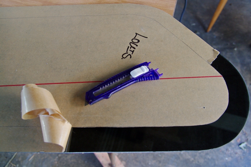

With the boat almost ready for the windows, I worked on preparing the cut acrylic sections. The system I am using is a no-screws approach similar to this article http://www.thecoastalpassage.com/windows.html. However, I am using different products as I found the products in the article difficult to economically procure and was not sure about some of the process.

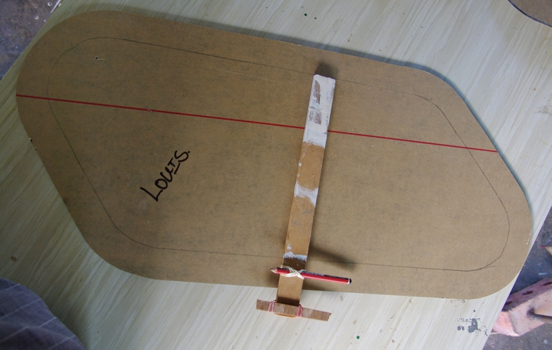

Set a pencil on a piece of wood the exact distance the windows overlapped the boat. Ran a line around the window.
window 01.jpg (326.46 KiB) Viewed 9763 times
With very little pressure, marked the paper along the line and pulled it off.
window 02.jpg (342.82 KiB) Viewed 9763 times

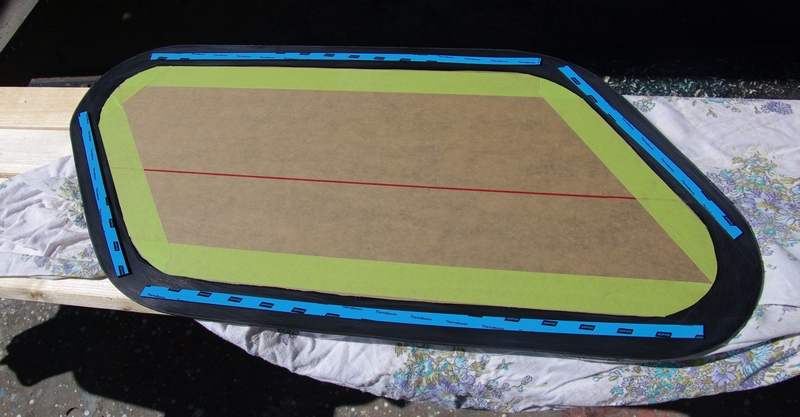

Sanded the exposed section using 180 grit until it was evenly abraded. Wiped with metho and a clean cloth. Surface was now a uniform dull black. I added masking tape around the edges and cut to shape.
At the boat, I stuck onto the windows a specialist two-sided tape. It is not only super sticky but is used with silicon sealant/adhesives for windows and comes in various thicknesses. Got it from tapesonline.com.au http://www.tapesonline.com.au/double-sided-tapes/black-structural-tape-3-2mm-thickness.html
I got 3.2 mm as that is the thickness of sealant recommended for acrylic windows of the size on Windchaser. Was not sure how much tape to use but wanted enough to hold securely in place for the days it takes the sealant to cure.

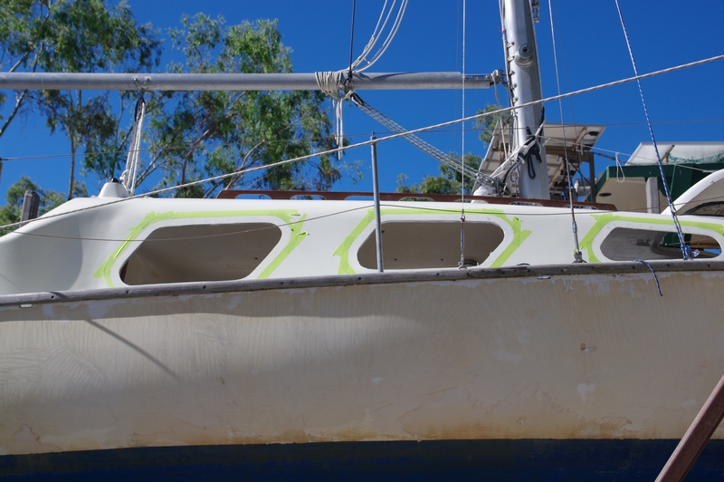

Masking up the boat is very important. I did not realise just how black and sticky the sealant was and proper masking is critical to stop it getting where it shouldn't.
On the boat, using my pencil-on-stick, I made some guide marks on the window surrounds, taped it up, used the pencil to mark the lines and then trimmed the tape. Sanded the exposed section to make for strong holding by the sealant.
window 04.jpg (366.73 KiB) Viewed 9763 times
I made a mistake as it would have been better to have added maybe 5 mm to the measure so there was space between where the window touched the boat and the tape. As it was, the window sat against the boat inside the space marked by the masking tape but it was snug. This meant when I was actually placing the window on the boat, it was not perfect to the mm which meant some of the masking tape was under the window a little bit.
Using Fixtech Fixsil FS 200 http://www.nauticexpo.com/prod/fixtech-marine-solutions/silicone-adhesive-uv-resistant-37358-284106.html I followed the directions. Squeezed a bead around the window and NOT over the double-sided tape. Using a paint scraper, spread the sealant in a thin layer over the acrylic sheet. Then put higher beads all the way around. Carefully took the paper off the double-sided tape and even more carefully placed the window in position. In fact, before putting any sealant on the window or activating the double-sided tape, I practiced placing the window where it should go.
The window immediately and solidly stuck in place. I then squeezed sealant around the window to fill up the remaining gap. I had disposable gloves on, used my finger to smooth the sealant. Immediately pulled off the masking tape leaving a nice edge.
