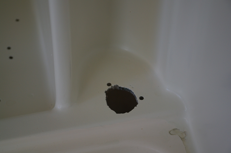

The old Trojan pump needed replacing so I decided to go for an electric water pump. However, the hole where the old pump went was a bit mangled.

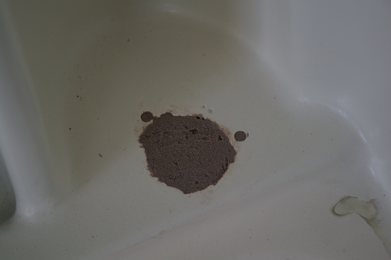

After using masking tape and a bit of wood underneath, I put some epoxy mix into the hole.
Another layer of smooth stuff.

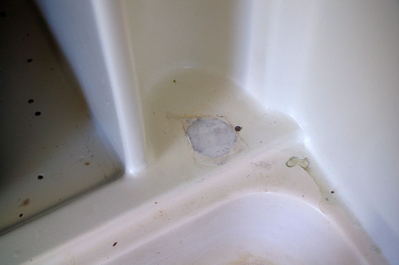

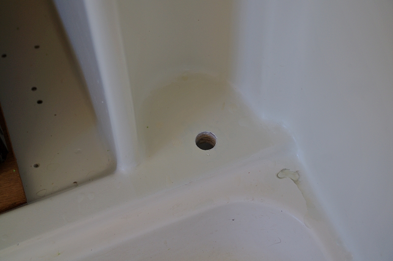

Painted, then carefully drilled out the right size hole.
Tap connected and working fine. Now I can move onto the other zillion jobs needing doing.
