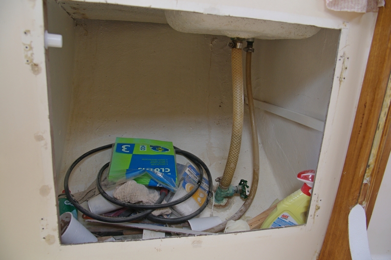

What's your thoughts? The drain on my sink goes through the hull under the water. However, I was in a different type of boat and the drain was above the water line. I guess the benefit of the under-water exit is that when I dump a bucket of muddy cleaning water down the sink it does not shoot out above the waterline and onto any boat broker who may have just pulled in with his dinghy beside the boat I was cleaning [It happened!]. Then again, I am not sure if that is a disadvantage . . . .
So, is it beneficial to have the sink outlet above the water line? I think it may be because if the darn tap or hose ever breaks then not likely to have a little fountain that could sink the boat. And, in my under-sink cupboard, if the hose went up higher then access for using the space would be significantly improved. On the downside, a hose with a bend to go out higher might clog up more.
Whatcha reckon?
