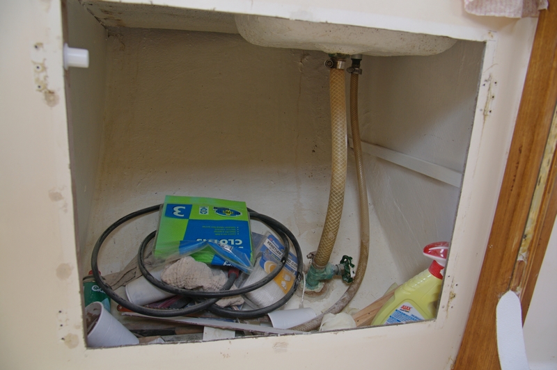

What's your thoughts? The drain on my sink goes through the hull under the water. However, I was in a different type of boat and the drain was above the water line. I guess the benefit of the under-water exit is that when I dump a bucket of muddy cleaning water down the sink it does not shoot out above the waterline and onto any boat broker who may have just pulled in with his dinghy beside the boat I was cleaning [It happened!]. Then again, I am not sure if that is a disadvantage . . . .
So, is it beneficial to have the sink outlet above the water line? I think it may be because if the darn tap or hose ever breaks then not likely to have a little fountain that could sink the boat. And, in my under-sink cupboard, if the hose went up higher then access for using the space would be significantly improved. On the downside, a hose with a bend to go out higher might clog up more.
Whatcha reckon?

Oberons is above/just on the water line and has a valve, it would give you more space, maybe a larger diameter pipe and thru fitting would be the go if you are worried about it clogging up

Strange to have a gate valve rather than a simple ball valve seacock. The through hull will be underwater anyway when you are healed over, probably better just to make sure your through hull and seacock are in good condition rather than going to the trouble of putting another hole in the boat.

Hi Mark , that is the correct set up you have . the gate valve is the old way ? Some shipwrights like ball valves over gate, believing them to be safer . Egret II has all her skin fittings with gate valves and are in good working condition .Even at 40 years of age

At the very least I am gunna change the valve. I am nervous with this valve as when I turn it I wonder if it will break off in my hands. Be nice to peek under the sink and easily see if on or off.
