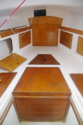

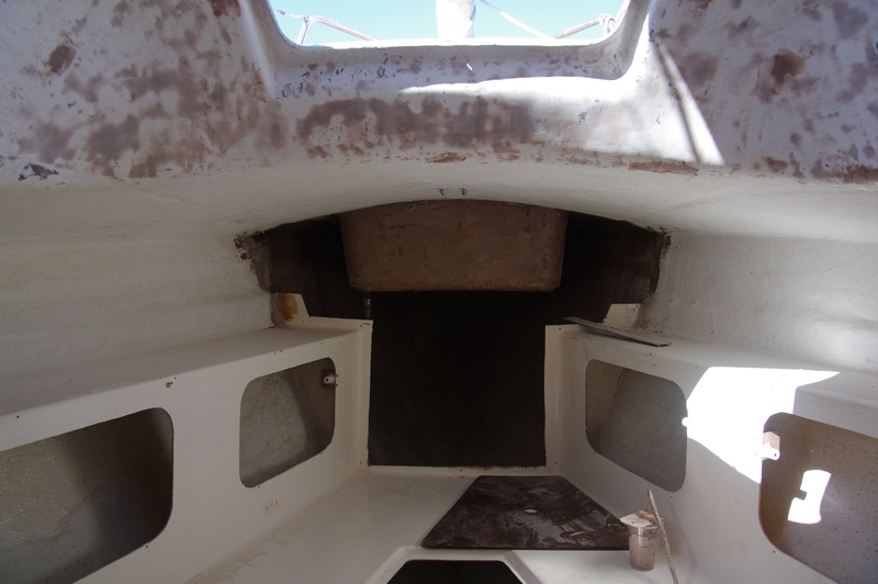

The v-berth was where I started renovating about, um . . ., 2 years ago : (. Problems included: deteriorating ply, storage doors roughly built, some storage doors with sticky gum to keep them closed and others using door holders, ceiling very lumpy, bow end section water damaged and needing replacing, cracks, needing paint, windows crazed, wooden reinforcing under stay bolts not painted at all, leaks from rain, doorway wood not varnished, missing floor cover.
Old v-berth
vberth 02.jpg (179.39 KiB) Viewed 10189 times
vberth 03.jpg (333.7 KiB) Viewed 10189 times

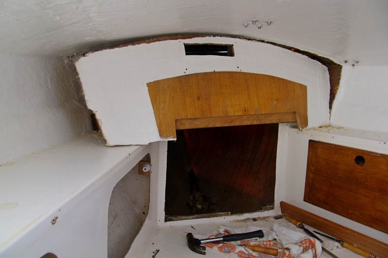

The end section came out. Notice the vent hole? There was an accompanying vent hole in the anchor-chain locker but I was concerned if I got water over the front it would just pour in.
vberth 04.jpg (330.95 KiB) Viewed 10189 times
All the wood came out, see the pic for some of the problems. Varnish and excess glue was sanded back, edges re-routed to make straight, ply re-glued where delaminating, re-varnished and ply was painted in epoxy then two-pack paint.

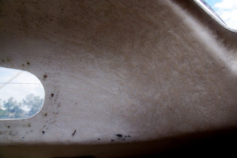

Roof was very bumpy. After sanding forever by hand, I got a small generator which was fantastic.
Roof still showing bumpy surface even after much hand sanding.
vberth 06.jpg (314.01 KiB) Viewed 10189 times

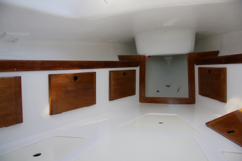

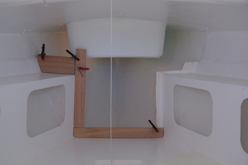

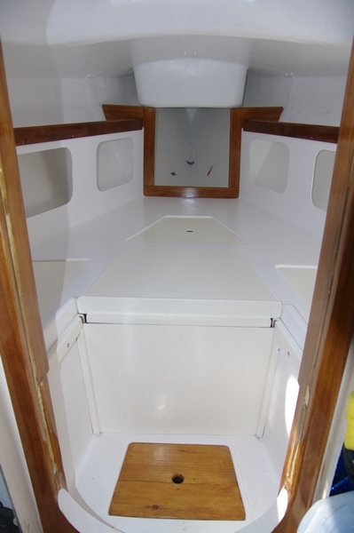

The colour scheme is a little different to what it was. A satin white with light sand plywood covers on storage but with same Monocel stain & varnish as previous but more coats. The whole bow storage area is white (sanding and painting it was a nightmare) and the anchor well has had the vent sealed. The bits of purple in the bow area is masking tape as I put it there and was measuring and marking for installing a shelf there.
Progress is being made.
vberth 09.jpg (234.83 KiB) Viewed 10188 times
vberth 10.jpg (191.78 KiB) Viewed 10188 times

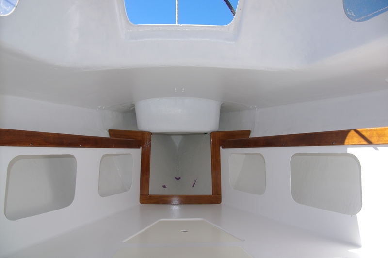

Doors have been reinstalled, using stainless hinges as the old ones were rusting, and cutting the screws short so they don't poke into the storage areas and rip holes in stuff including fingers like the old ones used to. Double magnetic clips hold them closed but I don't know how good they will be. The white block on the left of the pic on the ceiling used to be just ugly old bare ply.
vberth 11.jpg (263.64 KiB) Viewed 10188 times
I still have not replaced the windows and I am not as happy as I could be with the finish on my varnishing and with some of the paint. However, it is much more serviceable than it was and the prep work was sound. Oh, the ceiling is not as smooth as I wanted, the topcoat showed more lumps than I realised were still there. The cushions are now back in, washed clean and smelling fresh. Just hoping I get a chance to actually use it.

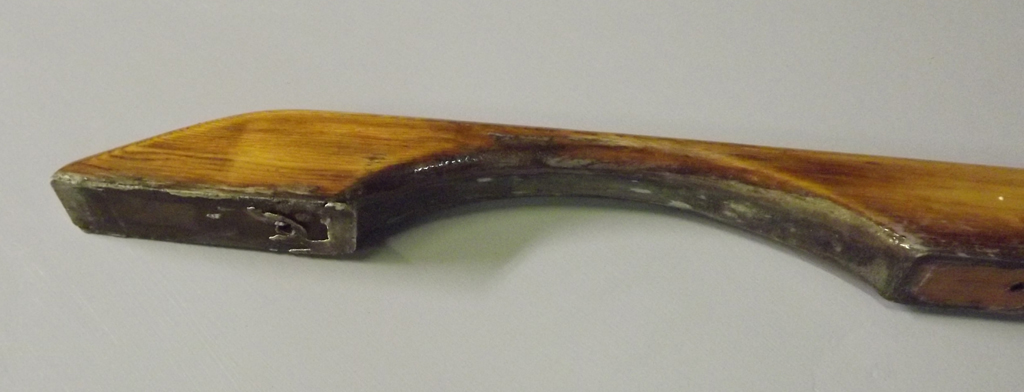

This is what I found under my cabin deck handrails.
Seems there was very little stopping the water coming in.
When I refit them, presently have them home for stripping and painting, I will place a washer on the fixing screw
so that I at least leave a little bit of silaflex under the handrail for a seal!

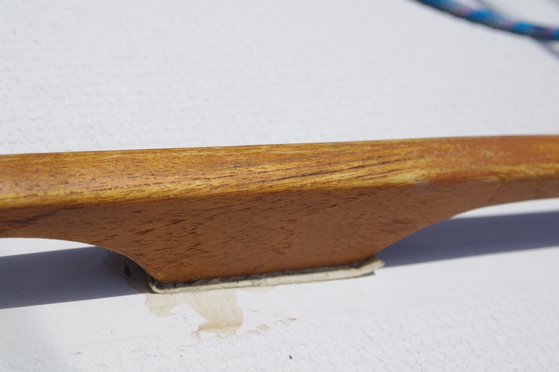

When I redid my handrails and various other deck fittings, I used that butyl mastic stuff [have done posts on this previously]. I used an Australian white butyl ribbon used for holding plastic dam liners together. It's been working well. However, I have just bought a box of the USA butyl mastic that is often talked about in forums. Haven't had time to check it out yet. Here's the link that tells about using the tape for sealing deck hardware. Not all tapes are the same. Some don't stick or 'flow' well enough for marine use.
http://www.pbase.com/mainecruising/rebedding_hardware
In the pic of my handrail, you can see how the butyl mastic tape has squeezed out a bit under the rail. The beauty of the tape is that it never sets. If the seal is broken then it will rejoin itself when pushed back together. It will re-seal. The bad thing is that since it never sets, the bit that squeezes out can collect all the dust and dirt. However, the excess can be rolled off or trimmed off but it might squeeze out a little bit for a month after installing.
s rail.jpg (272.32 KiB) Viewed 10032 times
