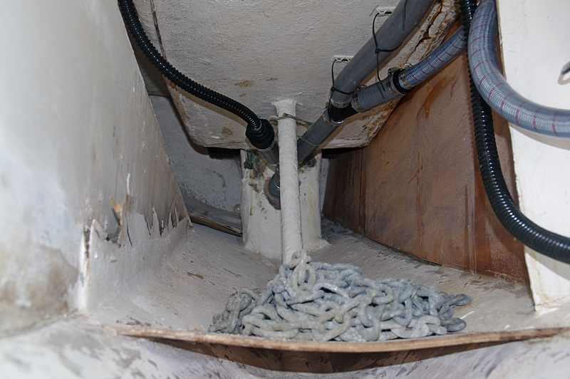

Heaps of pipes under the cockpit floor.
s repair 571.jpg (375.12 KiB) Viewed 7560 times
Notice the jaggard board on the left? For some reason, a PO fibreglassed in some ply going from the floor up to the top, which is the cockpit floor. Perhaps this was to stop objects on the starboard quarter-berth from ending up down in this section. Pity it was made from non-waterproof ply. It was coming apart so I removed it to gain access from the quarter-berth with fitting the pipes. Still need to trim it clean.
In the outboard well, I removed the old through-skin fitting and installed a larger one with a non-return valve. On the left side, the thinner black pipe goes up into a loop and then back down to my new electric bilge pump. The loop is to stop any water which enters the main pipe from various directions ending up in the bilge. On the right are two pipes (and descending electric bilge pump pipe) one going to the cockpit drain hole and the other to the manual bilge pump. The manual bilge pump has a non return valve so hopefully water won't work its way from the cockpit floor or where ever and down into the bilge.
When I brought Windchaser up from the Gold Coast, twice I had water fill the bilge from sharp wind-against-tide waves against the stern pushing water through the outlet hole and down the manual bilge pump hose. Now with the two non-return valves on the manual pump hose that should be stopped. May be a problem if the valves jam open but better than the way it was.

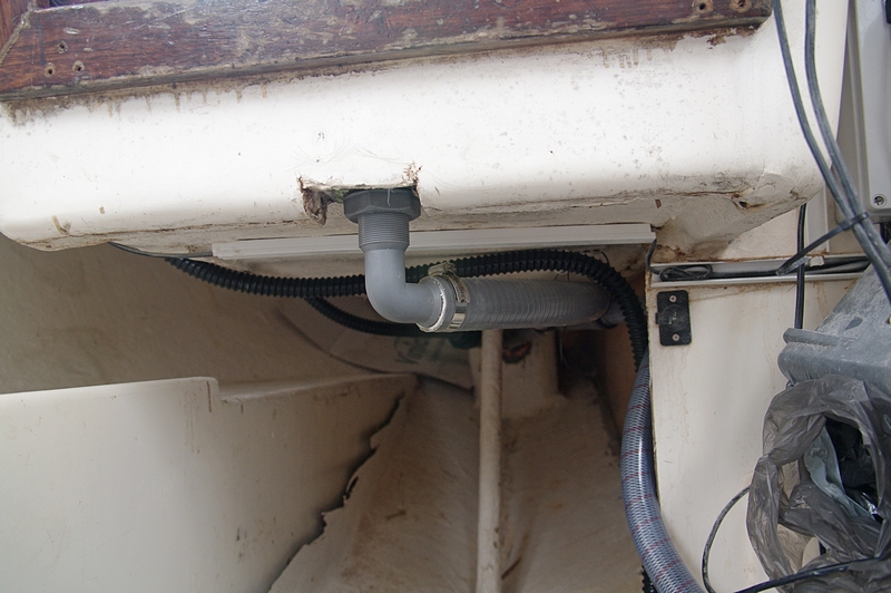

Elbow replacing the old fitting.
s repair 573.jpg (351.58 KiB) Viewed 7560 times
The elbow I put in to replace the mystery cockpit drain fitting was a tad thinner than the old fitting so I epoxied the hole closed and re-cut a smaller hole.
I still need to finish the job (properly secure the piping in place, trim the broken ply etc) but at least now the cockpit won't overflow into the cabin and the electric bilge pump is able to run (wiring is still temp) and sea water is not likely to make its way into the bilge via the bilge pipes.

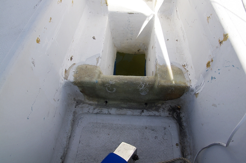

Hey Miker, can you please post a pic of your outboard mount as I think it is different to mine? Here's a pic of mine from when I bought Windchaser and before I sanded, shaped and painted the epoxy:
s repair 520.jpg (335.09 KiB) Viewed 7507 times
You can see the pencil-thin drains that just were not working very well at all. That was ALL that was draining my cockpit! When the little holes were blocked, the water would build up and overflow into the cabin.

Troppo wrote:Hey Miker, can you please post a pic of your outboard mount as I think it is different to mine? Here's a pic of mine from when I bought Windchaser and before I sanded, shaped and painted the epoxy:
Sorry Troppo, I don't have one, and can't get out there before my OS trip, but the boys who have posted have similar to me. A piece of timber about 1/2 inch above the floor of the cockpit. Yours looks pretty much hand built and whilst strong, obviously doesnt drain well.
If it was me, I'd drill those holes out to about an inch, then epoxy some bronze or stainless tubes in there. Still be nice and cosy for the spideys, but would drain better.
Re: Cockpit drain and bilge pump plumbing reno
Postby Troppo » Mon May 06, 2013 8:21 pm
Ok, so that's why cockpit would not drain properly - no gap under the outboard motor mount. What were people thinking when they glassed that in? The through-skin fitting in the front of the cockpit used as a drain sits in a saucer shape which was formed in the fibreglass when the cockpit was made so that seems odd. I think as Miker suggested, making those rear pencil-sized holes bigger would be a good way to go.
