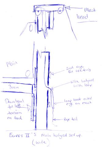

Postby bearmcnally » Sun Mar 31, 2013 10:53 am
Hi Bruce
Replacing a halyard is simple ,you tie a mouse to the existing halyard and pull it through you might have to cut the swag thimble off to get it out of the outlet box and the top of the mast . You could make the new one yourself or take it to a sailmaker /rigger and have him make it up and then you just swag the end . Especially if it is a wire to rope splice.
Be careful of changing to rope only as the pulley on the mast head will be worn and will chew the spectra rope that could be one of the reasons the wire is breaking.
If you do it yourself make sure you tie knots in the mouse cord and tape on tight to the halyard so it doesn't pull out inside the mast. Very embarrassing !
Bear

Postby Bruce » Sun Mar 31, 2013 6:45 pm
Thanks everyone.
Great advice is always nearby on this website. Always like your sketches Bear :D
