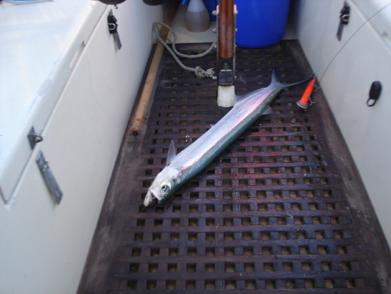

I have a teak one that is 40 years old. Still going well but some of the nails work up out of the grate from time to time. Not a problem. I re-oil it about twice a year.
As an item of importance on Seaka I rate it very high as it gives a high level of safety, I have never slipped on it, and I recieve much envy from other Top Hat owners.
:D :D
I have made only one change to the grate, I enlarged the openings over the Cockpit drains.
:D :D
That's a Wolf Herring at Hunter Island, QLD.
Middle Is Percy 031.jpg (174.32 KiB) Viewed 3268 times
