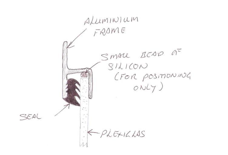

Postby Tales » Thu May 31, 2012 1:35 pm
Hi Greg,
Sorry not to get back to you sooner.
My seal came from Aquarian 03 94695811 (Paul) who made up my new windows.
I don't think it would suit your frame though - see pic - it's made for the aluminium section I now have.
There are ribs which engage with the frame to stop it coming out and 4 fins to seal against the plexiglass.
The silicone is only there for positioning the plexiglass in the frame and not to seal.
The plexiglass needs to slide because it grows and shrinks quite a lot.
If you do the sums for a MkIII it's about 4mm (from 0 to 40 degrees) while the fibreglass will only grow about 0.5mm.
Guess you could halve it by gluing it on a 20 degree day!

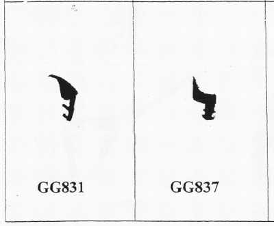

I bought some rubber sections that look as though they might work. I bought the sections from Grippy Rubber at Silverwater in Sydney. They have a catalog online in PDF format and they do mail stuff out so if you need sections they have a very comprehensive range. I've found that the "rubber" is actually some kind of plastic. :oops:
Unfortunately I can't get to the boat for a few days because it is too wet to take the plastic covering off the portlights. Well, I can take it off but I can't make it restick and with heavy rain and strong winds predicted its best to leave it alone.
The sections I got to have a try are below;
Rubber Glazing Wedge sections.jpg (6.14 KiB) Viewed 7193 times

Postby Dolphin » Fri Jun 08, 2012 7:48 pm
Well success.
Rubber section GG831 shown above was the one I eventually used. I got it from Grippy Ruber at Silverwater at a reasonable cost of $4.25 (Approx) per metre. It fits in snugly. They do mail order and you'll need about 4m per not window. I had about 800mm left over from one window.
I searched around some of the window places in Newcastle and went to Silverwater but the best section I found was the one from Grippy rubber.
I filled the gap between the window and the frame on the outside to make it fair and waterproof and so that the section will stick in there. If you put too much sikaflex in the groove you will not get the rubber in.
Like Tom (Tales ) pointed out, work the rubber back into itself, if you stretch it it will pull out of the corners. Also as Tom suggested I left the rubber 20mm longer, pushed it back and matched up the ends and Sikaflexed the ends together.
I didn't put masking tape on the outside on the Plexiglass and the frame and made a bit of a mess, but it cleaned up ok. I wiped as much off as I could with paper and rags. After it skinned I wiped it up with a rag moistened with Metho.
