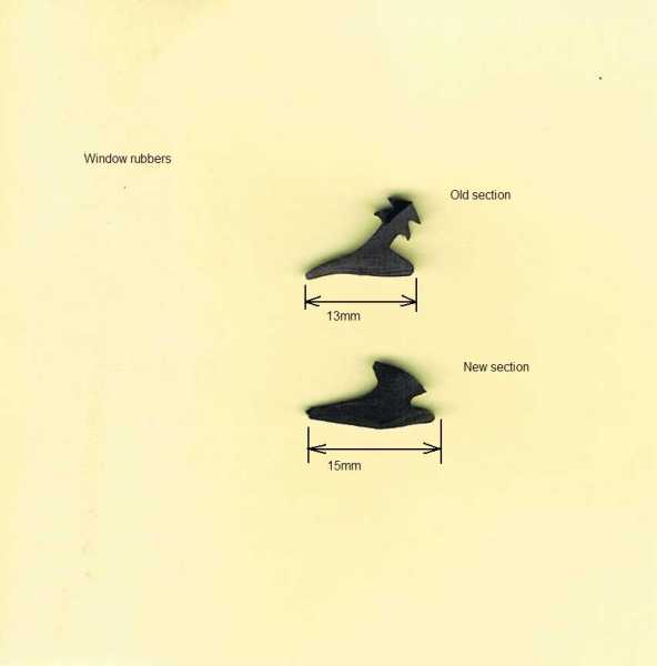

Tom where did you get your rubber from? Have you got any details.
Rubber section old n new.jpg (7.7 KiB) Viewed 6928 times

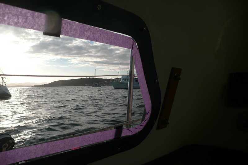

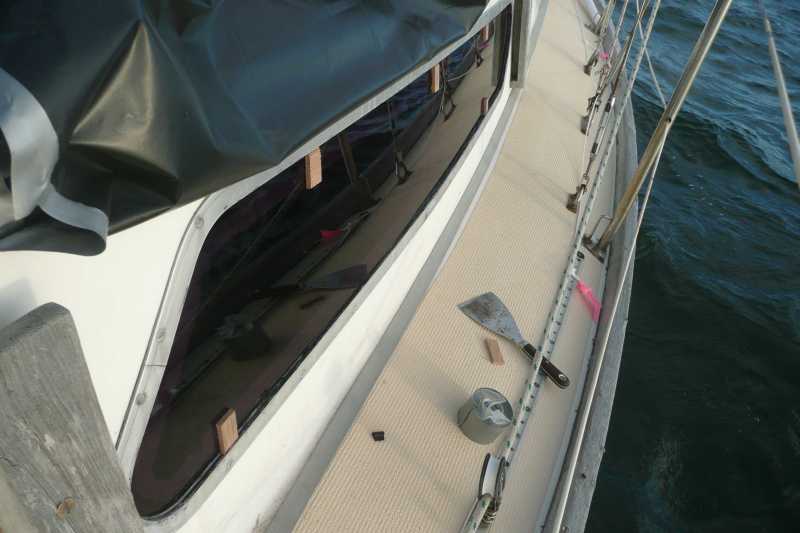

A couple of photos from yesterday. The wedges were made from 6mm ply with a taper on the narrow end to just hold the plexiglass in place before installing the "Rubber Glazing Wedge" as I found is the correct term for the rubber.
The plastic held in place with wedges, note the curve on the cabin.
Yes, you can actually see through it!
