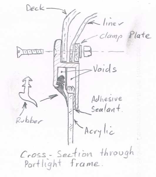

Here is the cross section detail of the Port light frame
Port light cross section.jpg (17.71 KiB) Viewed 8195 times
Re: Port Lights (Not windows)
Postby Shaun » Wed May 23, 2012 9:30 pm
imho the frame is the weak point, too many iffy joints, Greg I dont know if you can remember the "portlight" set up on Blue Moon, I am very happy with it....no leaks & looks very strong.
10mm (dont know what material but its tinted) & no sealant...just neoprene strips(2 narrow ones between cabin & the acrylic(?))
Postby Dolphin » Wed May 23, 2012 10:54 pm
Shaun,
I'm having second thoughts about continuing. Now I've got the material I'll use it and see how it goes. I think in the long run I might just take the frame out, use the outer dimension of the frame and use 10mm then just use the clamp plate on the inside You then only have one sealing face. I can also get rid of the storm boards which look a bit Heath Robinson.
I don't think I have the time to do it that way now. I'll just press on.
I don't remember Blue Moons set up, getting old I guess, what was your name again??? :lol:
The existing way has worked for a long time.

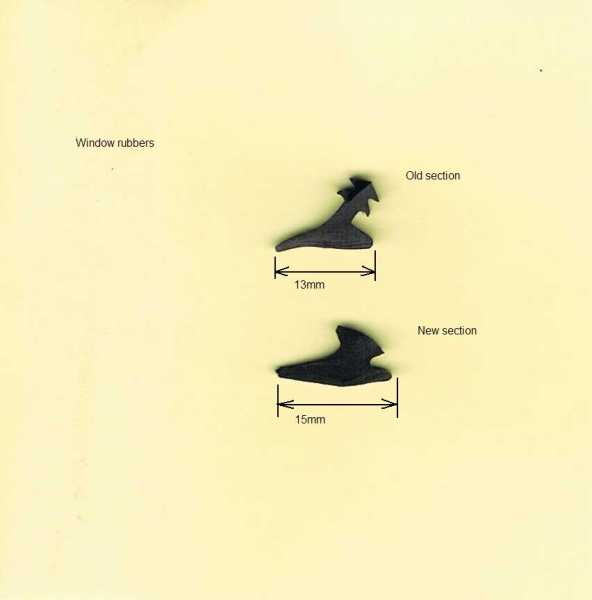

I picked up the replacement window rubber from Clark Rubber.
Its close, but in fact it may even fit better.
