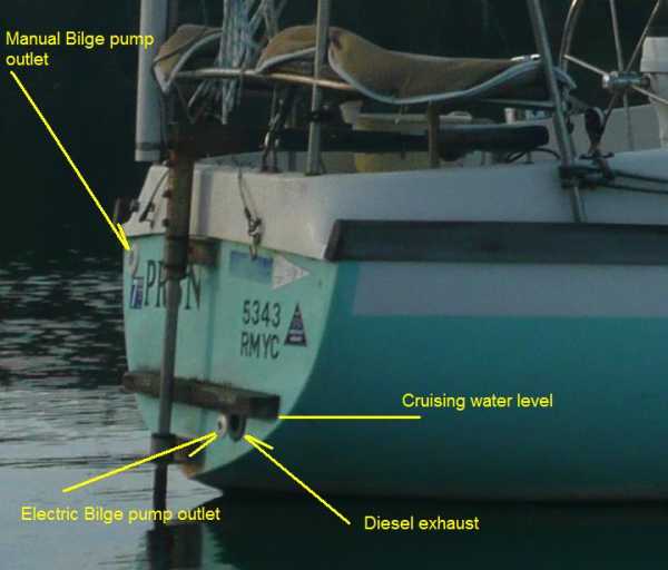

Postby Dolphin » Sun May 20, 2012 10:24 am
I Hope this helps.
Outlets at the stern of a MK3
P1020837b stern.JPG (22.26 KiB) Viewed 4434 times

Postby Dolphin » Sun May 20, 2012 10:44 am
I agree. If I had the choice I would have put all the outlets above the cruising water line.
But, putting it lower down means the pump has a lower head and thus more flow.
When I'm cruising under power I can't see how much cooling water is being discharged by the diesel.
But, it means the exhaust is quieter and the exhaust is dispersed by the water.
