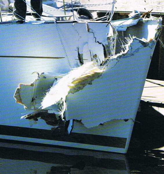

John, be careful adding big washers to the Pushpit or Pulpit. instead of just sheering off the bolts it might cause damage like that below.
Its like adding bull bars to Volvos with progressive crumple zones. :shock:
Image from Aust Sailng and Yachting Mar 2012.
What may happen with big washers
Bow damage a.jpg (42.51 KiB) Viewed 6624 times
