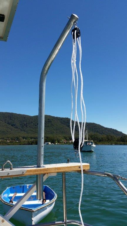

And as mentioned trying to remove some weight from the blunt end, would also compensate. Having said that I have been very happy with my Tohatsu 9.8hp 2st ultra long shaft, with the 4 blade 5inch pitch prop. very economical, & with this crane that I found the metal for it at the tip, It's very easy to lift the OB out over the back or into the dinghy, you still have to manoeuvre it around but not taking any of the weight is heaps better for the back.
