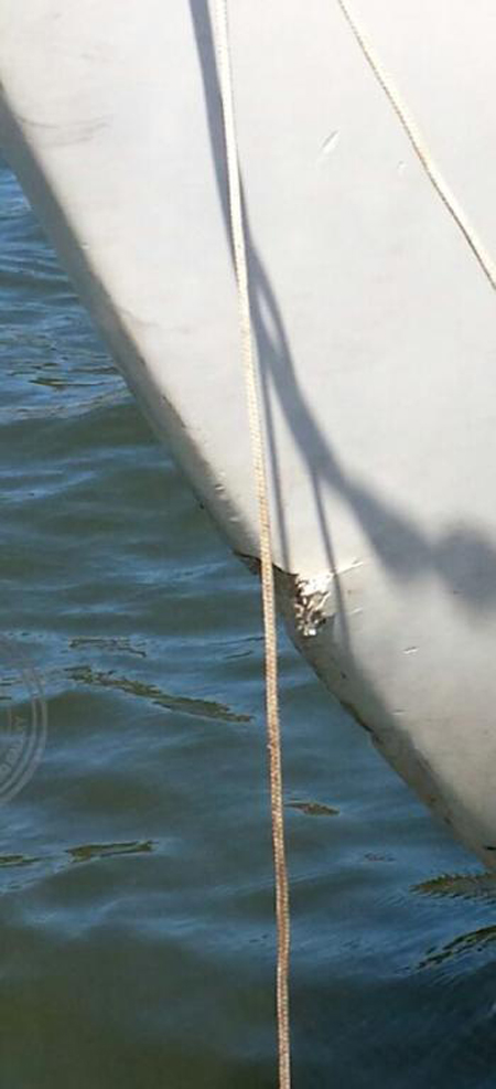

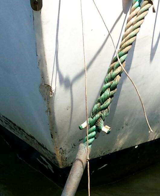

Postby Phillip » Mon Feb 10, 2014 10:07 pm
Dosen't look to bad from that angle Brad.

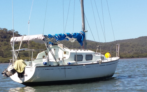

Brad's Mark 1. DESIRE
The Damaged Bow 1.
The Damaged Bow 2.
