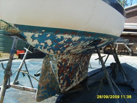

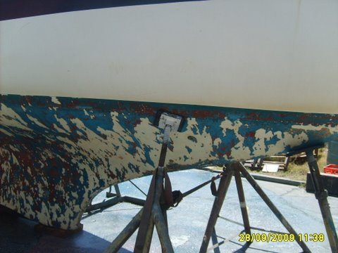

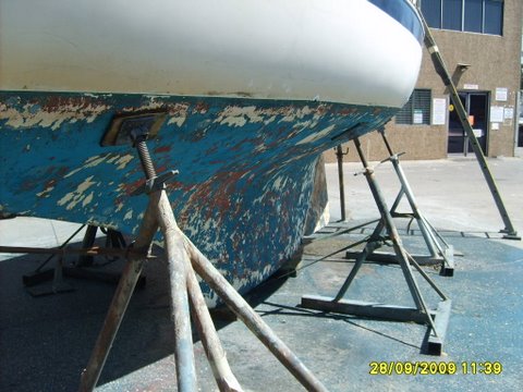

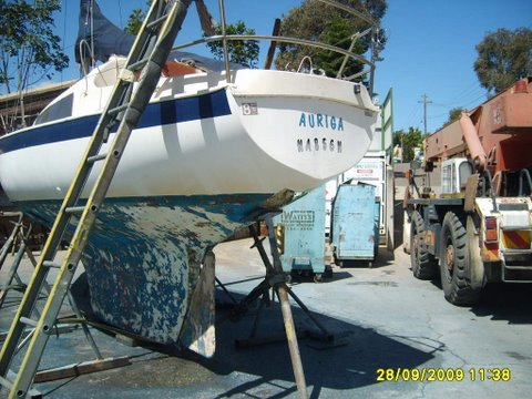

Had a look when she was pulled out, not a whole lot of growth (well none really) - couldve stayed in the water a while longer but oh well..
The antifoul is very thick 3mm - 4mm and thicker in some parts. As predicted by the shipwright it started to harden up / crack as it dried out. I took a scraper to the loose bits and got a bit off, they will be water blasting it today to get as much of the looser stuff off as possible before repainting and throwing back in tomorrow.
I have a few before shots but wont be able to get after shots as i'll be at work, will post them shortly.
Discovered 3 or 4 small osmosis blisters (5c coin size), but were only in the gelcoat and ran no deeper, they'll be fixed before repainting.
Now just waiting on the bill!

Postby auriga » Mon Sep 28, 2009 6:30 pm
Couple of pics of Auriga out of the water

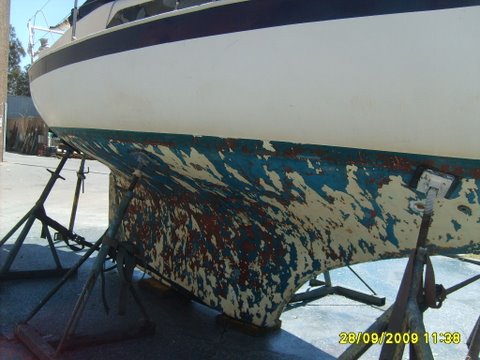

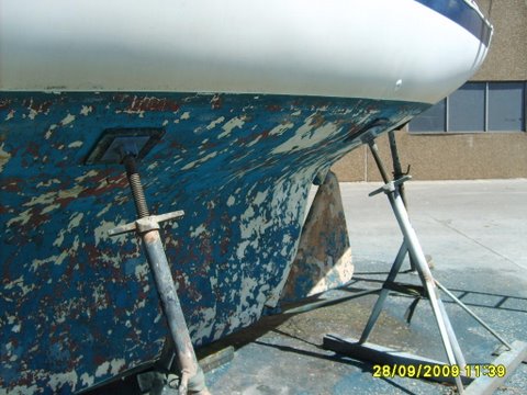

Postby auriga » Tue Sep 29, 2009 11:45 am
From what i understand from the previous shipwright she's been painted with altex #5 for quite some time, pics attached of the boat post water blasting.

Postby auriga » Tue Sep 29, 2009 11:46 am
more pics
