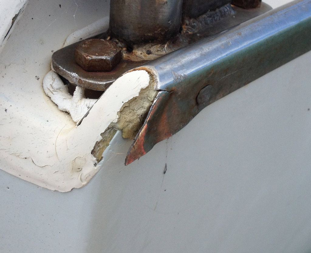

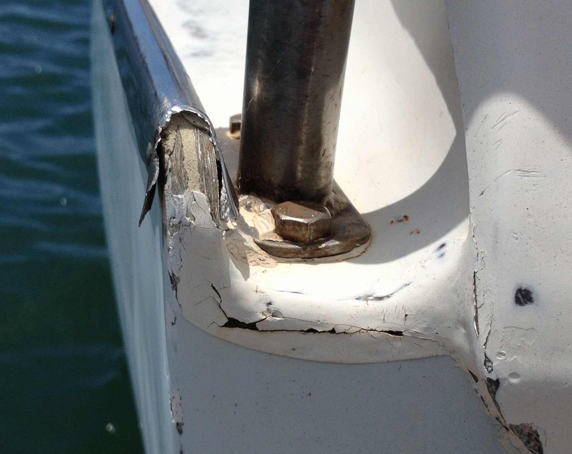

I have a problem with the finishing of the deck/hull join SS cover at the stern.
I would like to see how other Mk 1's have been finished.
At the moment both sides present as a probable area for injury.
Here are a couple of Photos to show what I mean.
Stern end of the cover strip, Port side.
Stern end of the cover strip, Starboard side.
Re: Cover strip to Deck & Hull, Mk1
Postby bearmcnally » Fri Feb 28, 2014 8:26 am
Yeah Phil , that looks like a typical genuine Mk 1 finish ? So what's your problem ? Egret II looks similar with teak gunwales . I filled the ends with epoxy and finished with gelcoat bog ,and that seems to work pretty well . I will take a happy shot on the weekend and post it.
You should be able to get some S/S end caps made to tidy that up ?

Is that a rivet in your gunwale s/s cover?
And is that a hole under the stanchion above the sealant? If it is a leak then I guess that is on ya 'to-do' list.
Postby Phillip » Thu Mar 13, 2014 11:56 am
Yes Louis thats a rivit, all Mark 1's have the SS cover strip rivited on.
That cover is what I'm looking for and I'm sure there must be one out there that's half the size.
Mind you I am now thinking that I could make one up using a bit of u-tube or at the worst get one folded/welded up.
The repairs to that join on both sides of the stern is on the repair list, but as it does not leak, it's last!! 8-)
The apparent hole under the stantion is actually the shaped clear plastic packing.
