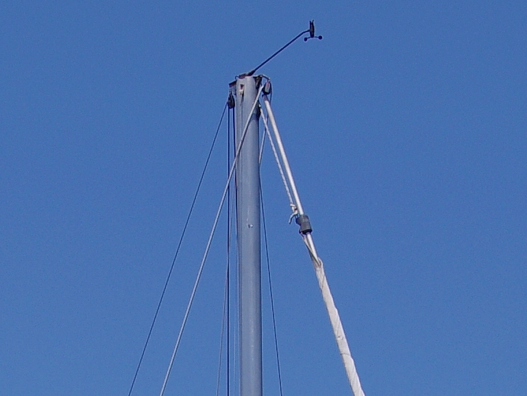

Windchaser has no topping lift. When I bought her, when not sailing the weight of the boom (and sail) was carried on the lazyjacks to the boom bag, which was starting to tear the boom bag. I started using the spinnaker sheet brought around to the back of the boom. Next time I slip her, I am thinking about dropping the mast to check it out, seal the bolt holes going through the cabin roof, see if windspeed meter is okay, remove a 'squirrel' rope that is jammed and put in a topping lift.
mast top.jpg (320.9 KiB) Viewed 5840 times
You can see in the pic the furler on the right and the white spinnaker sheet going around the mast towards the stern.
I don't know if there is a sheave at the top of the mast for the topping lift. Do you have any advice for me?

Thank you for that idea Tom. I have to go to the mast to raise the main so I could use the left hand diagram.
