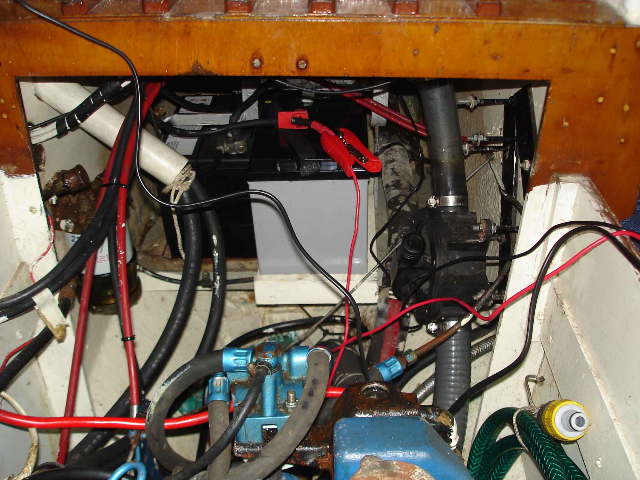

My batteries are mounted under the cockpit and to the rear of my inboard. They sit on a timber platform, which is fibreglassed in, and to which they are held down with the appropriate battery ties. There is just enough room to get them out.
The engine starting battery is a sealed Alco MF 90D26L and the house battery is a sealed Ritar AGM RA12-120SD. I think I have deciphered the battery codes correctly. As I have mentioned, I replaced these two batteries in Mooloolaba after 8 years of good service. They are trickle charged with a 20 watt solar panel, each battery having its own regulator [most important!]. I found that for casual use they were adequate and I have never lacked for battery power.
But, now that I am cruising and using them every day not all is well. The engine starter battery is fine and usually recharges within about 30 minutes after starting the engine. Today when I put the charger on it was already fully charged.
The house battery is another story and at this stage I have found that using a laptop computer will over a week, seriously discharge the battery. I have just purchased a 21amp smart charger, which today took 5 hours to bring the house battery back to full charge.
When I refitted Seaka I redid the wiring so there are no problems there. I also have only LED lighting and there is only the VHF radio and intermittently the FM/AM radio and the electric toilet with high demands. Over the next couple of weeks I will see if the battery can hold up without the use of the LAPTOP COMPUTER.
The other alternative, which I have yet to consider, is to get a small $300 petrol [with all the problems of getting and storing petrol] generator from Bunning’s and recharge the battery on a schedule to be determined. There is also the consideration of larger solar panels [$300 to $650] or a wind turbine [$900 to $1500]. Remember we always anchor out of the wind and when going downwind wind turbines do not work very well and they are bloody noisy.
What I really need to do is get an expert to do the consumption calculations and then match that with a suitable system of maintain a good charge. I suspect that my present setup cannot support the laptop computer.

Battery's in SEAKA
