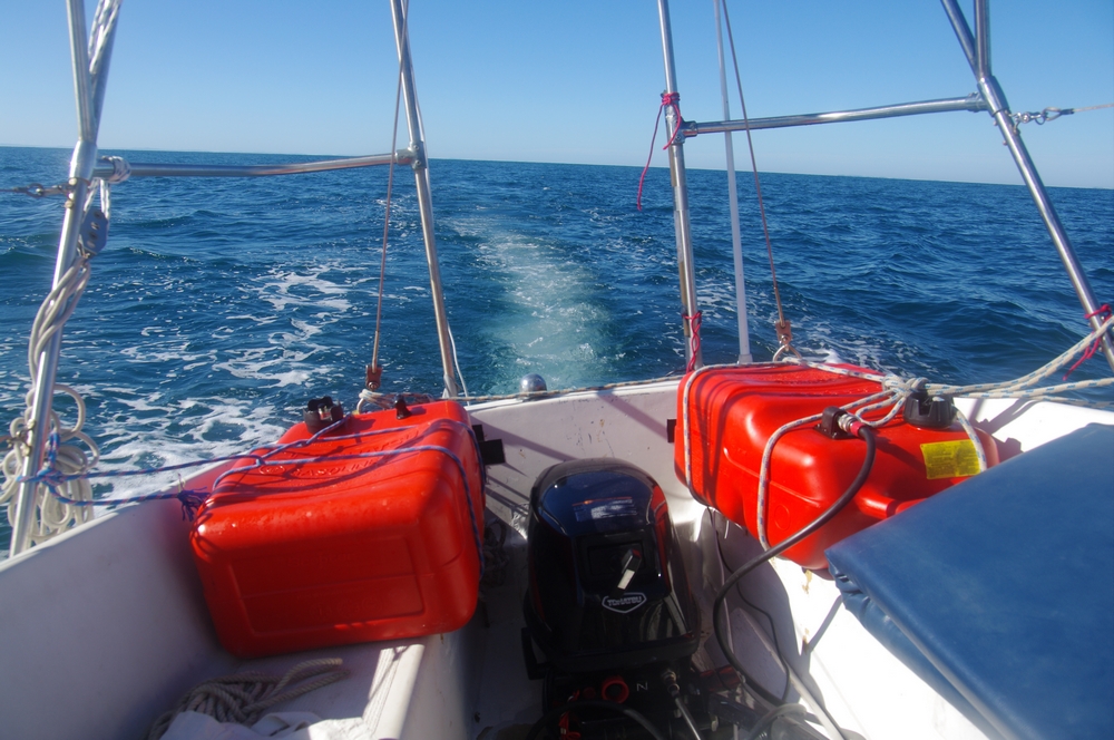

I tie down my fuel tank to the side. Even if the water seems calm when I am about to set out, I still throw some loops of rope about the tank (or both if using both) to make sure they can't go anywhere.
fuel tank 2.jpg (537.47 KiB) Viewed 8061 times

So, I was not happy with the possibility of sparks being created in a locker which carried so much fuel. The battery is now under the cockpit floor in the cabin with the solar regulator. I still carry fuel in the locker. Sometimes I carry fuel inside the cabin.
I ALWAYS use my nose to carefully check if any fumes in the cockpit locker. If any fumes at all, I find the reason and let the locker air out. The only time I have smelt some fumes is when I have forgotten to tighten the little breather caps or something. If I smell any fuel in the cabin, I check it out immediately. The containers I use are good ones and I don't smell fumes from them unless not done up properly. I personally don't think fumes will collect since the containers should not be leaking and if they do you should smell it pretty quick. Different matter if you have a built-in tank with tubing as a little leak somewhere may drip fuel which ends up in the bilge.
So far, I have not had any problems.
